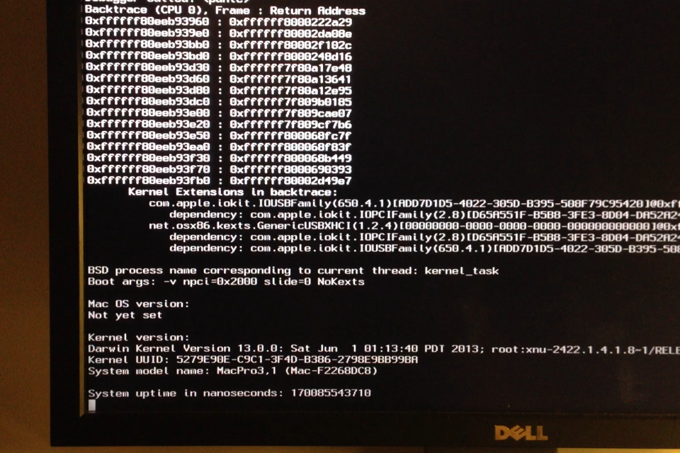

jarson Posted August 25, 2013 Share Posted August 25, 2013 I get stuck when installing Mavericks, and I have no access to real mac only Windows, so this is how i do it: 1. using Bootdisk Utility to make bootable pendrive with Clover 2. using Transmac, MacDrive and BDU - make second pendrive with content from BaseSystem.dmg + Packages folder + mach_kernel 3. I boot Clover, run second pendrive, kernel loads, and system restarts! Last visible screen - in attachment hardware: i7 4770K GA-Z87N-WIFI nvidia Quadro 600 2x4GB Corsair Vegance any ideas ? Link to comment https://www.insanelymac.com/forum/topic/291437-stuck-installing-mavericks-with-no-access-to-mac/ Share on other sites More sharing options...
artur_pt Posted August 25, 2013 Share Posted August 25, 2013 hello u have usb problems and the genericusb is giving kp.. remove it or see in bios other usb options.. if u have usb 2 try there good hack 1 Link to comment https://www.insanelymac.com/forum/topic/291437-stuck-installing-mavericks-with-no-access-to-mac/#findComment-1941126 Share on other sites More sharing options...
jarson Posted August 25, 2013 Author Share Posted August 25, 2013 I have installed GenericUSBXHCI_1.2.4_for_Mavericks and there is no KP now, but get message "Still waiting for root device" Deleting GenericUSBXHCI also i get message "Still waiting for root device" tried usb 2.0, but the same problem something wrong with the USB for sure... Link to comment https://www.insanelymac.com/forum/topic/291437-stuck-installing-mavericks-with-no-access-to-mac/#findComment-1941142 Share on other sites More sharing options...
