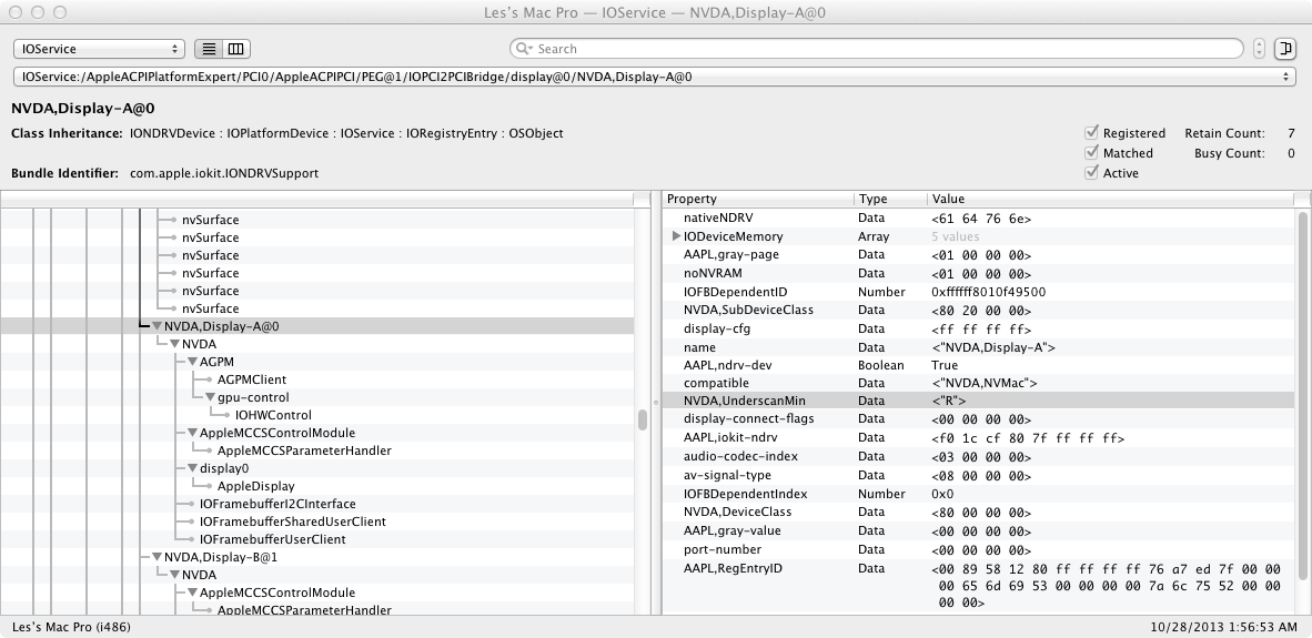

Sorry for the delay,
I make my own DSDT, I patch the usual thins + battery values for get battery with AppleSmartBattery/ACPIBatteryManager kext, HDMI and all sound devices working with my own mod AppleHDA, FnKeys (Backlightkeyboard and Fn multimedia keys) with EMlyDinSH kext from osxlattitude with this kext and injecting pwm-info for my Nvidia Card I get Brigthness working. So all works for me except the SDcard Reader.
I can give you all, for inject the correct info for Nvidia I use EFI String + DSDT its a lot of info check inside my org.chameleon.boot.plist.
List of files
Config
DSDT usual patches + Battery Patch + HDMI patch + some Fn Keys mods to get all working
SSDT for my 2670QM processor you may need other for your 2630QM
org.chameleon.Boot.plist with my own EFI string to inject my GTX 560M info for get Brightness working, also injects the EDID for my Screen.
Kexts
AppleHDA (mavericks 2.5.2 and ML 2.4.7) for get all sound devices working Internal speakers, headphones, internal and external mic
Rehabman´s VoodooPS2Controller 1.8.8 for keyboard and trackpad
Zenith432´s GenericUSBXHCI 1.2.6
Rehabman´s ACPIBatteryManager 1.4
EMlyDinEsH´s AsusNBFnKeys 1.7
EMlyDinEsH´s EAPDFix for audio after sleep
Issues remaining
USB EHCI eject after sleep
in Mavs backlightkeyboard doesn´t work anymore after sleep
SDCard Reader doesn´t work at all
Fermi Freeze without Dan´s freeze fix app (I´m working in lead to fix this)
I´m on Mavericks right now remember to use Mac mini 5,2 smbios and you need to inject your AGPM settings for this model or you will get black screen on boot
Good luck all G74SX users!!!

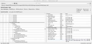

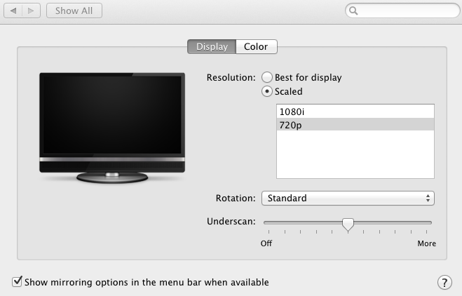

@ areos, i do believe i'm underscanning...
...i added device properties to cham..boot.plist...using only these values:
<!DOCTYPE plist PUBLIC "-//Apple//DTD PLIST 1.0//EN" "http://www.apple.com...yList-1.0.dtd">
<plist version="1.0">
<dict>
    <key>PciRoot(0x0)/Pci(0x1,0x0)/Pci(0x0,0x0)</key>
    <dict>
        <key>@0,AAPL,boot-display</key>
        <string></string>
        <key>@0,NVDA,UnderscanMin</key>
        <string>0x00000052</string>
        <key>@0,name</key>
        <string>NVDA,Display-A</string>
        <key>@1,NVDA,UnderscanMin</key>
        <key>@1,name</key>
        <string>NVDA,Display-B</string>
    </dict>
</dict>
</plist>
...converted it to hex with gfxutil, opened the resulting file in textedit and copy/pasted the result into device properties...rebooted once to a blank display...next boot...voila'!
...maybe not entirely correct, as i still use GE=Yes(Chameleon) as well...but it now appears in ioregistry and the slider works as advertised...i'd like to roll it into a dsdt injection for the entire video card(but this works fine) thanks! :smoke:

Great, I also tried to inject all this values inside my dsdt but for some reason if I inject this value in dsdt I always get Black screen (I think is related to the coding) this is why I use some values via EFI String and only the HDMI related ones via DSDT.
Good Luck
just for good measure...
:smoke:...as it stands now, i have to enter/type at chameleon boot prompt: "Device Properties"="No" to reach the login screen...so still a work in progress, but, it  does work.
