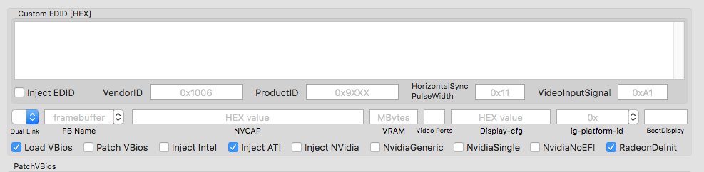

misterphoton Posted September 6, 2017 Share Posted September 6, 2017 I set load vbios to yes. Resulting in a black screen. thanks again, and if you need any other data, please let me know, Nick Sierra. Clover EUFI Bootloader. Link to comment https://www.insanelymac.com/forum/topic/291117-how-to-make-radeon-desktop-or-mobility-be-working-by-using-clover/page/17/#findComment-2490616 Share on other sites More sharing options...

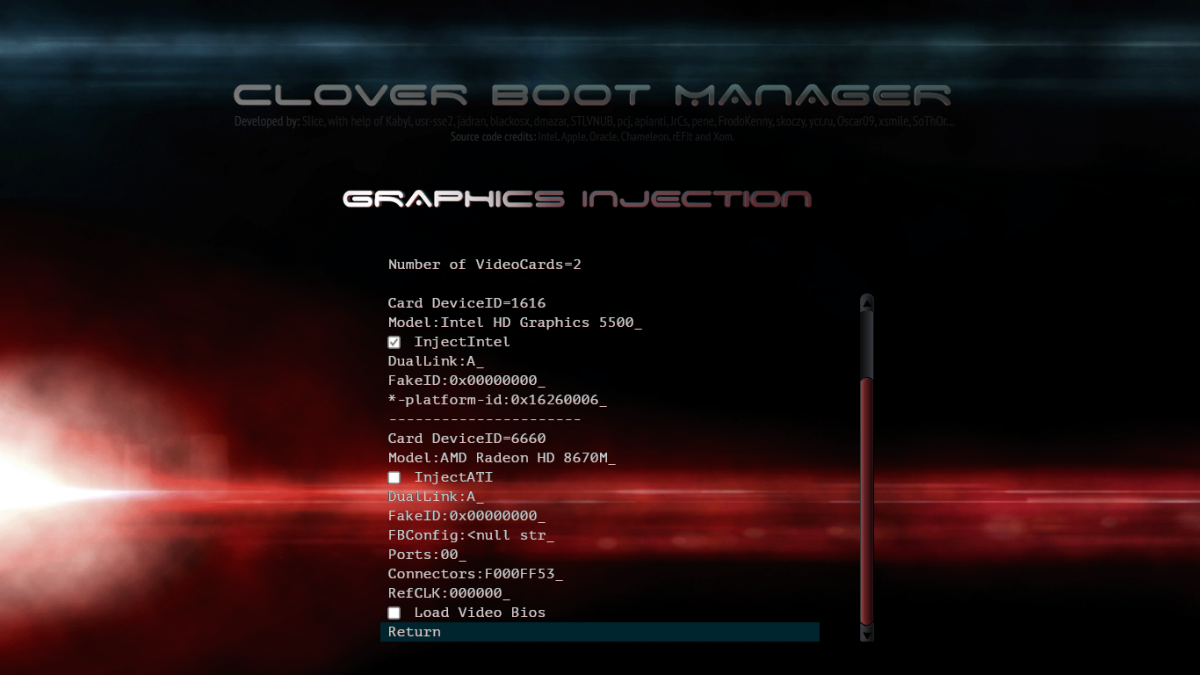

shaizu Posted September 9, 2017 Share Posted September 9, 2017 0:100 0:000 PCI (00|0D:00.00) : 1002 6660 class=038000 0:100 0:000 - GFX: Model=AMD Radeon HD 8670M (ATI/AMD) this shows in preboot.log and I've AMD Radeon R5 M330 2gb graphics card which doesn't show in system profiler even booting with inject ATI what should I do to get it work? Link to comment https://www.insanelymac.com/forum/topic/291117-how-to-make-radeon-desktop-or-mobility-be-working-by-using-clover/page/17/#findComment-2491858 Share on other sites More sharing options...

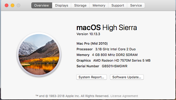

roadzy Posted March 26, 2018 Share Posted March 26, 2018 (edited) I'm trying to get this card working. It shows up as AMD Radeon HD 7570M Series 5 MB with no flags set. This is a desktop card and not a laptop. Edited March 26, 2018 by roadzy Link to comment https://www.insanelymac.com/forum/topic/291117-how-to-make-radeon-desktop-or-mobility-be-working-by-using-clover/page/17/#findComment-2605759 Share on other sites More sharing options...

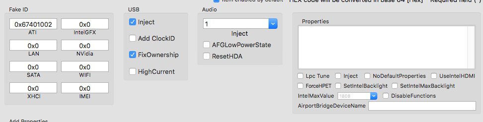

Slice Posted March 26, 2018 Author Share Posted March 26, 2018 Use FakeID=0x67401002 LoadVBios=YES Link to comment https://www.insanelymac.com/forum/topic/291117-how-to-make-radeon-desktop-or-mobility-be-working-by-using-clover/page/17/#findComment-2605768 Share on other sites More sharing options...
roadzy Posted March 26, 2018 Share Posted March 26, 2018 (edited) 6 hours ago, Slice said: Use FakeID=0x67401002 LoadVBios=YES No luck. Did I do something wrong? Edited March 26, 2018 by roadzy Link to comment https://www.insanelymac.com/forum/topic/291117-how-to-make-radeon-desktop-or-mobility-be-working-by-using-clover/page/17/#findComment-2605802 Share on other sites More sharing options...
Slice Posted March 27, 2018 Author Share Posted March 27, 2018 It's a pity Radeon cards Family NothernIsland will not work in High Sierra. You have to install Sierra or even ElCapitan. Another way is to replace some AMD kexts by Sierra version. Link to comment https://www.insanelymac.com/forum/topic/291117-how-to-make-radeon-desktop-or-mobility-be-working-by-using-clover/page/17/#findComment-2605875 Share on other sites More sharing options...
roadzy Posted March 27, 2018 Share Posted March 27, 2018 6 hours ago, Slice said: It's a pity Radeon cards Family NothernIsland will not work in High Sierra. You have to install Sierra or even ElCapitan. Another way is to replace some AMD kexts by Sierra version. So I have another hackintosh running Sierra. Are you saying to just grab the AMD kexts from it and load them in to High Sierra? And then once you overwrite these kexts, should I then do the fakeid mentioned above? Link to comment https://www.insanelymac.com/forum/topic/291117-how-to-make-radeon-desktop-or-mobility-be-working-by-using-clover/page/17/#findComment-2605916 Share on other sites More sharing options...
roadzy Posted March 28, 2018 Share Posted March 28, 2018 On 3/27/2018 at 3:59 AM, Slice said: It's a pity Radeon cards Family NothernIsland will not work in High Sierra. You have to install Sierra or even ElCapitan. Another way is to replace some AMD kexts by Sierra version. Went to my sierra hackintosh grabbed all the AMD files Under S/L/E and then used the kext util to load them, rebooted and set the fakeid and loadvbios. Still no luck. Link to comment https://www.insanelymac.com/forum/topic/291117-how-to-make-radeon-desktop-or-mobility-be-working-by-using-clover/page/17/#findComment-2606044 Share on other sites More sharing options...
roadzy Posted March 30, 2018 Share Posted March 30, 2018 On 3/27/2018 at 3:59 AM, Slice said: It's a pity Radeon cards Family NothernIsland will not work in High Sierra. You have to install Sierra or even ElCapitan. Another way is to replace some AMD kexts by Sierra version. Downloading Sierra now. I'm going to install that and see if it works. Still no luck no matter what I try with High Sierra. Link to comment https://www.insanelymac.com/forum/topic/291117-how-to-make-radeon-desktop-or-mobility-be-working-by-using-clover/page/17/#findComment-2606423 Share on other sites More sharing options...
roadzy Posted April 1, 2018 Share Posted April 1, 2018 (edited) On 3/27/2018 at 3:59 AM, Slice said: It's a pity Radeon cards Family NothernIsland will not work in High Sierra. You have to install Sierra or even ElCapitan. Another way is to replace some AMD kexts by Sierra version. hey @Slice I'm on Sierra.... still no luck any suggestions? Edited April 1, 2018 by roadzy Link to comment https://www.insanelymac.com/forum/topic/291117-how-to-make-radeon-desktop-or-mobility-be-working-by-using-clover/page/17/#findComment-2607087 Share on other sites More sharing options...

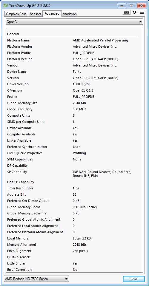

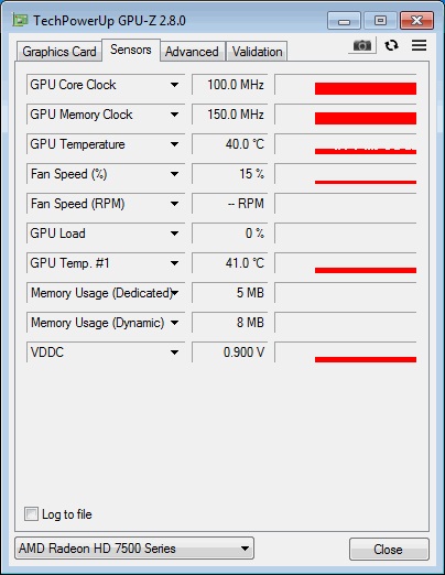

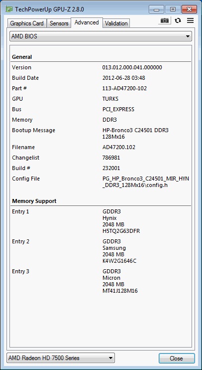

skyfly555 Posted June 22, 2018 Share Posted June 22, 2018 (edited) Hello. I wonder if some of you can help me to get my VBIOS extracted, to be able to patch the AMD framebuffers (the KextsToPatch Clover section). I've tried GPU-Z (Windows), DPCIManager(macOS) and using the PCI sysfs interface to dump the video bios rom (Ubuntu). It's an AMD Radeon HD 6770M, device id 1002:6740, from an HP Pavilion dv6-6196ss laptop (very similar to an MBP8,3). I'm using HS 10.13.4 I've tried a different approach, to get VBIOS from a Bios update package (called sp55068.exe) using Universal Extractor, Radeon Bios Editor and Phoenix-Insyde-EFI SLIC (Windows). The problem is that "Universal Extractor" reads only the first 64 KB and my VBIOS is 128KB long. I attach here the BIOS (bin file) that contains the VBIOS, the three VBIOS 64KB files I could get and some images showing the errors I'm facing: https://www116.zippyshare.com/v/SxYDuJL1/file.html Thank you very much. Edited June 23, 2018 by skyfly555 Link to comment https://www.insanelymac.com/forum/topic/291117-how-to-make-radeon-desktop-or-mobility-be-working-by-using-clover/page/17/#findComment-2621824 Share on other sites More sharing options...
Slice Posted July 13, 2018 Author Share Posted July 13, 2018 Radeon Mobility will not work if you have embbedded Intel graphics ON. Link to comment https://www.insanelymac.com/forum/topic/291117-how-to-make-radeon-desktop-or-mobility-be-working-by-using-clover/page/17/#findComment-2625669 Share on other sites More sharing options...
skyfly555 Posted July 16, 2018 Share Posted July 16, 2018 On 7/13/2018 at 1:41 PM, Slice said: Radeon Mobility will not work if you have embbedded Intel graphics ON. Thank you, vBIOS is integrated into the BIOS, so there’s no way to extract it and patch it. Thank you. I will leave it with the HD3000 on. Link to comment https://www.insanelymac.com/forum/topic/291117-how-to-make-radeon-desktop-or-mobility-be-working-by-using-clover/page/17/#findComment-2626131 Share on other sites More sharing options...
