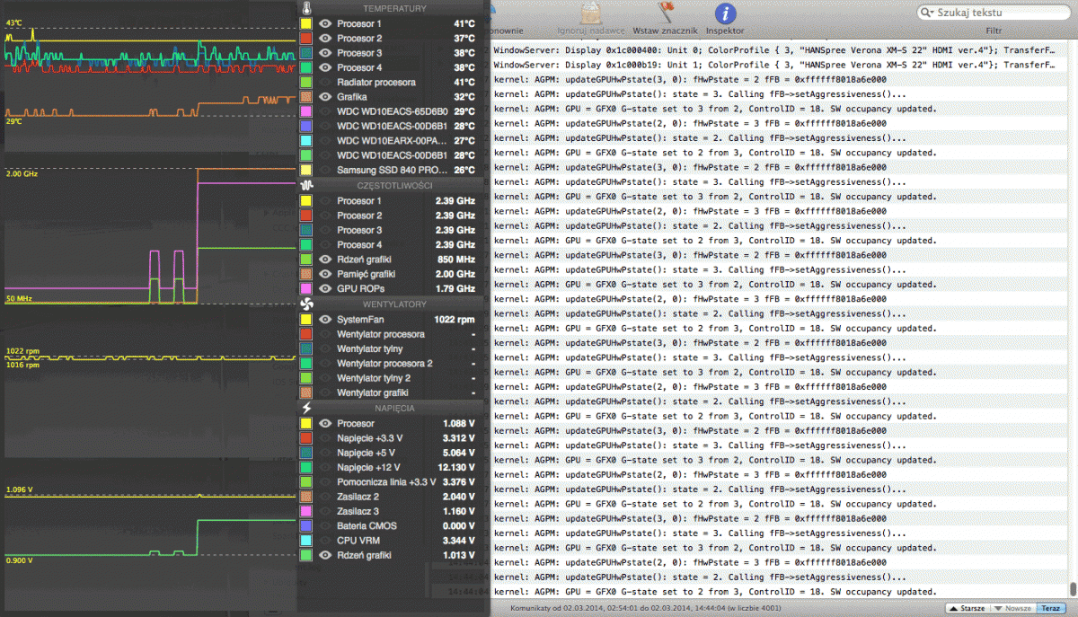

koliberK Posted March 2, 2014 Share Posted March 2, 2014 Hi there, I have the same issue, one monitor connected, and AGPM working perfectly. On dual monitors, GPU stuck at full speed in 3D. My GPU is EVGA GTX 570 on w/c, BIOS 70.10.49.00.74 Really scheme AGPM on dual monitor not working like it should. my AGPM kext: <key>iMac10,1</key> <dict> <key>Vendor10deDevice1081</key> <dict> <key>Heuristic</key> <dict> <key>ID</key> <integer>0</integer> <key>IdleInterval</key> <integer>250</integer> <key>SensorOption</key> <integer>1</integer> <key>SensorSampleRate</key> <integer>4</integer> <key>TargetCount</key> <integer>5</integer> <key>Threshold_High</key> <array> <integer>45</integer> <integer>80</integer> <integer>100</integer> </array> <key>Threshold_Low</key> <array> <integer>80</integer> <integer>90</integer> <integer>98</integer> </array> </dict> <key>LogControl</key> <integer>1</integer> <key>control-id</key> <integer>18</integer> </dict> Link to comment https://www.insanelymac.com/forum/topic/290110-nvidia-fermi-cardgtx560ti-dual-monitors-power-management-issue/#findComment-1999264 Share on other sites More sharing options...
