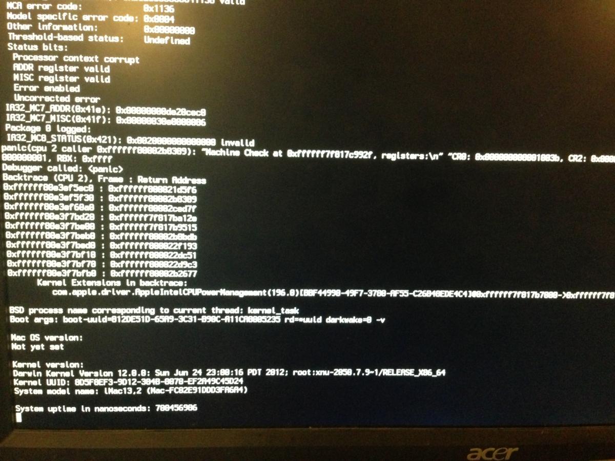

metaphysician Posted May 27, 2013 Share Posted May 27, 2013 hey folks (and especially carbo178!) - continuing a discussion we started on another topic - i'm looking for a DSDT that will enable audio for this board, which uses the ALC889 driver. the current one i have causes a kernel panic in what appears to be AppleIntelCPUPowerManagement.kext. see the enclosed picture. this is a bit odd because i patched power management with a BIOS flashback to version 0606 so my version of AICPM is unpatched. i guess the DSDT overwrites that setting maybe? and maybe the DSDT is set up for a newer unpatched BIOS like mine was before i flashed it ,and instead uses NullCPUPowerManagment or possibly a patched version of AICPM? scott Link to comment https://www.insanelymac.com/forum/topic/288765-dsdt-audio-fix-for-asus-p8z77-v-le-plus-alc889-driver/ Share on other sites More sharing options...

artur_pt Posted May 27, 2013 Share Posted May 27, 2013 hello can u boot without dsdt and nullcpupowermanagement ? if so u bios is already prepared to native powermanagement.. good hack Link to comment https://www.insanelymac.com/forum/topic/288765-dsdt-audio-fix-for-asus-p8z77-v-le-plus-alc889-driver/#findComment-1918283 Share on other sites More sharing options...
