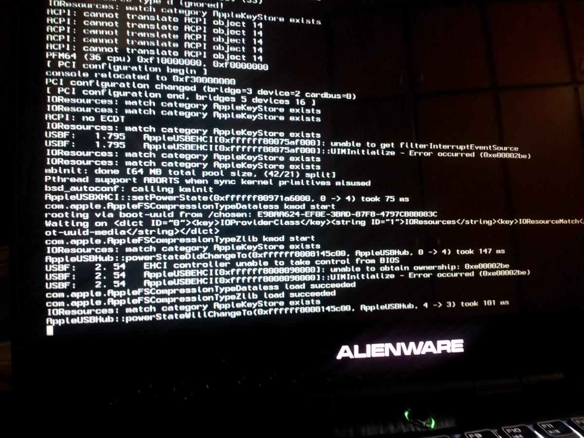

shijinmathew1508 Posted April 30, 2013 Author Share Posted April 30, 2013 Hello removing applehda.kext and booting with -f -v -x USBBusFix=Yes GraphicsEnabler=No ahcdisk=1 debug=8 and it made some progress and gets stuck at ( pic attached) thanks anything else to try ? any kexts to delete ? Link to comment https://www.insanelymac.com/forum/topic/288225-helppp-alienware-m14x-iatkos-ml2/page/2/#findComment-1911493 Share on other sites More sharing options...
Rogiervd Posted April 30, 2013 Share Posted April 30, 2013 Hello removing applehda.kext and booting with -f -v -x USBBusFix=Yes GraphicsEnabler=No ahcdisk=1 debug=8 and it made some progress and gets stuck at ( pic attached) thanks anything else to try ? any kexts to delete ? With a quick search on google i saw that this is a problem what real macs have too. The USB is taking too much power. Try some different USB ports. and unplug other devices. Link to comment https://www.insanelymac.com/forum/topic/288225-helppp-alienware-m14x-iatkos-ml2/page/2/#findComment-1911498 Share on other sites More sharing options...

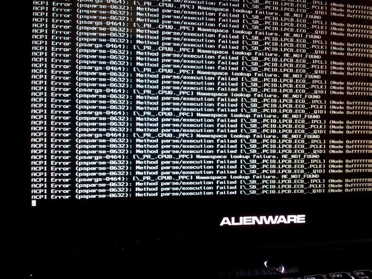

shijinmathew1508 Posted April 30, 2013 Author Share Posted April 30, 2013 OK i tried out other usb ports (used same bootflags) , but it was continuing the same error . but when i unplugged the laptop from the wall socket this happened and it kept on repeating the same lines kept on coming. also used bootflag PCIRootUID=1 ACPI ERROR (psparse-0632): Method parse/executionfailed [\_SB.PCI0.LPCB.EC0_._Q1d] same lines kept coming again and again pic Link to comment https://www.insanelymac.com/forum/topic/288225-helppp-alienware-m14x-iatkos-ml2/page/2/#findComment-1911503 Share on other sites More sharing options...
Rogiervd Posted April 30, 2013 Share Posted April 30, 2013 OK i tried out other usb ports (used same bootflags) , but it was continuing the same error . but when i unplugged the laptop from the wall socket this happened and it kept on repeating the same lines kept on coming. also used bootflag PCIRootUID=1 ACPI ERROR (psparse-0632): Method parse/executionfailed [\_SB.PCI0.LPCB.EC0_._Q1d] same lines kept coming again and again pic I almost can't find anything about this error, but try these: DropSSDT=No oemSSDT=No Link to comment https://www.insanelymac.com/forum/topic/288225-helppp-alienware-m14x-iatkos-ml2/page/2/#findComment-1911509 Share on other sites More sharing options...
shijinmathew1508 Posted April 30, 2013 Author Share Posted April 30, 2013 Nope dosent work . :\ Link to comment https://www.insanelymac.com/forum/topic/288225-helppp-alienware-m14x-iatkos-ml2/page/2/#findComment-1911517 Share on other sites More sharing options...
Rogiervd Posted April 30, 2013 Share Posted April 30, 2013 Nope dosent work . :\ Search on internet for a SSDT for your Processor. Link to comment https://www.insanelymac.com/forum/topic/288225-helppp-alienware-m14x-iatkos-ml2/page/2/#findComment-1911518 Share on other sites More sharing options...

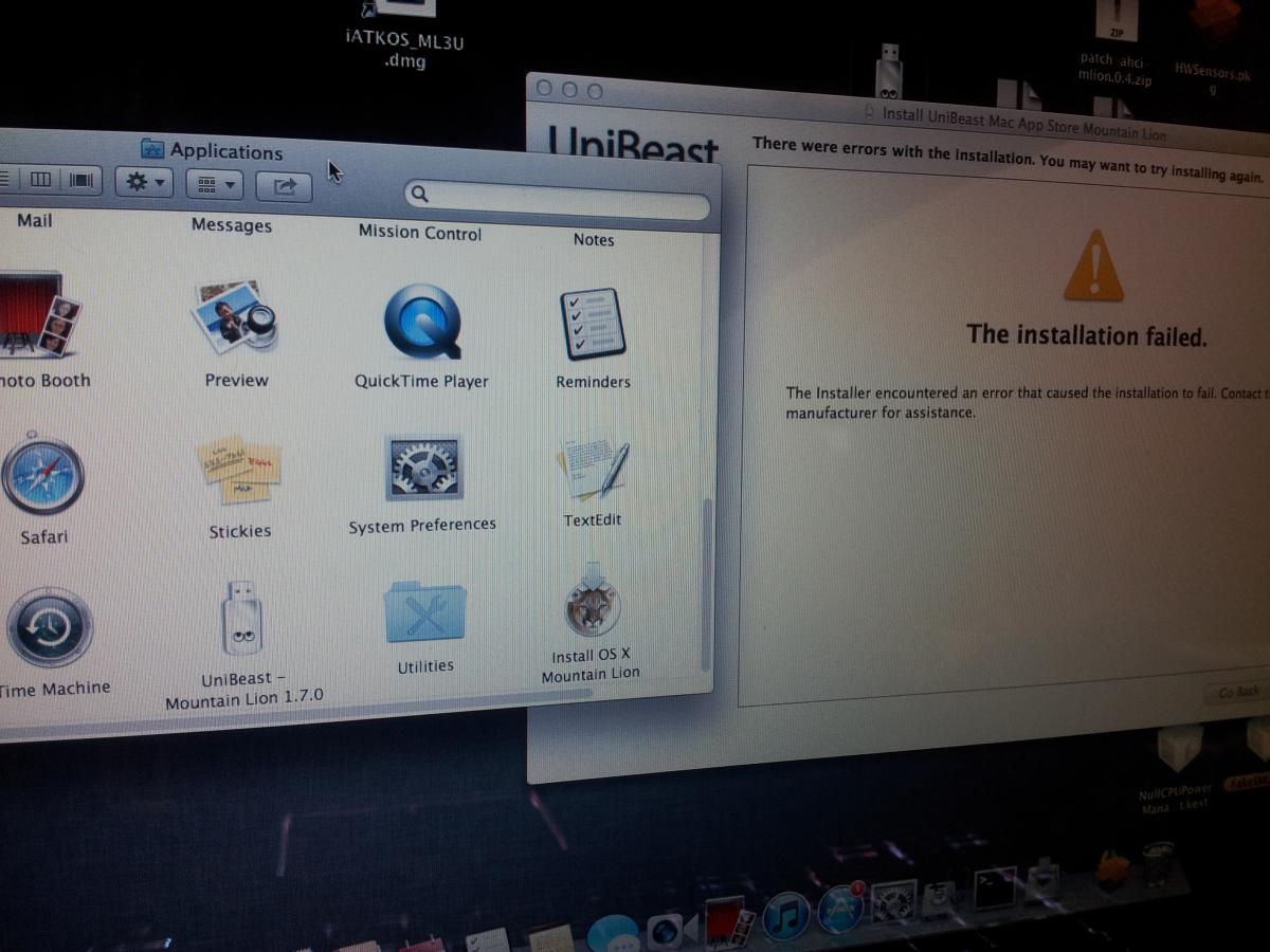

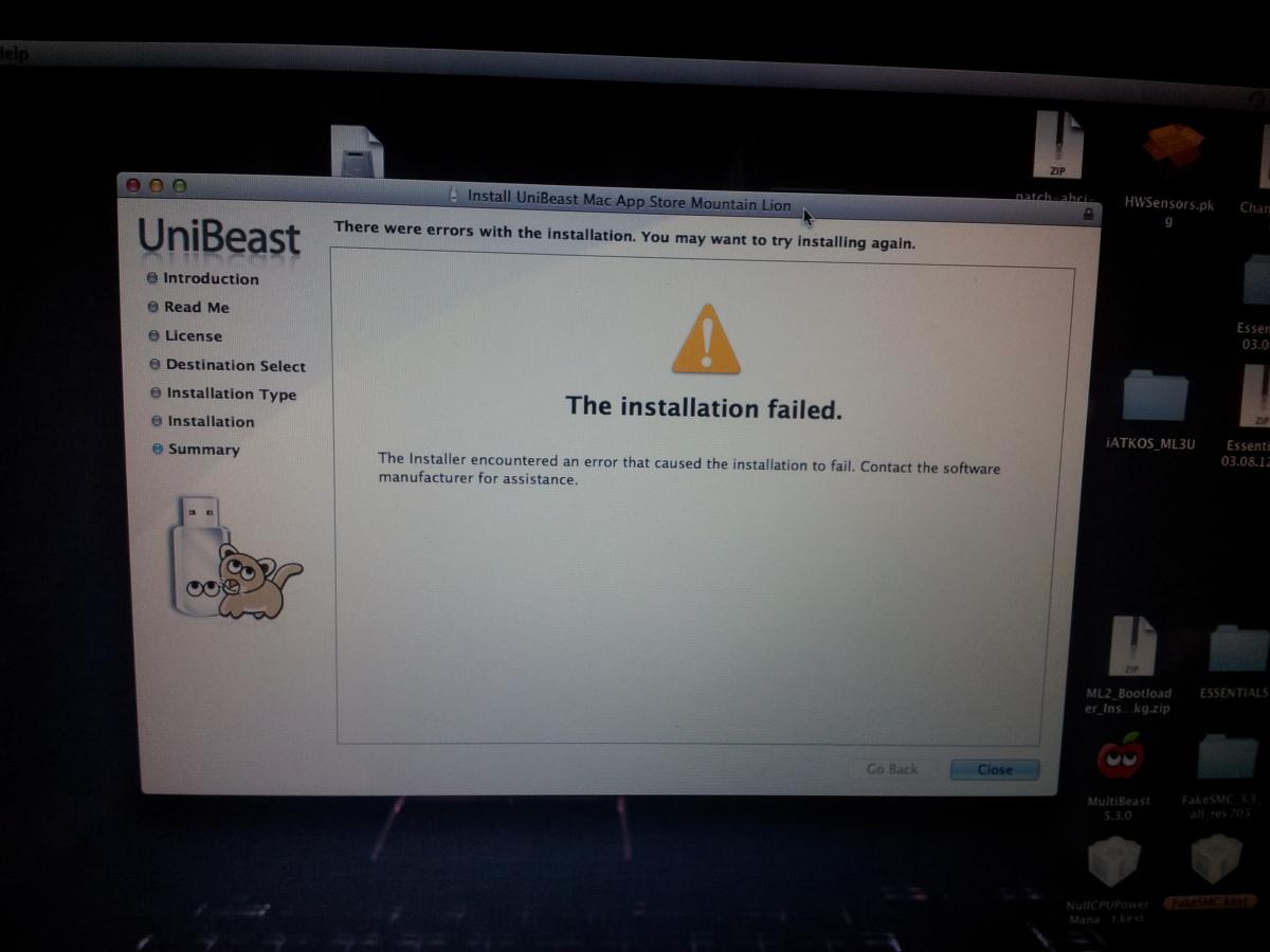

shijinmathew1508 Posted May 1, 2013 Author Share Posted May 1, 2013 Hello, iatkos ml3u by following the normal installer procedure by using the installer package present with the iatkosml3u ,when i booted using uefi the screen went blank and stayed that way nothing was happening. now while i was trying to install by using the ##### installer and by placing the mountian lion osX.app in the applications folder also it is showing some error . i tried moving ##### also to applications folder and trying but still nothing worked. help please. btw if its of any use, my bios version is A11 latest version for the alienware m14xr2. all my bios setting are correct but i dont know why it doesnt boot up. :/ Link to comment https://www.insanelymac.com/forum/topic/288225-helppp-alienware-m14x-iatkos-ml2/page/2/#findComment-1911812 Share on other sites More sharing options...
Rogiervd Posted May 1, 2013 Share Posted May 1, 2013 Hello, iatkos ml3u by following the normal installer procedure by using the installer package present with the iatkosml3u ,when i booted using uefi the screen went blank and stayed that way nothing was happening. now while i was trying to install by using the ##### installer and by placing the mountian lion osX.app in the applications folder also it is showing some error . i tried moving ##### also to applications folder and trying but still nothing worked. help please. btw if its of any use, my bios version is A11 latest version for the alienware m14xr2. all my bios setting are correct but i dont know why it doesnt boot up. :/ I can't support the tonymac way on this forum. With that you should be on tonymac Link to comment https://www.insanelymac.com/forum/topic/288225-helppp-alienware-m14x-iatkos-ml2/page/2/#findComment-1911916 Share on other sites More sharing options...

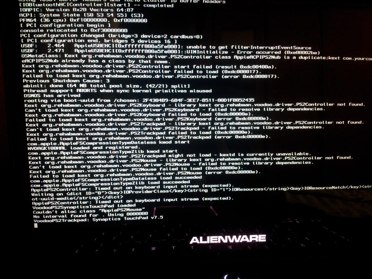

shijinmathew1508 Posted May 2, 2013 Author Share Posted May 2, 2013 made progress.. stuck here now :/ Link to comment https://www.insanelymac.com/forum/topic/288225-helppp-alienware-m14x-iatkos-ml2/page/2/#findComment-1912174 Share on other sites More sharing options...
Rogiervd Posted May 2, 2013 Share Posted May 2, 2013 You treid -x ? Link to comment https://www.insanelymac.com/forum/topic/288225-helppp-alienware-m14x-iatkos-ml2/page/2/#findComment-1912176 Share on other sites More sharing options...
shijinmathew1508 Posted May 2, 2013 Author Share Posted May 2, 2013 yesss i dids !! -x -v graphicsenabler=no usekernelcache=no Link to comment https://www.insanelymac.com/forum/topic/288225-helppp-alienware-m14x-iatkos-ml2/page/2/#findComment-1912180 Share on other sites More sharing options...
iFIRE Posted May 2, 2013 Share Posted May 2, 2013 your problem is Graphics kexts and voodooPS2 don't load, I suggest use a keyboard and mouse USB, then you can install kexts for internal keyboard and trackpad, boot with -s and type these commands . fsck -fy mount -uw / mkdir /kext_backup cd /System/Library/Extensions mv AppleIntelHD* AppleIntelSNB* AMDRadeon* ATI* GeForce* NVDA* Voodoo*/kext_backup rm ../Caches/com.apple.kext.caches/Startup/kernelcache reboot Link to comment https://www.insanelymac.com/forum/topic/288225-helppp-alienware-m14x-iatkos-ml2/page/2/#findComment-1912181 Share on other sites More sharing options...
