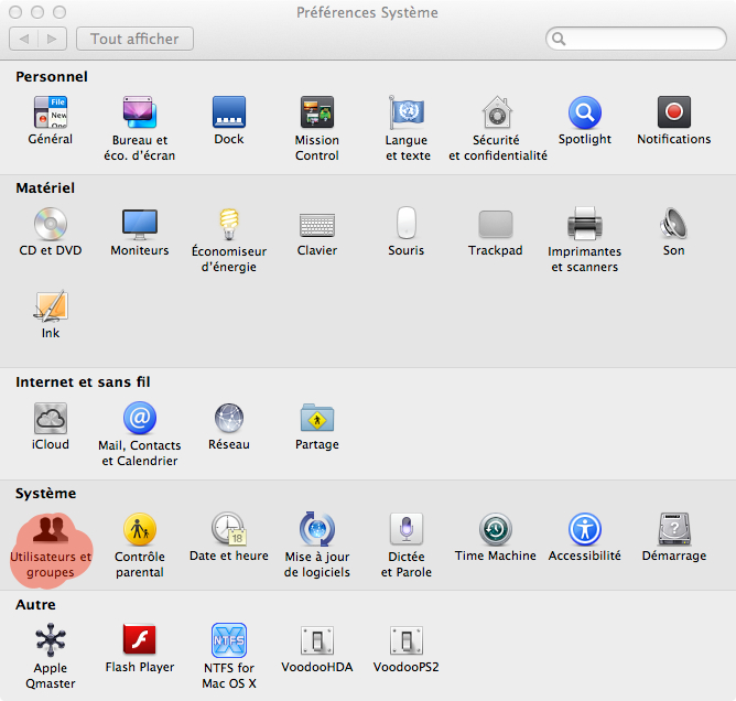

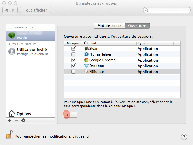

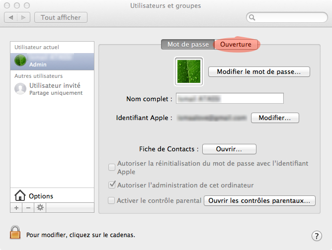

Scellow Posted April 3, 2013 Share Posted April 3, 2013 Hi everyone,Actually there is 2 solution to bypass the white screen :1 ) The sleep trick (Manual method) When you get the white screen just push the power button, wait until it sleep, then wake it by pushing the power button againIf you can't sleep your computer here is an second solution : 2 ) The rotation trick (Automatic method)A ) If you have only 1 display 1- Boot with -x flag or with a supported GPU2- Download this app :FBRotate.zip (Credit: pernacabeluda)3- Go to System Preferences -> Accounts -> Login items and add FBRotate, you can set autologin if you wantThen rebootSometimes you need to wait 5s or more so don't give up after 2sec+ B ) If you have 2 or more display Boot with -x flag or with a supported GPUGet fp-rotate from this site and uncompress it somewhere:http://modbookish.le...-display-on-os/a ) Find the Display_ID :Just run in the Terminal :fb-rotate -ib ) Make the script :Open Automator.appSelect "Application"Choose "Run shell script" (from the Actions/Utilities)Paste this script without red lines (adapt the path): // Rotate the main display /Users/Download/fb-rotate -d 0 -r 90 /Users/Download/fb-rotate -d 0 -r 0 // Rotate the 2nd display /Users/Download/fb-rotate -d x -r 90 /Users/Download/fb-rotate -d x -r 0 // Just replace x by the Display_ID Save the script somewhere.Go to System Preferences -> Accounts -> Login items and add the script Thanks to dwbr and Ostrich Egg for the rotation trick and pernacabeluda for FBRotate 4 Link to comment https://www.insanelymac.com/forum/topic/287626-guide-bypass-the-white-screen-for-ati-hd-7xxx-1083/ Share on other sites More sharing options...

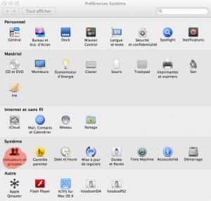

maleorderbride Posted April 21, 2013 Share Posted April 21, 2013 This does not help me---monitors just stay white and sleep does not work on this machine. i downloaded this, put in my applications folder, then added it to login items and set auto-login. Then restarted. Do I need to do any configuration with the app first in some fashion? or something else? Link to comment https://www.insanelymac.com/forum/topic/287626-guide-bypass-the-white-screen-for-ati-hd-7xxx-1083/#findComment-1909184 Share on other sites More sharing options...
Scellow Posted April 21, 2013 Author Share Posted April 21, 2013 This does not help me---monitors just stay white and sleep does not work on this machine. i downloaded this, put in my applications folder, then added it to login items and set auto-login. Then restarted. Do I need to do any configuration with the app first in some fashion? or something else? Hi, it's because the system want to launch an app wich is not from Mac Store, so it popup an message to confirm launching like the picture, but you can't see it because of the white screen problem so you just need to launch it at least once manually to allow it If that still don't work try to boot with this bootflag : GraphicsEnabler=No Link to comment https://www.insanelymac.com/forum/topic/287626-guide-bypass-the-white-screen-for-ati-hd-7xxx-1083/#findComment-1909187 Share on other sites More sharing options...
maleorderbride Posted April 21, 2013 Share Posted April 21, 2013 I'll give that shot--thanks! Makes sense. Link to comment https://www.insanelymac.com/forum/topic/287626-guide-bypass-the-white-screen-for-ati-hd-7xxx-1083/#findComment-1909229 Share on other sites More sharing options...
