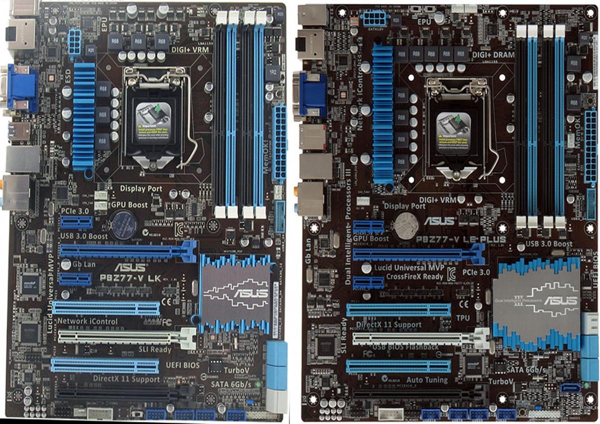

MIV Posted March 28, 2015 Share Posted March 28, 2015 See http://www.insanelymac.com/forum/topic/305007-images-and-attachments-not-showing/?p=2119211 If they won't be fixed in 2 weeks, I will re-upload them again. I can't do it now anyway. thanks for the reply Your DSDT 100% fit to the P8Z77-V-LE-PLUS I could not sleep on the defeat of his mother. Sorry for the English - use google translate sleep with your DSDT works 1 Link to comment Share on other sites More sharing options...
