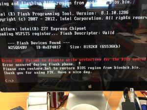

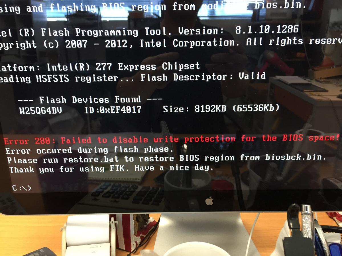

todesto Posted November 17, 2014 Share Posted November 17, 2014 Thank you for your great work, CodeRush. I tried to flash my P8Z77-V LK bios with modded one using FTK tool. (wordpress site no longer has your tools....). Followed your instruction, renaming bios file to bios.bin, flashed using biosrefl, went thru and showed "FTP Operation Passed", then waited little more and got error saying Error 280 : Failed to disable write protection for the BIOS space! as shown in the picture attached. Is my board flashed or not? Link to comment https://www.insanelymac.com/forum/topic/285444-uefipatch-uefi-patching-utility/page/68/#findComment-2086453 Share on other sites More sharing options...

todesto Posted November 28, 2014 Share Posted November 28, 2014 Can you help me with my mobo? I patched it and it gives me the Security Verification Failed and I don't have a button for usb flashback or any info on it in the manual. Mine's the ASUS Z77-A it isn't the sabertooth or nothing. http://support.asus.com/Download.aspx?SLanguage=en&m=Z77-A&p=1&s=39 You need to flash to older bios which doesn't have MSR lock, then flash with modded bios. Link to comment https://www.insanelymac.com/forum/topic/285444-uefipatch-uefi-patching-utility/page/68/#findComment-2090189 Share on other sites More sharing options...
Hack24 Posted November 28, 2014 Share Posted November 28, 2014 You need to flash to older bios which doesn't have MSR lock, then flash with modded bios. I couldn't do the oldest 0402 but went to the next one up at 0403 and tried from there with no luck still. Link to comment https://www.insanelymac.com/forum/topic/285444-uefipatch-uefi-patching-utility/page/68/#findComment-2090192 Share on other sites More sharing options...
