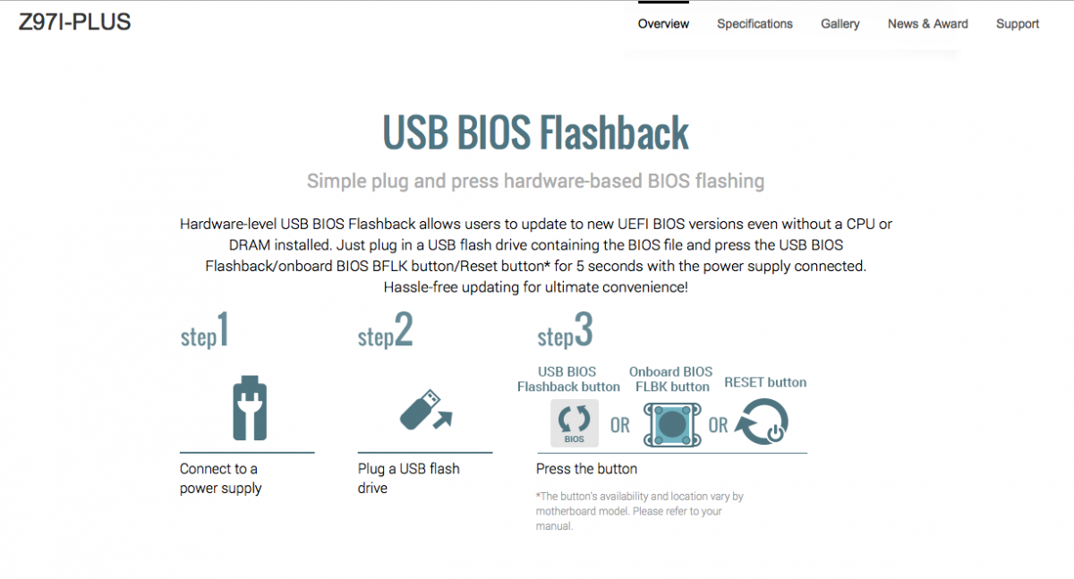

Hi, i would like to flash pmpatched bios on asus z97i-plus, but if pmaptch downloaded bios, ezflash inside bios refuse to flash, someone knows a valid methof that dont involve use of spi programmer? in this mobo bios chip is soldered and it can be hard to program using clips
Hi Riley, thanks fro the answer, in this mobo i dont have button for flashback so, i dont know how to start flashback procedure, in the manual is wrote that i have to use mobo CD but is not specified where i have to put usb key, in what specific usb slot.
The port is marked green on the IO shield (you can see a pic of it here).
I'm guessing that if you have a USB stick with the BIOS file on it that it will automatically start flashback on power up? It is strange that there's no button to start it. Is there anything in the BIOS settings? Maybe under USB...

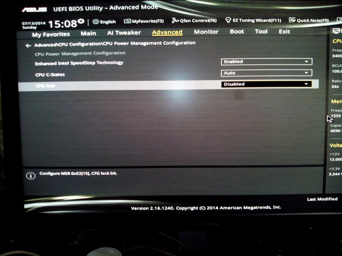

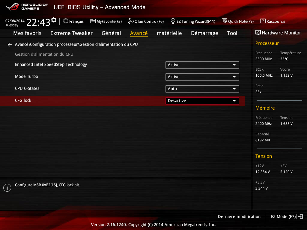

Hi, as you can see PM problem it's' fixed due to bios options to disable bit15 but remains ozmosis problem, i dont know howto flash bios with modules in
that's what they tell on their website ;)
it's most likely the reset button in your case
edit, found in the manual:
USB BIOS Flashback
USB BIOS Flashback offers a hassle-free updating solution for your ultimate convenience.
Install a USB storage device containing the BIOS file, press the Reset button for about three
seconds, and the UEFI BIOS is automatically updated even without entering the existing
BIOS or operating system. It also allows you to regularly check for UEFI BIOS updates, and
download the latest BIOS automatically.
Good news :D the procedure runs well i'v successfully flashvack bios with ozmosis stuffs  thanks Ryley
ok, but you'll need the "Bios Renamer for USB BIOS Flashback and Crashfree BIOS 2" from the downloads section for getting the correct recovery name.
