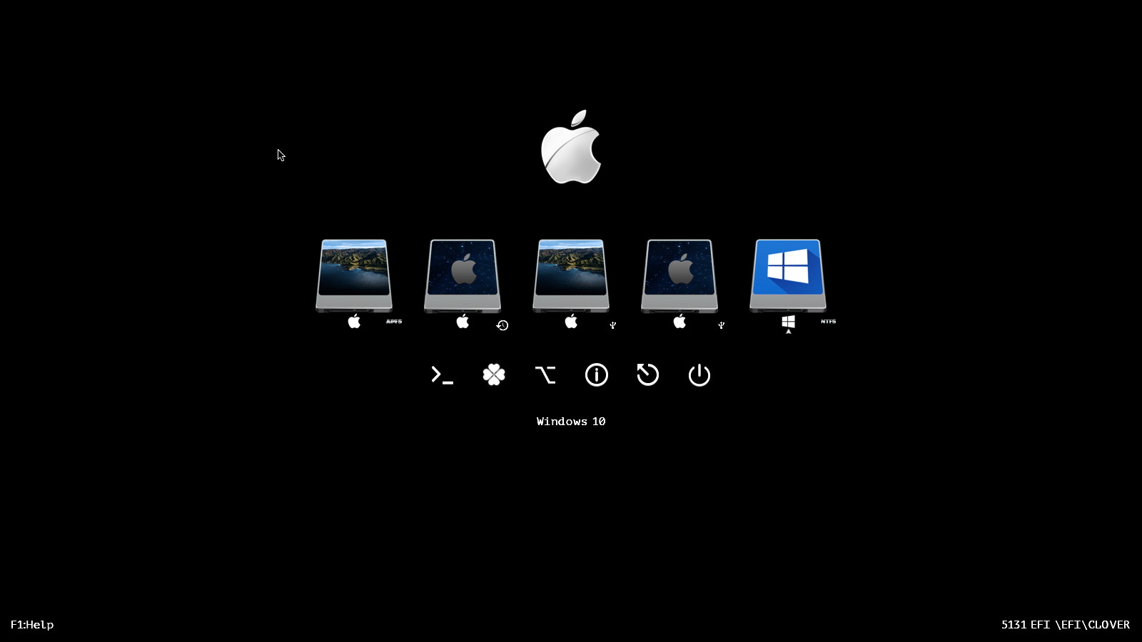

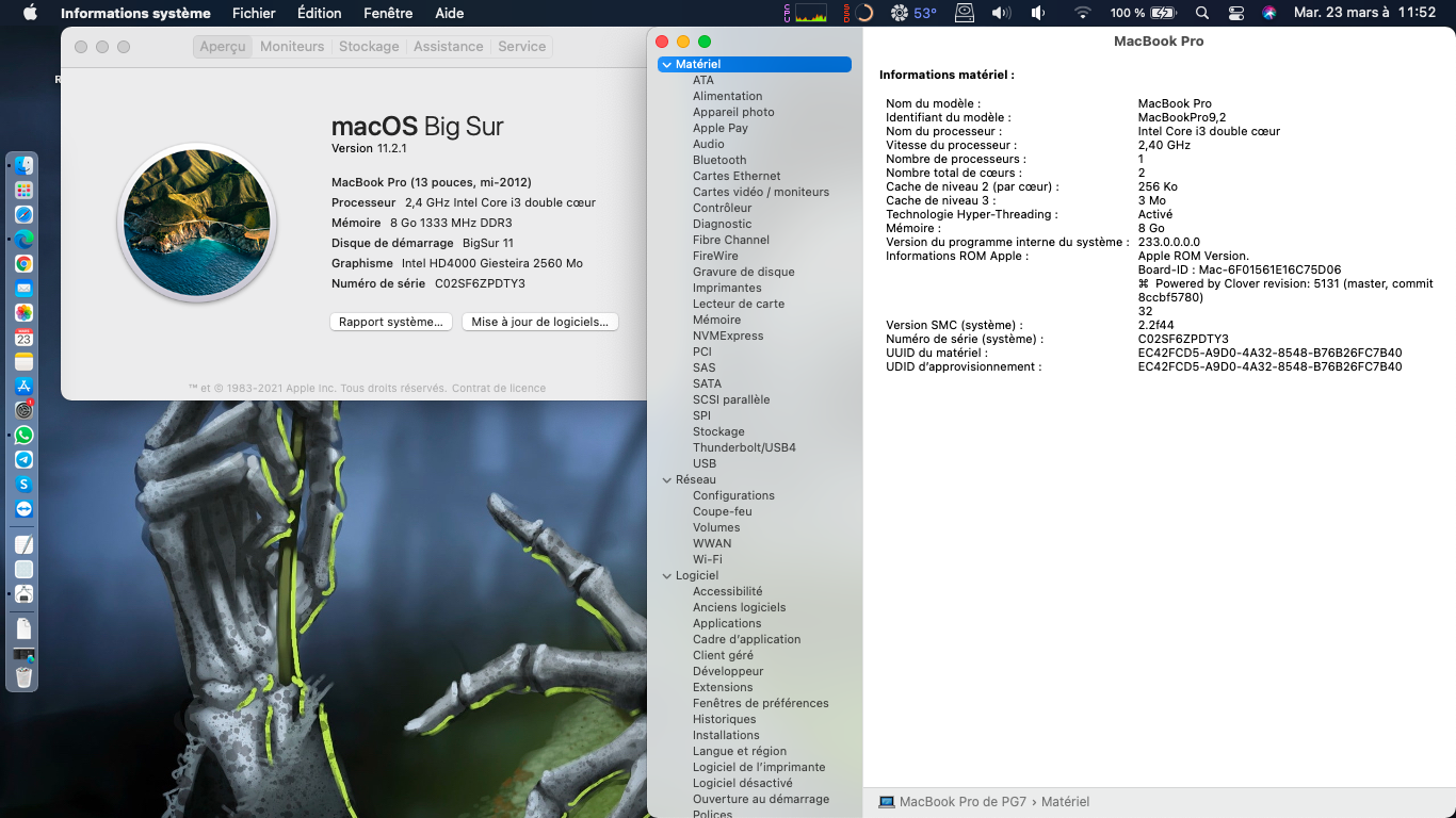

hello to everyone and the whole team
tested here and working 100%
boot on windows 10
Spoiler
406595231_Capturedecran2021-03-23a11_52_42.thumb.png.acf17bf7fbd14074c0f99fd50ef62cb6.png

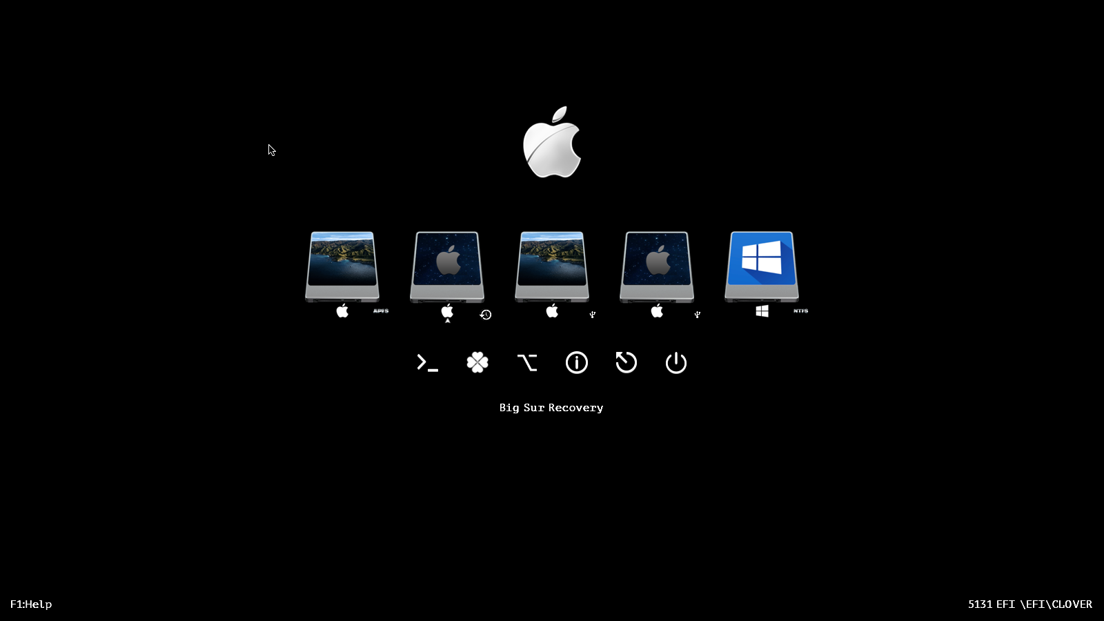

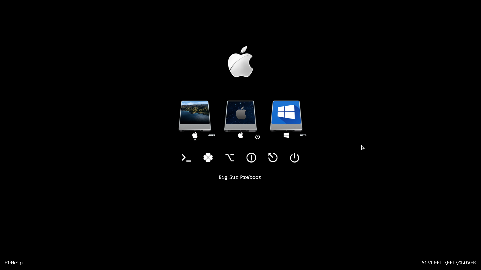

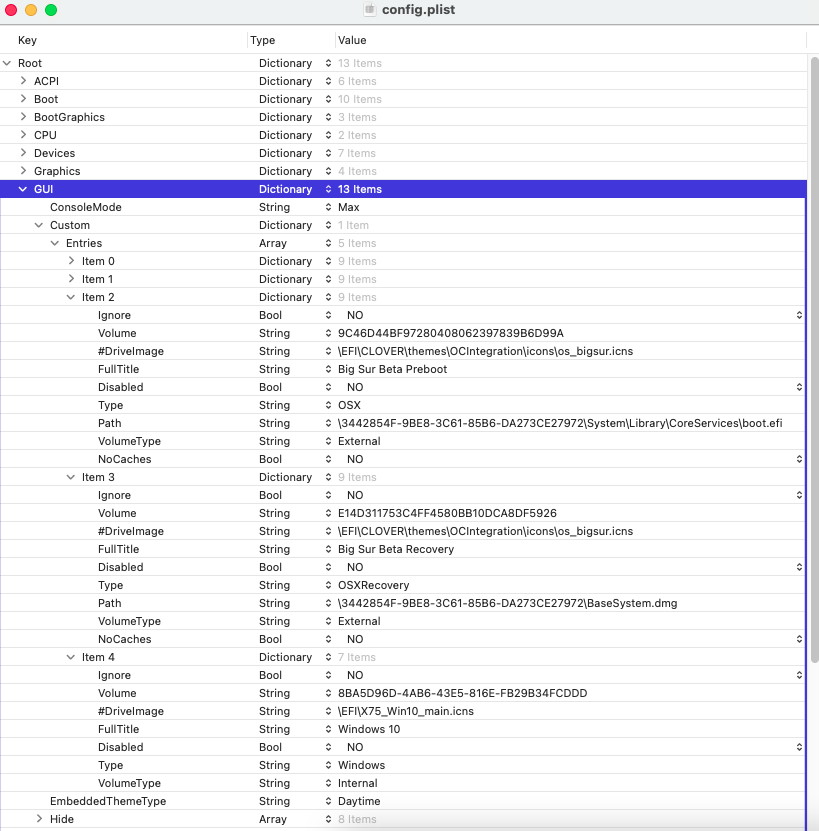

@Jief_Machak
On a Laptop Asus X75VB IvyBridge (with MBP11,3 SMBIOS) I5-3340M, HD4000
Starting Clover revision: 5131 (master, commit 829fd040d) on American Megatrends EFI
Build id: 20210322154001-829fd04-dirty
Build with: [Args: -D NO_GRUB_DRIVERS_EMBEDDED -D LESS_DEBUG -t XCODE8 | -D NO_GRUB_DRIVERS_EMBEDDED -D LESS_DEBUG --conf=/Users/xxxxx/CloverBootloader/Conf -D USE_LOW_EBDA -a X64 -b RELEASE -t XCODE8 -n 5 | OS: 11.2.3]
BOOT OK  with r5131 (829fd040d) on the next 5 CustomEntries (without SubEntries) in info.plist GUI section
On Internal SSD 2,5" Crucial MX100 500 Gb
          Big Sur 11.2.3 (20D91) : Preboot                                              item 1 in info.plist GUI/Custom/Entries
          Big Sur 11.2.3 (20D91) : Recovery                                            item 2 in info.plist GUI/Custom/Entries
On External SSD mSata EVO 860 250 Gb
          Big Sur  beta4 11.3 (20E5210c) : Preboot                                item 3 in info.plist GUI/Custom/Entries
          Big Sur beta4 11.3 (20E5210c) : Recovery                               item 4 in info.plist GUI/Custom/Entries
On Internal HDD 2,5" WD Black 500 Gb Sata III 7200
          Win10 x64 20h2                                                                          item 5 in info.plist GUI/Custom/Entries
Thanks
Best regards
  • Thanks 1

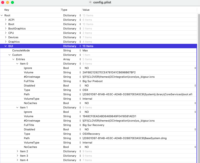

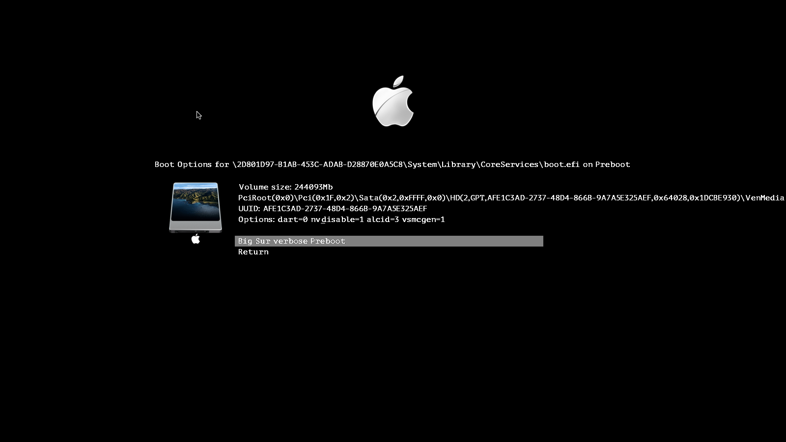

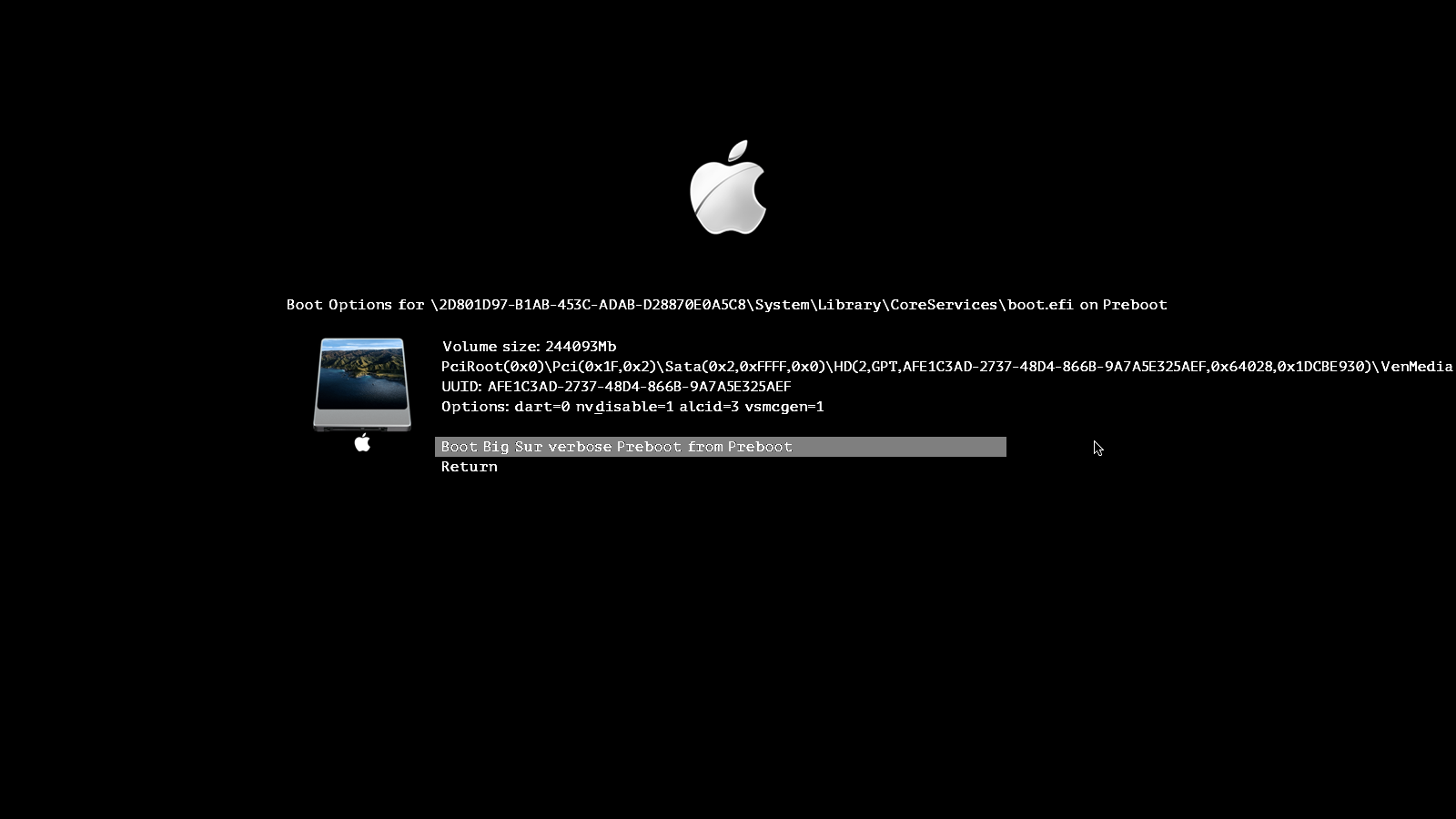

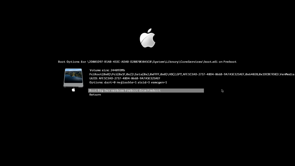

Hi Jief
I try to test "sub entries" with Clover r5131 (commit ff4c90b : Finish refactoring of custom entries settings)
just wana start "Big Sur Preboot" in verbose mode with a sub entry in custom entry to test "sub entry" but Big Sur  boots without verbose mode on std output.
regards
config.plist
49 minutes ago, matxpa said:
Hi Jief
regards
SubEntry-boot-log.txt

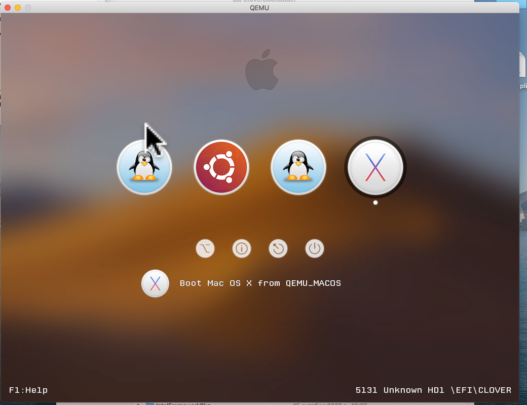

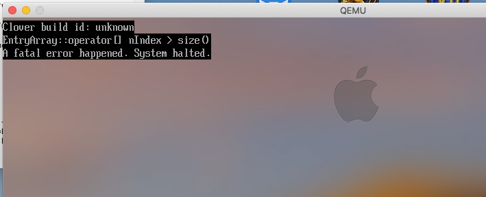

On 3/9/2020 at 3:48 PM, Jief_Machak said:
I've committed a Qemu folder, in which you can easily start under control of gdb to catch where the panic message come from. It'll considerably speed up the bug resolution.
To use :
 - regenerate your basetools to recompile GenFW
- install qemu with brew (super easy)
- install gdb with brew (super easy too, but wait...)
- codesign gdb. That's a bit annoying. Well there is plenty of guide over the internet and it doesn't take long. The thing is : if you got this error with a very good self explanatory message, you may have to create in your login keychain instead os System and move it after. I was able once to create in System, some time ago, but not anymore. This should work : https://gist.github.com/hlissner/898b7dfc0a3b63824a70e15cd0180154
If it doesn't work first time, it's not because of custom parameter of the certificate. No need to waste your time with that. The field you need to change are specify in the guide. It's really a problem of having your keychain unlock to create the certificate.
If you got a panic message, compile with GCC53 toolchain, DEBUG version, then start Qemu/gdb_launch (not need in a the folder). When you got your panic agin, gdb should give you a prompt "(gdb) ". Just type bt, return and send us the backtrace. It looks like this and it's super helpful
(gdb) bt
#0  panic () at /JiefLand/5.Devel/Clover/workspace_Clover-master/Clover--CloverHackyColor--master/rEFIt_UEFI/cpp_util/panic.cpp:18
#1  0x000000007ddb8448 in REFIT_MENU_SCREEN::RunGenericMenu (this=0x7deddfe0 <MainMenu>, StyleFunc=&virtual REFIT_MENU_SCREEN::MainMenuStyle(unsigned long long, wchar_t const*), DefaultEntryIndex=0x7fcef9b0, ChosenEntry=0x7fcef9c0)
    at /JiefLand/5.Devel/Clover/workspace_Clover-master/Clover--CloverHackyColor--master/rEFIt_UEFI/refit/menu.cpp:2770
#2  0x000000007ddc3426 in REFIT_MENU_SCREEN::RunMainMenu (this=0x7deddfe0 <MainMenu>, DefaultSelection=-1, ChosenEntry=0x7fcefac8) at /JiefLand/5.Devel/Clover/workspace_Clover-master/Clover--CloverHackyColor--master/rEFIt_UEFI/refit/menu.cpp:5682
#3  0x000000007dda8972 in RefitMain (ImageHandle=0x7ec38918, SystemTable=0x7f745f18) at /JiefLand/5.Devel/Clover/workspace_Clover-master/Clover--CloverHackyColor--master/rEFIt_UEFI/refit/main.cpp:2641
#4  0x000000007dda2360 in ProcessModuleEntryPointList (ImageHandle=0x7ec38918, SystemTable=0x7f745f18) at /JiefLand/5.Devel/Clover/workspace_Clover-master/Clover--CloverHackyColor--master/Build/Clover/DEBUG_GCC53/X64/rEFIt_UEFI/refit/DEBUG/AutoGen.c:497
#5  0x000000007dda2297 in _ModuleEntryPoint (ImageHandle=0x7ec38918, SystemTable=0x7f745f18) at /JiefLand/5.Devel/Clover/workspace_Clover-master/Clover--CloverHackyColor--master/MdePkg/Library/UefiApplicationEntryPoint/ApplicationEntryPoint.c:59
(gdb)
Sometime, in the backtrace, you get a lot of line before (means below) RefitMain. No need for that.
Hope you'll try. I'll assist.

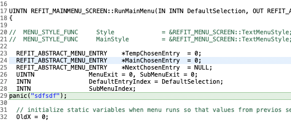

That a post I made to explain how to get the backtrace on a panic.
Very easy once you've installed gdb.
For example, I added a panic line 729:
Compile a DEBUG_GCC53 version, launch ./Qemu/gdb_launch and you get :
Breakpoint 2, panic_ (Python Exception <type 'exceptions.NameError'> Installation error: gdb.execute_unwinders function is missing:
format=0x7ddb1938 "sdfsdf", va=0x7fcef488 "\377\377\377\377\377\377\377\377", <incomplete sequence \372\316\177>) at /JiefLand/5.Devel/Clover/Clover-projects/Clover--CloverHackyColor--master.2/rEFIt_UEFI/Platform/Posix/abort.cpp:37
37	  egSetGraphicsModeEnabled(false);
(gdb)
Enter "bt" for backtrace and that's it :
(gdb) bt
Python Exception <type 'exceptions.ImportError'> No module named gdb.frames:
#0  panic_ (format=0x7ddb1938 "sdfsdf", va=0x7fcef488 "\377\377\377\377\377\377\377\377", <incomplete sequence \372\316\177>) at /JiefLand/5.Devel/Clover/Clover-projects/Clover--CloverHackyColor--master.2/rEFIt_UEFI/Platform/Posix/abort.cpp:37
#1  0x000000007dc9b0d6 in panic (Python Exception <type 'exceptions.NameError'> Installation error: gdb.execute_unwinders function is missing:
format=0x7ddb1938 "sdfsdf") at /JiefLand/5.Devel/Clover/Clover-projects/Clover--CloverHackyColor--master.2/rEFIt_UEFI/Platform/Posix/abort.cpp:71
#2  0x000000007dc7bb95 in REFIT_MAINMENU_SCREEN::RunMainMenu (Python Exception <type 'exceptions.NameError'> Installation error: gdb.execute_unwinders function is missing:
this=0x7de1d700 <MainMenu>, DefaultSelection=-1, ChosenEntry=0x7fcefa28) at /JiefLand/5.Devel/Clover/Clover-projects/Clover--CloverHackyColor--master.2/rEFIt_UEFI/gui/REFIT_MAINMENU_SCREEN.cpp:729
#3  0x000000007dc45ac4 in RefitMain (Python Exception <type 'exceptions.NameError'> Installation error: gdb.execute_unwinders function is missing:
ImageHandle=0x7ec39918, SystemTable=0x7f745f18) at /JiefLand/5.Devel/Clover/Clover-projects/Clover--CloverHackyColor--master.2/rEFIt_UEFI/refit/main.cpp:3339
#4  0x000000007dc38369 in ProcessModuleEntryPointList (Python Exception <type 'exceptions.NameError'> Installation error: gdb.execute_unwinders function is missing:
ImageHandle=0x7ec39918, SystemTable=0x7f745f18) at /JiefLand/5.Devel/Clover/Clover-projects/Clover--CloverHackyColor--master.2/Build/Clover/DEBUG_GCC53/X64/rEFIt_UEFI/refit/DEBUG/AutoGen.c:649
#5  0x000000007dc38297 in _ModuleEntryPoint (Python Exception <type 'exceptions.NameError'> Installation error: gdb.execute_unwinders function is missing:
ImageHandle=0x7ec39918, SystemTable=0x7f745f18) at /JiefLand/5.Devel/Clover/Clover-projects/Clover--CloverHackyColor--master.2/MdePkg/Library/UefiApplicationEntryPoint/ApplicationEntryPoint.c:59
(gdb)
Notice the "REFIT_MAINMENU_SCREEN.cpp:729" on the frame #2.
That way you'll get the exact line where most likely a loop among MainMenu.entries is wrong.
I can do it if you send me the Qemu img AND the "./Build/Clover/DEBUG_GCC53/X64/CLOVERX64.debug" file, generated at the compilation of the CloverX64.efi that's in the img. Any other, from a previous compilation, won't work.
1 hour ago, matxpa said:
I tried an old 5123 and your problem is already there. And it happens only when the parameter is "-v", I think. So I guess, somewhere Clover removes it for an unknown reason.
