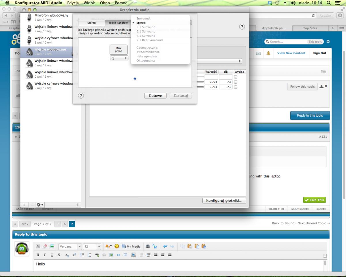

hackintosh1984 Posted September 2, 2012 Share Posted September 2, 2012 Hello I'm have problem in Mountain Lion with sound on ALC888 in EP41-UD3L and not run audio 5.1. Only 2 channel works - screen photo file I add to this post. Now use this file https://www.dropbox....pleHDA.kext.zip In Lion, my sound was working perfectly using only AppleHDA + Plataform.xml + layout888.xml all added with HDA Wizard (link to this files:) https://www.dropbox....0y9u/alc888.zip I test more metod: For Mountain Lion I make this (and not works for me - is't audio): VCH888 Posted 29 July 2012 - 04:38 PM You need to rename layout888.xml to layout12.xml and edit inside layout12.xml to be as following <key>LayoutID</key> <integer>12</integer> get perl script from zlib.pl.zip (by Revogirl, R.I.P.) (compress) perl zlib.pl deflate layout12.xml > layout12.xml.zlib also; perl zlib.pl deflate Platforms.xml > Platforms.xml.zlib copy *.xml.zlib to /System/Library/Extensions/AppleHDA.kext/Contents/Resources/ ------------------ ------------------ And link to oryginal (not patched) AppleHDA.kext for Mountain Lion : https://www.dropbox....z%20ML%20GM.zip Please help me. Thanks. Link to comment https://www.insanelymac.com/forum/topic/282474-audio-alc888-and-51-channels-patch-applehdakext/ Share on other sites More sharing options...
