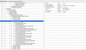

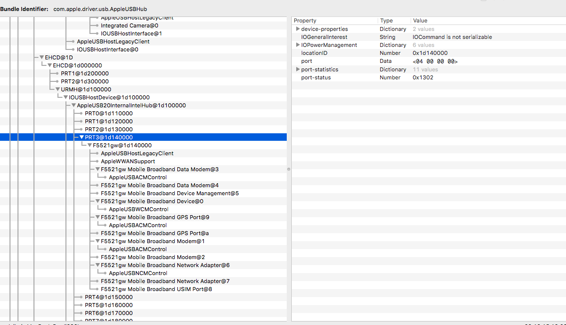

verleihnix Posted December 29, 2015 Share Posted December 29, 2015 I added VID into the info.plist of AppleWWANSupport.kext, but the IF did not show up in network preferences. This is what ioreg shows. Link to comment https://www.insanelymac.com/forum/topic/282093-ericsson-h5321gwf5521gw-wwan-card/#findComment-2201463 Share on other sites More sharing options...
