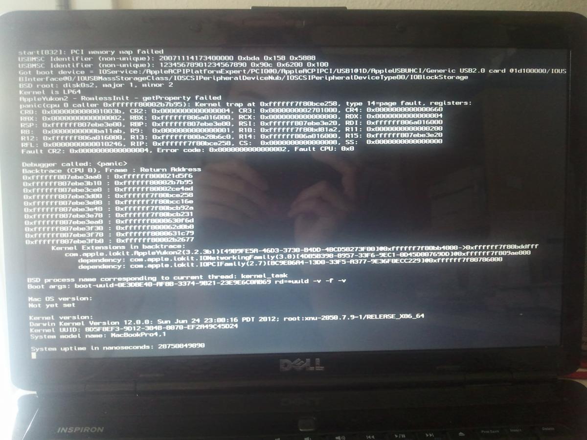

anonymous354 Posted August 7, 2012 Share Posted August 7, 2012 I'm trying to install Mountain Lion on my Dell Inspiron 1545. There is a 160GB hard drive in it that I don't mind wiping out. Prodedure I used: Opened InstallESD.dmg Opened BaseSystem.dmg Used the Disk Utility in OS X to copy the Base System image to a 32GB jump drive Ran the newest version of Chameleon I could find (r2039), and used the "Built-in Ethernet=Yes" flag (along with a few others in various configurations) Nicely ejected the jump drive and popped it in my laptop Upon boot into Chameleon, I chose the "Boot Verbose" option What went wrong: About 10 seconds into the boot sequence, I see the following message: AppleYukon2 - RomlessInit - getProperty failed after which is a stack trace. I can put up a picture of the stack trace if it would help. (Or if there is a way of putting up the complete boot log, I'd be willing to do that if somebody would tell me how.) Has anybody see this kind of error before? How might I go about figuring out what's wrong and how to fix it? Thank you for your time. Link to comment https://www.insanelymac.com/forum/topic/281614-appleyukon2-troubles-on-a-dell-inspiron-1545/ Share on other sites More sharing options...
Rampage Dev Posted August 8, 2012 Share Posted August 8, 2012 Remove the kext. I have seen a handful of users reporting that this kext is a issue. Go to your installer drive and go to S/L/E and remove the kext. Make sure you back it up some were. Link to comment https://www.insanelymac.com/forum/topic/281614-appleyukon2-troubles-on-a-dell-inspiron-1545/#findComment-1842203 Share on other sites More sharing options...

rlf Posted August 8, 2012 Share Posted August 8, 2012 Prodedure I used: Opened InstallESD.dmg Opened BaseSystem.dmg Used the Disk Utility in OS X to copy the Base System image to a 32GB jump drive Ran the newest version of Chameleon I could find (r2039), and used the "Built-in Ethernet=Yes" flag (along with a few others in various configurations) Nicely ejected the jump drive and popped it in my laptop Upon boot into Chameleon, I chose the "Boot Verbose" option You might have just skimmed over this, but did you install the kernel from InstallESD.dmg? Install FakeSMC.kext? Replace the packages alias with the Packages folder from InstallESD.dmg? 1 Link to comment https://www.insanelymac.com/forum/topic/281614-appleyukon2-troubles-on-a-dell-inspiron-1545/#findComment-1842322 Share on other sites More sharing options...

rlf Posted August 8, 2012 Share Posted August 8, 2012 Remove the kext. I have seen a handful of users reporting that this kext is a issue. Go to your installer drive and go to S/L/E and remove the kext. Make sure you back it up some were. The answer is what Here To Help said - remove the AppleYukon2.kext from your installer. On your installer, go to /System/Library/Extensions and find IONetworkingFamily.kext Right click and select Show Package Contents Go to Contents/Plugins and find AppleYukon2.kext. Drag it somewhere outside the Extensions folder. You might have to give a password. Link to comment https://www.insanelymac.com/forum/topic/281614-appleyukon2-troubles-on-a-dell-inspiron-1545/#findComment-1842420 Share on other sites More sharing options...

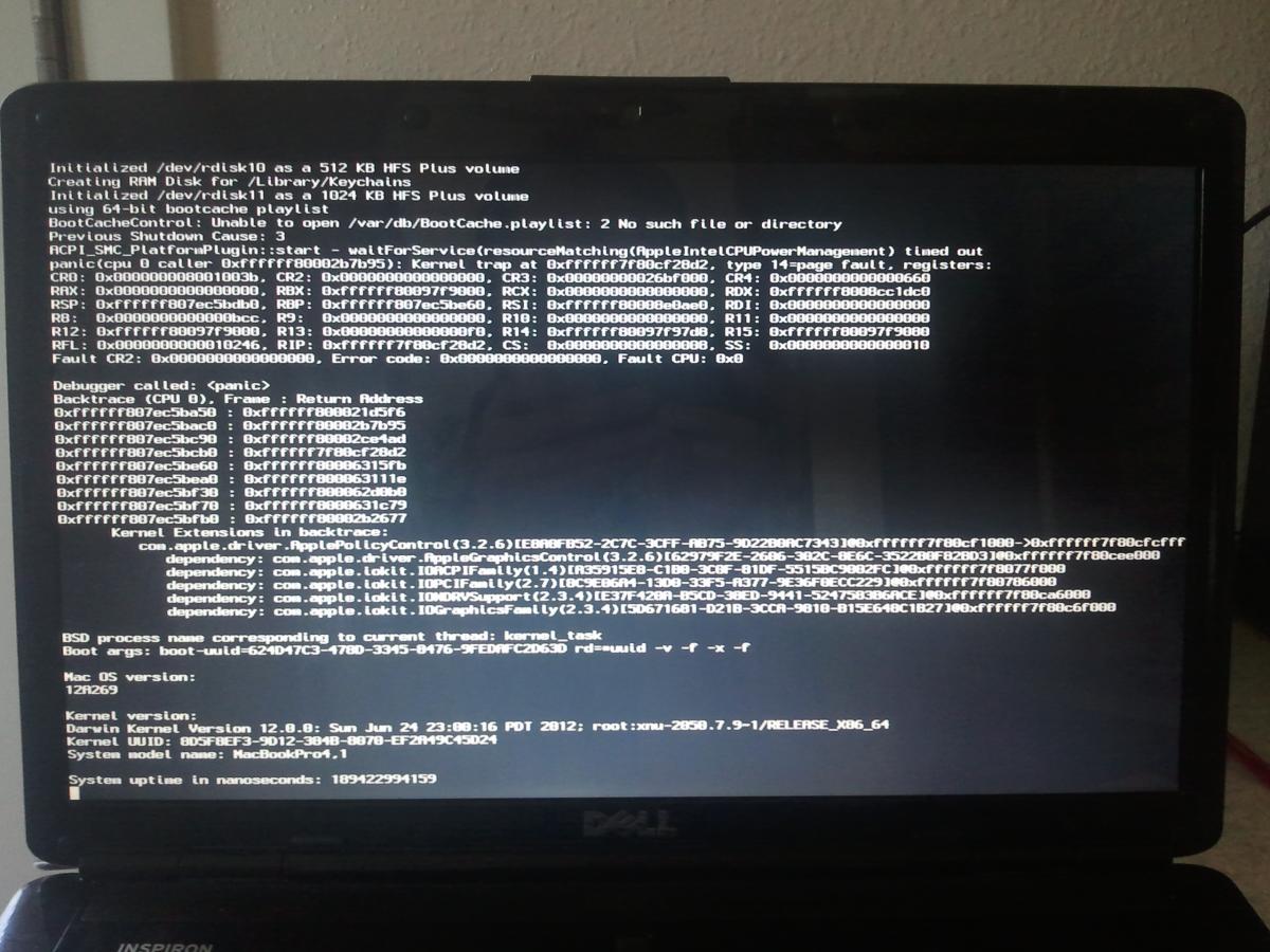

anonymous354 Posted August 8, 2012 Author Share Posted August 8, 2012 Yes, that seems to get passed that particular problem. So, that's cool. But now there's another problem! You can see it in the attached image. Link to comment https://www.insanelymac.com/forum/topic/281614-appleyukon2-troubles-on-a-dell-inspiron-1545/#findComment-1842424 Share on other sites More sharing options...
Rampage Dev Posted August 8, 2012 Share Posted August 8, 2012 Remove: ApplePolicyControl.kext Link to comment https://www.insanelymac.com/forum/topic/281614-appleyukon2-troubles-on-a-dell-inspiron-1545/#findComment-1842426 Share on other sites More sharing options...
