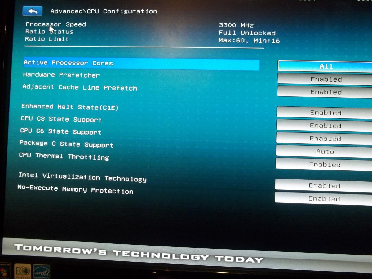

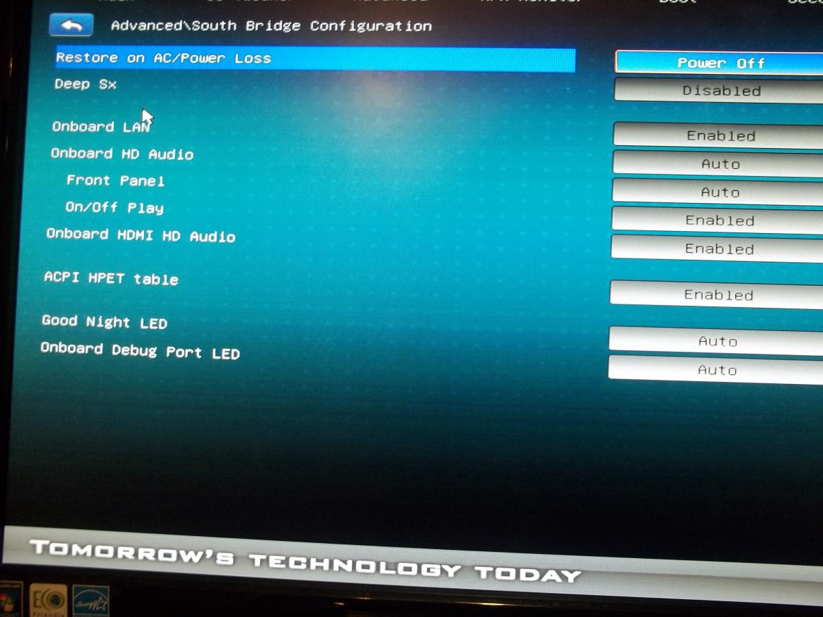

Jonathan Valdez Posted July 5, 2012 Author Share Posted July 5, 2012 i didnt see a option to select from 32 or 64 but ill try the rest ill record and post video  here is my BIOS and heres the video showing the switches i tired and no success  http://www.youtube.com/watch?v=aNH7eWBBrOA&feature=youtu.be Link to comment https://www.insanelymac.com/forum/topic/280302-fix-thanks-eep357help-lion-iatkos-l2/#findComment-1831389 Share on other sites More sharing options...
mrnico1977 Posted July 5, 2012 Share Posted July 5, 2012 from my install from this distro if you dont select 32bit then it defaults to 64. To get to the option you have to select customize during the install then select the drop down menu's. Â See this Image for all the install custom options... Â Â I've installed a few Nvidia cards into Lion and some stopped it booting, others worked but I couldn't get graphics acceleration in 64bit mode. The -v and -x options should give you more info and if its nothing major the -x may let you boot up and then change these options (some of them can be configured from the chameleon boot loader under settings (at the bottom) once your in OS X Link to comment https://www.insanelymac.com/forum/topic/280302-fix-thanks-eep357help-lion-iatkos-l2/#findComment-1831393 Share on other sites More sharing options...

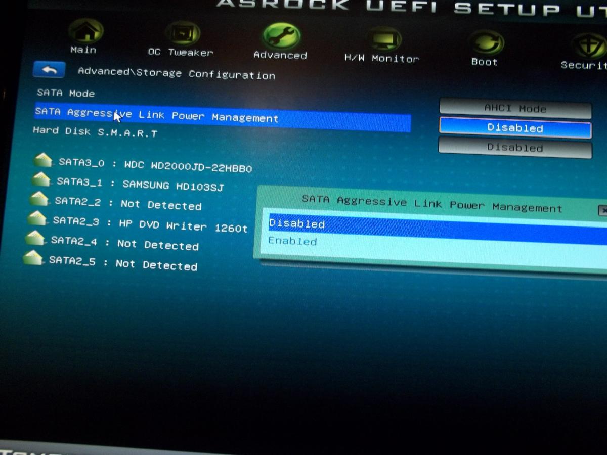

Jonathan Valdez Posted July 5, 2012 Author Share Posted July 5, 2012 on the pic where it says sata/IDA do i select the AHCI SATA?? Link to comment https://www.insanelymac.com/forum/topic/280302-fix-thanks-eep357help-lion-iatkos-l2/#findComment-1831395 Share on other sites More sharing options...
mrnico1977 Posted July 5, 2012 Share Posted July 5, 2012 The norm is to choose AHCI (usually to enable the bootloader to function), this would be the way I'd try it first however on one I built recently (and based on some comments I read) AHCI was not required for IAtkos. On mine I had to use a SAS port (as the SATA controller would not work and SATA drives function ok in SAS atleast long enough to buy a supported controller card). Some have had to enable it as Sata/IDE  I did a quick search on your board and found a comment on these bios settings... (source here :http://www.osx86.net...-3-gen-3-a.html)  SATA Mode = AHCI SpeedStep (EIST) = Enabled HPET = Enabled (64bit if possible) Suspend Mode = Only S3 C / C2 / C3 / C4-States = Enabled Overclock = Disabled  I also found this: (source here: http://www.insanelym...howtopic=275047)    Z68 Extreme 3 Gen 3 Z68 Sleep, shutdown, and reboot all work Intel Core i5-2500k XFX Ati 4850 1GB Wireless 802.11N Rt2860 Stock audio Mouse scroll is backwards, use scroll reverser, free in appstore, or website ###### 4.1.0 VoodooHDA (installed from iAtkos Ralink Kext must use arch=1386 (ralink website) chimera 1.6.0 (iatkos) EVOREBOOT for reboot and shutdown (###### from tonymac) Graphics(install from iatkos, and from ######) Appstore (must not install any network driver untill everything else is done, then install ethernet driver first, then install wireless, make sure ethernetbulitin is true. Must boot iatkos l2 using -v, might sit on saying could not find bootcache. Let it sit for about 5-10 mins, it will come up with the installer. His Graphics are different to yours so possibly ignore that for now. One key point is his mention of Ralink which is WLAN and he has put arch=i386 which essentially is 32bit mode. Secondly your bios images show all cores active. Until you have it all working I would recomend only running on 1 core, and maximum 4gb of ram (you can change both back once things are running). Did you make any customisation options during the install?  Another note: here is some options for the boot switches : http://www.macbreake...t-flags_29.html  you could try this for example,  arch=i386 Forces Mac OS X to boot into 32-bit mode. Sometimes, your CPU or graphics card won't be fully supported in OS X unless you boot into 32-bit mode. Unlike in Windows, booting the 32-bit kernel for Mac OS X does not limit your total amount of RAM to 4 GB, and you can still run 64-bit applications. However, single applications cannot use up more than 4 GB of RAM, so this is a disadvantage if you do professional video editing, or something else that takes up a lot of RAM.  cpus=1 This boot flag limits Mac OS X to using one core of your CPU.  You can use more than one at a time... for example :  -x -v arch=i386 cpus=1 Link to comment https://www.insanelymac.com/forum/topic/280302-fix-thanks-eep357help-lion-iatkos-l2/#findComment-1831397 Share on other sites More sharing options...

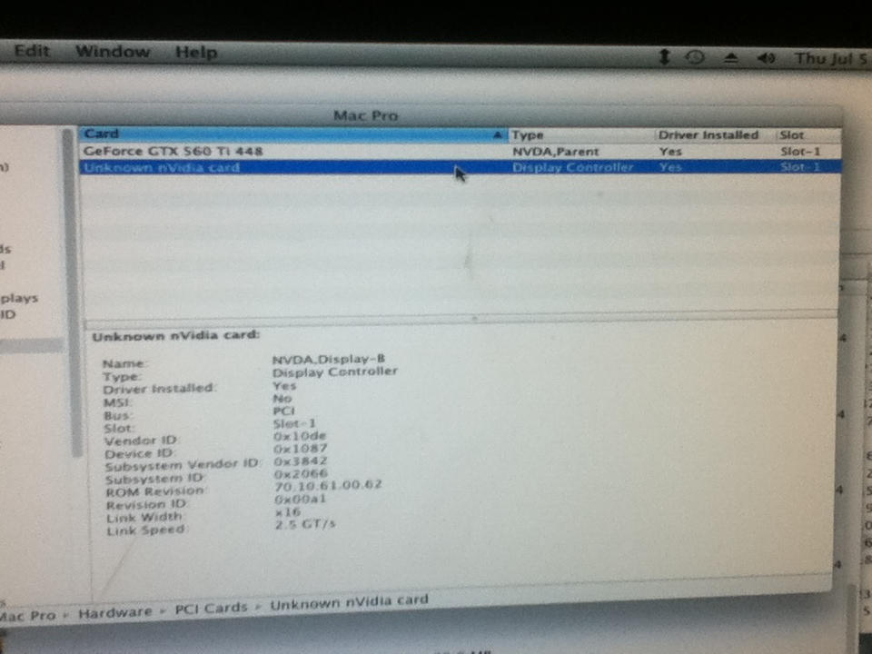

mrnico1977 Posted July 5, 2012 Share Posted July 5, 2012 NV Enabler is an option to install from the custom install option. Chameleon has the option "graphics enabler", if you use NV enabler then graphics enabler must = no. I think you will need to change to 32bit mode and set graphics enabler to yes. then according to the instruction link I posted earlier you will need to edit the kext to contain your device id... Â Â 1. Install Lion 2. After Install: Go to System/Library/Extensions/ and open up (right click and Show Package Content) the NVDAGF100Hal.kext. 3. Go to Contents and open up the file info.plist 4. Go to the following line in the file and add your own device id, (I have put the device ID for your card in the last line as you can see below, 0x120010de&0xffe0ffff ) Â Â <string> 0x06c010de&0xffe0ffff 0x0dc010de&0xffc0ffff 0x0e2010de&0xffe0ffff 0x0ee010de&0xffe0ffff 0x0f0010de&0xffc0ffff 0x104010de&0xffc0ffff 0x124010de&0xffc0ffff 0x120010de&0xffe0ffff </string> Â 5. Mac will ask you to duplicate it. Do that and save the file somewhere else. Replace it the old one with the new one. 6. In my case (I've got Chamelon installed): enable Graphics Enabler 7. Restart your mac. Done. Â quick note, you can download an application called OSX86tools here... https://code.google.com/p/osx86tools/ this will allow you to fix permisions and clear the cache etc which you should do when you have edited or installed kext's etc Link to comment https://www.insanelymac.com/forum/topic/280302-fix-thanks-eep357help-lion-iatkos-l2/#findComment-1831450 Share on other sites More sharing options...
Jonathan Valdez Posted July 5, 2012 Author Share Posted July 5, 2012 (edited) okay thnx added the line and update my OS to 10.7.4 and thnx for the other link applying as we speak lets see what happens Edited July 9, 2012 by Gringo Vermelho overquoting removed Link to comment https://www.insanelymac.com/forum/topic/280302-fix-thanks-eep357help-lion-iatkos-l2/#findComment-1831452 Share on other sites More sharing options...

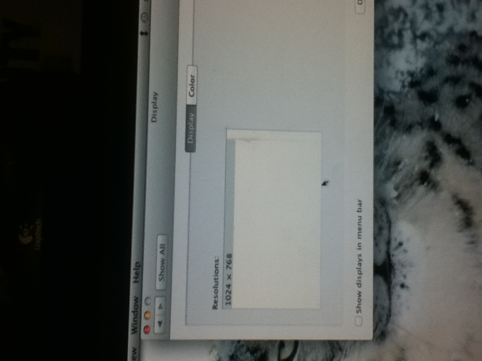

Jonathan Valdez Posted July 5, 2012 Author Share Posted July 5, 2012 so i rebooted and i though i replace the file and turns out that it didn't replace so gone try again  so i used the 32bit and that seem to work<<<<---- thats what I'm getting and i want to make the screen bigger and this is what i get Link to comment https://www.insanelymac.com/forum/topic/280302-fix-thanks-eep357help-lion-iatkos-l2/#findComment-1831458 Share on other sites More sharing options...
eep357 Posted July 5, 2012 Share Posted July 5, 2012 When replacing extensions, use Kext Wizard to install then use it's options to repair permissions and rebuild kernel cache, otherwise your old kext may still load instead of the updated one. Also note that osx will prevent editing of any files located in /System/Library/Extensions/, so to edit the info.plist, make a copy of the extension onto your desktop and edit it there, then install that edited version with Kext Wizard which will replace the orig one in the process. If you have plans to run Mountain Lion at any point, you'll need to be able to run everything 64bit as there will be no 32bit support. As for running in 32bit right now, no reinstall of operating system is needed, to run 32bit just add boot flag arch=i386 then for 64bit change it to arch=x86_64 Link to comment https://www.insanelymac.com/forum/topic/280302-fix-thanks-eep357help-lion-iatkos-l2/#findComment-1831463 Share on other sites More sharing options...
Jonathan Valdez Posted July 5, 2012 Author Share Posted July 5, 2012 When replacing extensions, use Kext Wizard to install then use it's options to repair permissions and rebuild kernel cache, otherwise your old kext may still load instead of the updated one. Also note that osx will prevent editing of any files located in /System/Library/Extensions/, so to edit the info.plist, make a copy of the extension onto your desktop and edit it there, then install that edited version with Kext Wizard which will replace the orig one in the process. If you have plans to run Mountain Lion at any point, you'll need to be able to run everything 64bit as there will be no 32bit support. As for running in 32bit right now, no reinstall of operating system is needed, to run 32bit just add boot flag arch=i386 then for 64bit change it to arch=x86_64 it work on the side of replace but it still doesn't accept my card in 64bit Link to comment https://www.insanelymac.com/forum/topic/280302-fix-thanks-eep357help-lion-iatkos-l2/#findComment-1831469 Share on other sites More sharing options...
eep357 Posted July 5, 2012 Share Posted July 5, 2012 Get everything working today, worry about 64bit tomorrow Link to comment https://www.insanelymac.com/forum/topic/280302-fix-thanks-eep357help-lion-iatkos-l2/#findComment-1831475 Share on other sites More sharing options...

Jonathan Valdez Posted July 6, 2012 Author Share Posted July 6, 2012 okay in 32 it accepts it but i can't change the resolution and on 64 my system won't even boot up Link to comment https://www.insanelymac.com/forum/topic/280302-fix-thanks-eep357help-lion-iatkos-l2/#findComment-1831493 Share on other sites More sharing options...
