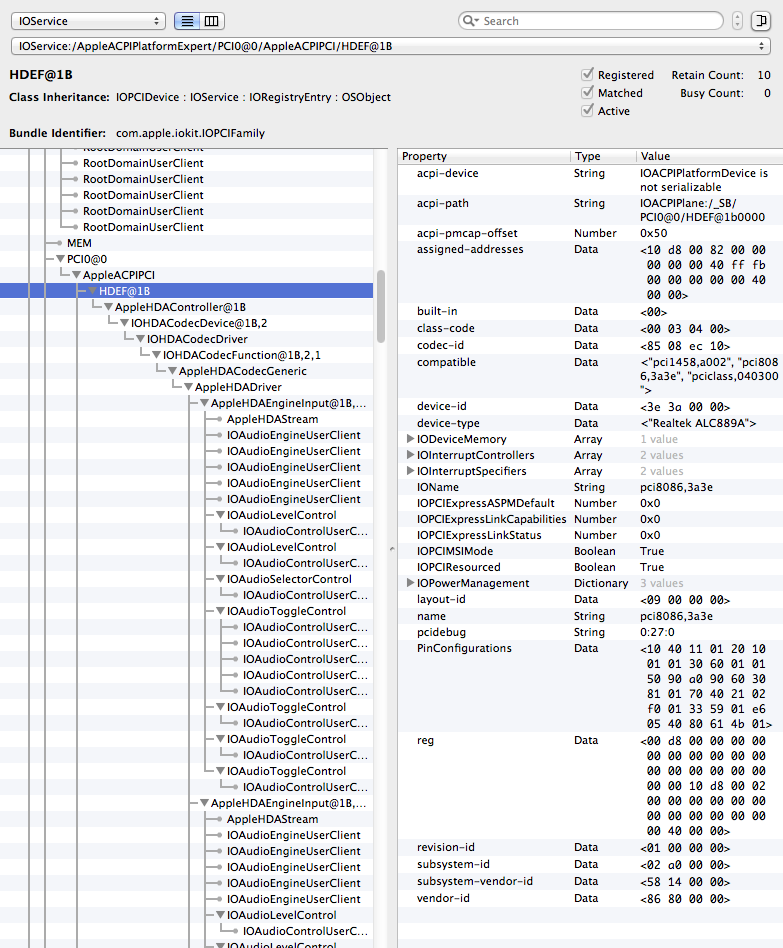

iFIRE Posted August 1, 2012 Share Posted August 1, 2012 ALC 889a ML Device (HDEF) { Name (_ADR, 0x001B0000) Method (_PRW, 0, NotSerialized) { Return (Package (0x02) { 0x0D, 0x05 }) } Method (_DSM, 4, NotSerialized) { Store (Package (0x0A) { "built-in", Buffer (One) { 0x01 }, "codec-id", Buffer (0x04) { 0x85, 0x08, 0xEC, 0x10 }, "layout-id", Buffer (0x04) { 0x75, 0x03, 0x00, 0x00 }, "device-type", Buffer (0x10) { "Realtek ALC889A" }, "PinConfigurations", Buffer (0x30) { /* 0000 */ 0x10, 0x40, 0x11, 0x01, 0x20, 0x10, 0x01, 0x01, /* 0008 */ 0x30, 0x60, 0x01, 0x01, 0x80, 0x20, 0x01, 0x01, /* 0010 */ 0x40, 0x90, 0xA1, 0x90, 0x50, 0x90, 0x81, 0x02, /* 0018 */ 0x60, 0x30, 0x81, 0x01, 0x70, 0x40, 0x21, 0x02, /* 0020 */ 0xF0, 0x61, 0x33, 0x59, 0x01, 0xE6, 0x05, 0x40, /* 0028 */ 0x90, 0x61, 0x4B, 0x01, 0xA0, 0x01, 0xCB, 0x01 } }, Local0) DTGP (Arg0, Arg1, Arg2, Arg3, RefOf (Local0)) Return (Local0) } } https://www.dropbox....LC889a%20ML.zip and look with Ioregistry Explorer your pinConfigurations if is the same: Link to comment https://www.insanelymac.com/forum/topic/280128-alc889a-no-sound-on-ml-dp4/page/2/#findComment-1839775 Share on other sites More sharing options...

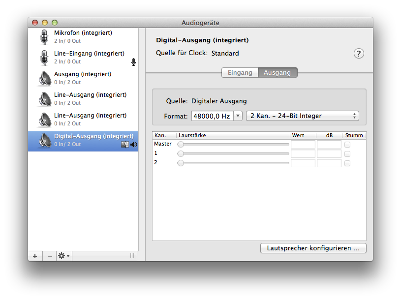

Kunze Posted August 5, 2012 Share Posted August 5, 2012 Is there somebody using the ALC889a with digital output? I usually have stuttering sounds. Only if i change the format from 24bit to digital audio an back to 24bit the sound is working normally. But this only works for songs playing with mac preview. After a reboot the sound is stuttering again. DSDT: Device (HDEF) { Name (_ADR, 0x001B0000) Method (_PRW, 0, NotSerialized) { Return (Package (0x02) { 0x0D, 0x05 }) } Method (_DSM, 4, NotSerialized) { Store (Package (0x0A) { "built-in", Buffer (One) { 0x01 }, "codec-id", Buffer (0x04) { 0x85, 0x08, 0xEC, 0x10 }, "layout-id", Buffer (0x04) { 0x0c, 0x00, 0x00, 0x00 }, "device-type", Buffer (0x10) { "Realtek ALC889A" }, "PinConfigurations", Buffer (0x30) { /* 0000 */ 0x10, 0x40, 0x11, 0x01, 0x20, 0x10, 0x01, 0x01, /* 0008 */ 0x30, 0x60, 0x01, 0x01, 0x80, 0x20, 0x01, 0x01, /* 0010 */ 0x40, 0x90, 0xA1, 0x90, 0x50, 0x90, 0x81, 0x02, /* 0018 */ 0x60, 0x30, 0x81, 0x01, 0x70, 0x40, 0x21, 0x02, /* 0020 */ 0xF0, 0x61, 0x33, 0x59, 0x01, 0xE6, 0x05, 0x40, /* 0028 */ 0x90, 0x61, 0x4B, 0x01, 0xA0, 0x01, 0xCB, 0x01 } }, Local0) DTGP (Arg0, Arg1, Arg2, Arg3, RefOf (Local0)) Return (Local0) } } ALC885HDA_Lion_MLion_V1-1.00: ALC885HDA.kext in S/L/E copied layout12.xml.zlib and Platforms.xml.zlib to AppleHDA.kext repaired permissions and rebuilded cache my system: GA-EX58-UD4P with i7 920 @ 4GHz Link to comment https://www.insanelymac.com/forum/topic/280128-alc889a-no-sound-on-ml-dp4/page/2/#findComment-1841321 Share on other sites More sharing options...
