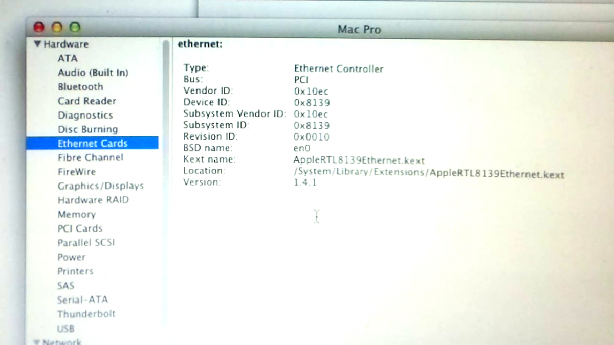

eep357 Posted October 23, 2012 Share Posted October 23, 2012 need device ID and vendor ID before I can help Link to comment https://www.insanelymac.com/forum/topic/278540-solved-unable-to-connect-internet/page/2/#findComment-1862640 Share on other sites More sharing options...
Charan Cherry Patnaik Posted October 24, 2012 Author Share Posted October 24, 2012 need device ID and vendor ID before I can help of ethernet card?? or something else? please tell me and where can i find them if you want ethernet card one here is it .... vendor id : 0x10ec device id: 0x8139 Link to comment https://www.insanelymac.com/forum/topic/278540-solved-unable-to-connect-internet/page/2/#findComment-1862684 Share on other sites More sharing options...

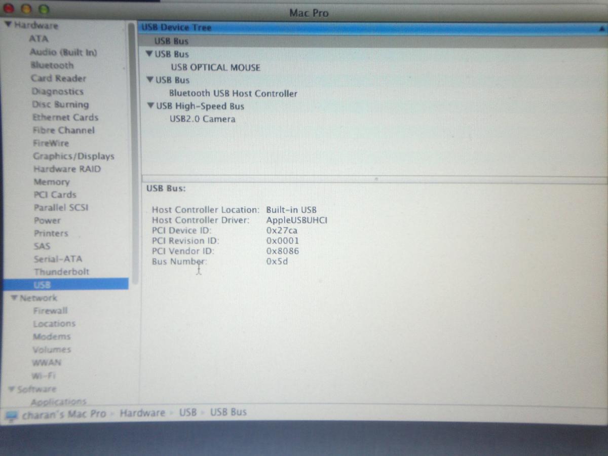

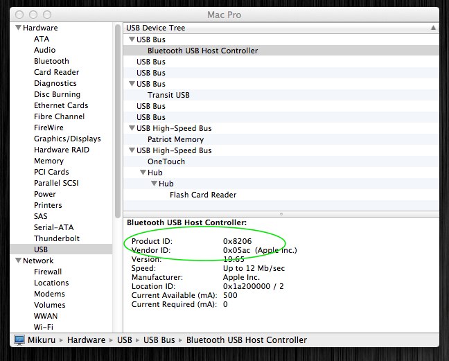

eep357 Posted October 25, 2012 Share Posted October 25, 2012 That's the only one I didn't need You can use System Info app from here System Info, an app to get hardware and kexts info for any PCI devices, for USB devices, check in System Info from OSX, click the apple logo in the menubar and hold down option key, about this mac will change to system info, click it and go to usb and highlight your device. Link to comment https://www.insanelymac.com/forum/topic/278540-solved-unable-to-connect-internet/page/2/#findComment-1863012 Share on other sites More sharing options...
Charan Cherry Patnaik Posted October 27, 2012 Author Share Posted October 27, 2012 here is that image but it is different from that image but i got only this one Link to comment https://www.insanelymac.com/forum/topic/278540-solved-unable-to-connect-internet/page/2/#findComment-1863328 Share on other sites More sharing options...

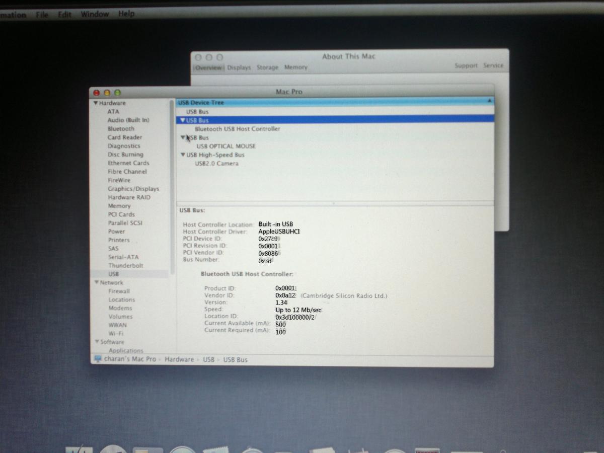

Charan Cherry Patnaik Posted October 27, 2012 Author Share Posted October 27, 2012 Got it and modded for you for clear vision :wink2: Link to comment https://www.insanelymac.com/forum/topic/278540-solved-unable-to-connect-internet/page/2/#findComment-1863374 Share on other sites More sharing options...
eep357 Posted October 28, 2012 Share Posted October 28, 2012 didn't really need the ID for your bluetooth, that was just an example how to get device ID for USB devices. Need device and vendor ID for the different wifi devices your trying to make work. If they are USB, that's how to get them, if they are PCI, use System info.app 1 Link to comment https://www.insanelymac.com/forum/topic/278540-solved-unable-to-connect-internet/page/2/#findComment-1863466 Share on other sites More sharing options...
Charan Cherry Patnaik Posted October 28, 2012 Author Share Posted October 28, 2012 didn't really need the ID for your bluetooth, that was just an example how to get device ID for USB devices. Need device and vendor ID for the different wifi devices your trying to make work. If they are USB, that's how to get them, if they are PCI, use System info.app hmmm here is that... one more thing i can ping to my DNS-s , and also my device (NANO Station M2) please check this for my device config. its default page is opening ....M_Series_Beginner_Guide.pdf this is my device manual Link to comment https://www.insanelymac.com/forum/topic/278540-solved-unable-to-connect-internet/page/2/#findComment-1863532 Share on other sites More sharing options...
eep357 Posted October 31, 2012 Share Posted October 31, 2012 Atheros8152/8158, put that one in and get the device ID and vendor ID. Then do the same with D-Link. And PLEASE use System Info, an app to get hardware and kexts info if they are PCI devices. Link to comment https://www.insanelymac.com/forum/topic/278540-solved-unable-to-connect-internet/page/2/#findComment-1864098 Share on other sites More sharing options...
