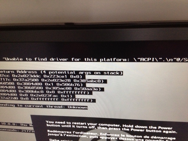

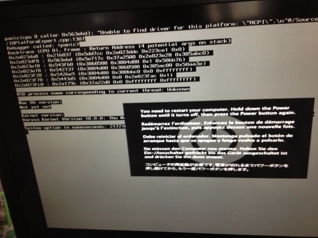

gypsymoth Posted March 31, 2012 Author Share Posted March 31, 2012 firstly... thanks again all burnt ######, put it in and got to the ###### splash screen Interestingly, I had the option to either boot into ###### OR the OSX I had just before the crash... which suggests the boot disk is still active? When I chose either option, I got the following errors and hit the wall Link to comment https://www.insanelymac.com/forum/topic/277657-broken-hackintosh-cant-boot-no-support/#findComment-1810003 Share on other sites More sharing options...
rlf Posted March 31, 2012 Share Posted March 31, 2012 What it suggests to me is that the 1st drive may still be dead but there is an installation of OSX on the 2nd drive and that is what it was trying to boot when you got the kernel panic. What if you went into BIOS and set the 2nd drive to be the primary boot drive and see if it will try to boot the 2nd drive? Link to comment https://www.insanelymac.com/forum/topic/277657-broken-hackintosh-cant-boot-no-support/#findComment-1810004 Share on other sites More sharing options...
eep357 Posted April 3, 2012 Share Posted April 3, 2012 Also check bios and make sure sata is set to AHCI and not IDE Link to comment https://www.insanelymac.com/forum/topic/277657-broken-hackintosh-cant-boot-no-support/#findComment-1810676 Share on other sites More sharing options...
Gringo Vermelho Posted April 3, 2012 Share Posted April 3, 2012 Yeah I was thinking that too, the BIOS probably reset itself to default settings that don't work with his OS X installation, maybe the CMOS battery died while the PC was unplugged. Replace the CMOS battery (ask for a CR-2032) and read up on recommended BIOS settings for OS X. 1 Link to comment https://www.insanelymac.com/forum/topic/277657-broken-hackintosh-cant-boot-no-support/#findComment-1810757 Share on other sites More sharing options...
