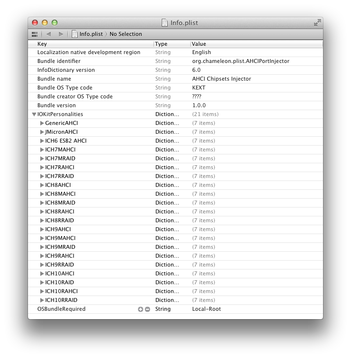

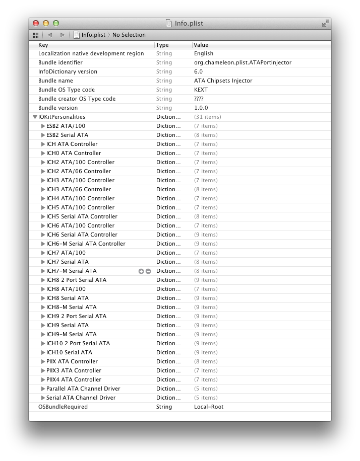

Gringo Vermelho Posted March 28, 2012 Share Posted March 28, 2012 Okay, I've been wanting to drive a nail through this {censored} for a while now. For the record that means the endless "still waiting for root device" posts and the like, in this forum and elsewhere. Many thanks to foopy for covering jumper information up there. First I'd like to make it clear that both SATA and PATA drives are technically IDE drives. IDE stands for "integrated drive electronics" and obviously that hasn't changed just because you use a funny little red cable with a black plug instead of a big old ribbon cable to connect your hard drive or DVD drive to your motherboard. I don't really care what anyone says, there is only Parallel ATA and Serial ATA. Just forget about IDE. Note that this is about Intel ICHx - for nforce southbridges see Verdan't nforce guides. Even though drivers exist for JMicron, Marvell, ATI/AMD and VIA drive controllers, I can't recommend using anything but Intel or nforce, because that's what Apple use. The drivers that ship with OS X already support your Intel ICHx drive controller. Sometimes the drivers need a little nudge in the right direction though - Apple don't use (for example) ICH7R, ICH8R, ICH9R or ICH10R. These have a different device ID than their non-R versions, and the drivers don't know about these, but they are similar enough that the driver will work fine anyway. Most will work right away once set to AHCI mode in your PCs BIOS, though some, such as the ICH10R, will be seen by OS X as "Generic SATA controller". Others will throw the "Still waiting for root device" error and halt during boot, which is when you know that 1) your BIOS settings need tweaking 2) you need to use one of the injectors mentioned below, or AppleIntelPIIXATA.kext 3) you need to experiment with drive jumpering/cabling and how you're combining PATA and SATA drives (it's better to not combine the two at all) 4) 1), 2) and 3) all at once. The Injector kexts described below (find them with Google) "injects" the device IDs for a bunch of ICHx controllers into the proper OS X ATA drivers, so that they will detect and drive your hardware. You can use these if your ICHx controller can't be set to AHCI mode, or if you just want it to show by its proper name in System Profiler/System Information. AppleIntelPIIXATA.kext is a proper driver, it can work with older ICHx such as the ICH5. More details below. For Parallel-ATA, or non-AHCI mode Serial-ATA drives on Intel ICHx drive controllers: AppleIntelPIIXATA.kext OR ATAPortInjector.kext (yes! Don't attempt to use both at once!) For Serial ATA drives in AHCI or RAID mode on Intel ICHx drive controllers that aren't supported directly on OS X: AHCIPortInjector.kext OR LegacyAppleAHCIPort.kext (again, both at once = don't do it) For best possible compatibility, do not mix PATA and SATA drives on the same drive controller. It can be made to work but you have to be lucky and very very patient. And it's generally a pain in the ass. This is exactly the type of Hackintosh configuration issue that is best solved with money.* If you must mix SATA and PATA drives on ICHx, then welcome to your worst computing nightmare. There is absolutely no guarantee that the following will work. Whatever happens it's probably your fault for not having enough patience (yes, I'm only saying that to discourage anyone from trying). Your DVD drive must be jumpered as master, connected to the end of the cable, and it will not work if there's a slave device connected to the same cable. Disconnect all other PATA drives. If your installation target is a PATA hard drive, jumper it as master and place it at the end of the cable, on the other channel. Do not attempt to use two devices on the same cable in master/slave configuration - it will not work. Older ICHx drive controllers don't have "AHCI" listed in the BIOS, instead they have annoying and non-descript settings like "enhanced", "combined" and "native" (? don't quite remember) mode. Each of these modes allow a different combination of PATA and SATA drives, only PATA drives, or only SATA drives to work. The necessary details on this can be found in your motherboard manual somewhere. Now is a good time to read it. Now for the fun part: Two of these modes will work correctly with OS X, one of them will work with AppleIntelPIIATA.kext, and another with ATAPortInjector.kext. Honestly, I'm glad that I can no longer remember how, or which one. Did I mention already that it's a pain in the ass? Lastly, If you're mixing PATA and SATA drives on an ICHx that has "AHCI" mode, do not enable it, otherwise the PATA drives probably won't work. *For the love of all that is holy in this world, just buy a SATA DVD drive and be happy!! And if you must use PATA drives, connect them to your motherboards off-chipset, secondary drive controller (JMicron, Marvell, etc) and leave your hard drives connected to the ICHx in AHCI or RAID mode. If you only have RAID mode but no AHCI mode, set it to RAID. RAID implies AHCI. You don't have to create a RAID array, and even if you did it wouldn't work anyway, OS X does not support ICHx hardware RAID. If your drives appear on the desktop and have screaming orange icons it's because they are seen as "external". With some legacy kexts, hotpluggable AHCI hard drives get these orange icons. There are fixes for this available but I've forgotten almost everything about them. Neither can I recall if there is a way to have hot-pluggable hard drives, yet have them detected as internal drives. I do remember this; the quick fix for this in the past was OrangeIconFix.kext, but the downside is that it only changes the icons and doesn't actually fix anything. I believe that AHCIPortInjector.kext sets all drives as "internal", which means you lose hot-plugability. Please Google or use the forum search for more information because there's nothing new here: Everything that's useful in this post has been repeated over and over in the last five years. 5 Link to comment https://www.insanelymac.com/forum/topic/277497-hdds-are-sata-but-optical-drive-is-ide-resulting-in-still-waiting-for-root-device-error/#findComment-1809257 Share on other sites More sharing options...

Gringo Vermelho Posted March 29, 2012 Share Posted March 29, 2012 Don't use the modified IOATAFamily from that link. The injector.kexts I'm talking about can be chucked in /System/Library/Extensions and will never be overwritten by a system update. IOATAFamily is an Apple kext and if that gets updated, you are hosed on the spot because then you won't be able to boot. The whole point of using injectors is that they work alongside unmodified Apple drivers. 1 Link to comment https://www.insanelymac.com/forum/topic/277497-hdds-are-sata-but-optical-drive-is-ide-resulting-in-still-waiting-for-root-device-error/#findComment-1809398 Share on other sites More sharing options...
B.L.E.A.K Posted March 29, 2012 Author Share Posted March 29, 2012 Could you just be so kind as to enlighten this n00b on how to uses the ATAPortInjector.kext?? I can't seem to figure out a way. And I am assuming this will work only on Retail OS X Lion and now iAtkosL2? but isn't the AppleIntelPIIXATA.kext you mentioned the same as in the link. I think what you are saying is to not use: AppleIntelPIIXATA.kext BUT ATAPortInjector.kext..correct? Link to comment https://www.insanelymac.com/forum/topic/277497-hdds-are-sata-but-optical-drive-is-ide-resulting-in-still-waiting-for-root-device-error/#findComment-1809469 Share on other sites More sharing options...
Gringo Vermelho Posted March 29, 2012 Share Posted March 29, 2012 Could you just be so kind as to enlighten this n00b on how to uses the ATAPortInjector.kext?? You place the kernel extension in the /Extra/Extensions folder on the partition that holds the boot loader that will boot your Lion installer. The injectors will work from /Extra/Extensions, but I don't think that a modified IOATAFamily.kext or AppleIntelPIIXATA.kext will. They probably need to be in /System/Library/Extensions to work, because of dependencies on other kernel extensions. isn't the AppleIntelPIIXATA.kext you mentioned the same as in the link. No. IOATAFamily.kext and AppleIntelPIIXATA.kext are not the same thing. I repeat: I don't recommend using the IOATAFamily.kext from the link because it is a modified Apple kext. The modifications will be overwritten once you run a Lion system update, and you will not be able to boot. I have already told you, you will not have this problem with ATAPortInjector or AppleIntelPIIXATA.kext I think what you are saying is to not use: AppleIntelPIIXATA.kext BUT ATAPortInjector.kext..correct? Yes that's what I'm saying, try with that first, it is the least invasive way and if it works, it will never stop working. It will never be updated or replaced if you run a system update. Don't ask me anything about iATKOS L2 because I don't know. I can help you with retail, unmodified Lion, not quirky hacked-together distros that I have never used. 1 Link to comment https://www.insanelymac.com/forum/topic/277497-hdds-are-sata-but-optical-drive-is-ide-resulting-in-still-waiting-for-root-device-error/#findComment-1809489 Share on other sites More sharing options...

Gringo Vermelho Posted March 30, 2012 Share Posted March 30, 2012 Heh, dude I already told you where the kexts go. legacy/injector kexts can work from /Extra/Extensions. Try ATAPortInjector first. Actually I believe it's okay to leave both AHCIPortInjector and ATAPortInjector in /Extra/Extensions. These two shouldn't conflict. As for which one will actually work - I couldn't say for sure, that's for you to find out. As I said, which one you'll be able to use also depends on BIOS settings and your drive configuration. I don't have the same hardware as you, I don't have any hands-on experience with ICH7R. You have to experiment with this yourself until you find a combination that works. Good luck. Link to comment https://www.insanelymac.com/forum/topic/277497-hdds-are-sata-but-optical-drive-is-ide-resulting-in-still-waiting-for-root-device-error/#findComment-1809652 Share on other sites More sharing options...
