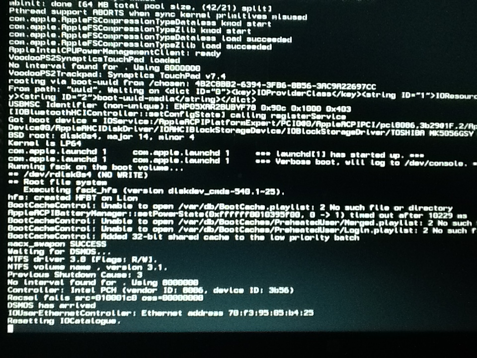

Jugz Posted January 11, 2012 Share Posted January 11, 2012 Hello Insanelymac community, I present you guys with a very strange occurance when I installed Lion using the latest iAtkos build (L2). Installation went fine with the boot flags: PCIRootUID=0 GraphicsEnabler=Yes cpus=1 -v After install, I booted into my Lion partition with the following flags: PCIRootUID=0 cpus=1 GraphicsEnabler=Yes -v I got this far (see pic): After about 5 minutes on this screen, (to my knowledge) the Lion Welcome music started playing. It was a jazzy funk type of song. It lasted roughly 4 minutes with the screen above STILL SHOWING. Has anyone else had this problem? How can I actually boot into Lion? Thanks. -Jugz Link to comment https://www.insanelymac.com/forum/topic/274494-iatkos-l2-installed-black-screen-with-music/ Share on other sites More sharing options...

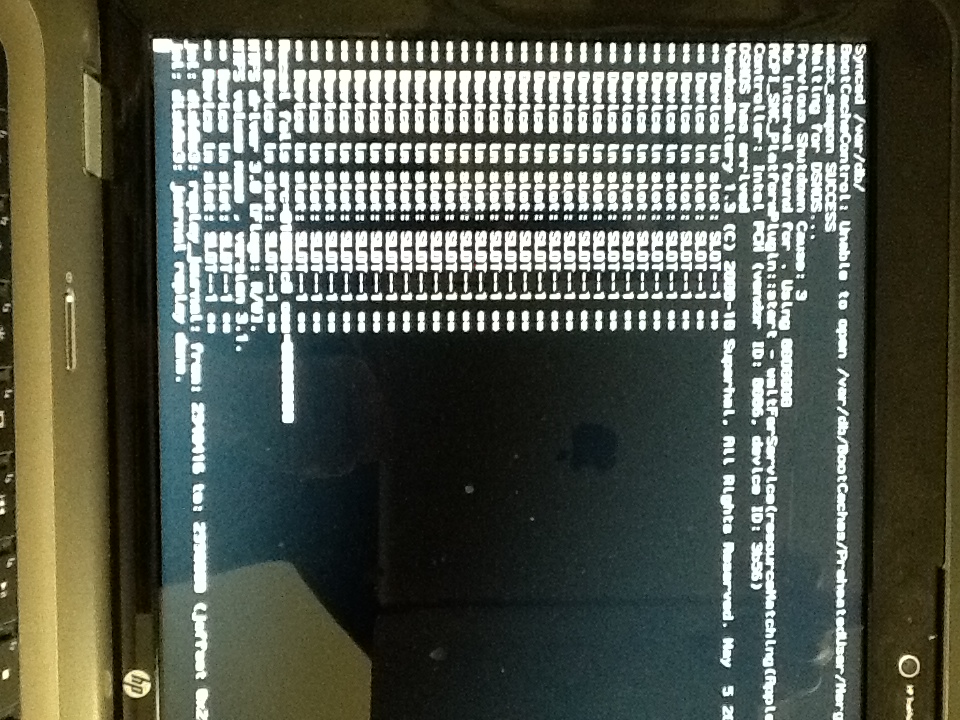

Jugz Posted January 20, 2012 Author Share Posted January 20, 2012 Okay. Since I have Snow Leopard on another partition, I simply installed the 4 ATI kexts that I needed with my card info in the Info.plist. I then repaired permissions on my drive and shutdown, then rebooted into my Lion partition.. Unfortunately, all I got was this: Back to my ORIGINAL ISSUE found here: http://www.insanelymac.com/forum/index.php?showtopic=272168&st=0&p=1770781entry1770781 So, I guess I'm stuck. I knew this was going to happen because of my graphics card AND having switchable graphics... Anyone have another option or maybe possibly I am doing something else wrong? Thanks InsanelyMac community, -Jugz Link to comment https://www.insanelymac.com/forum/topic/274494-iatkos-l2-installed-black-screen-with-music/#findComment-1787957 Share on other sites More sharing options...

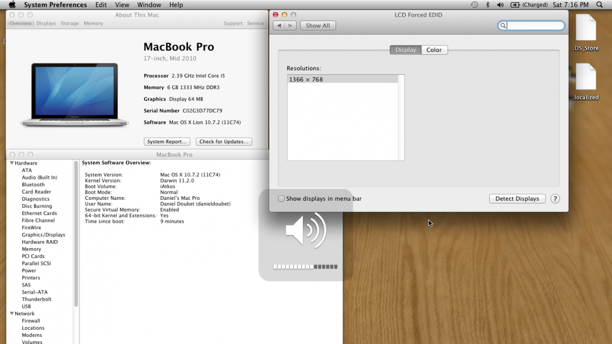

Jugz Posted January 22, 2012 Author Share Posted January 22, 2012 SOLVED!!!!!!!!!!!!!!!!!!!!!!!!!!!!!!!!!!!!!!!!!!!!!!!!!!!!! If I got my head out of my **** and listened to a few of you guys, I would have done much better years ago. So, this is how I got it to work: 1. Installed iAtkos L2 on my "iAtkos" partition. 2. Booted into Snow Leopard partition. 3. Deleted every graphics kext I could find. 4. Shut down. 5. Booted into iAtkos. 6. Welcome video! I love you guys... So excited and overjoyed. (Gonna worry about graphics later ) PIC: Some nebbish things: SMBIOS is custom made to: 6,1 MacBookPro org.chameleon.Boot.plist: Boot Graphics=Yes DSDT=/Extra/dsdt.aml DropSSDT=Yes GenerateCStates=Yes GeneratePStates=Yes EthernetBuiltIn=Yes Graphics Mode=1366x768x32 Kernel=mach_kernel Kernel Flags=npci=0x2000 PCIRootUID=0 SMBIOS=/Extra/SMBios.plist SystemType=2 Timeout=5 npci=0x2000 Link to comment https://www.insanelymac.com/forum/topic/274494-iatkos-l2-installed-black-screen-with-music/#findComment-1788271 Share on other sites More sharing options...
