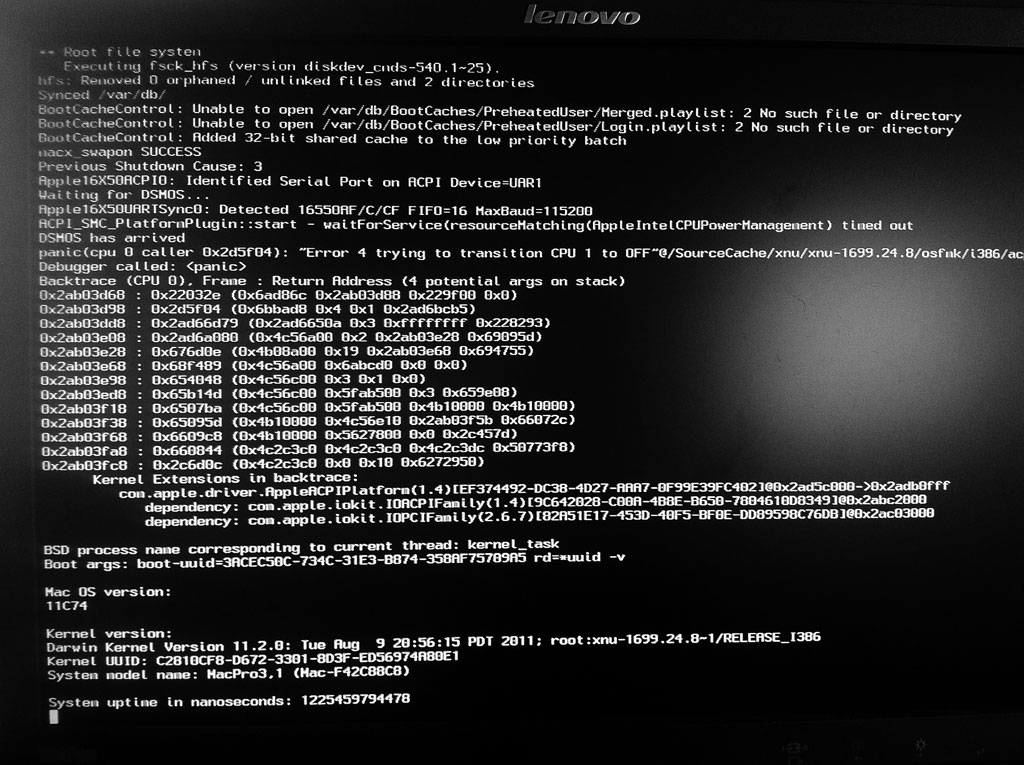

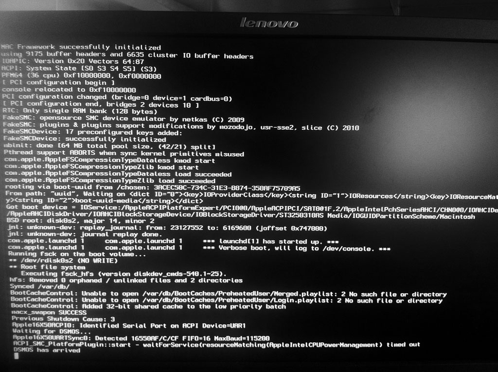

adickers Posted December 12, 2011 Share Posted December 12, 2011 Greetings - I have been handed a Lenovo M90 desktop with the challenge of installing OSX. This is a stock Lenovo desktop machine: - Core 2 Duo i5 660 - Integrated Intel Video controller (64mb - 8086:0042) - SATA Controller (AHCI) - on-board Audio - on-board ethernet (82578DM Gigabit) I am using iATKOS L2, and I can boot to the installer, change options, and the install completes successfully - no issues, no kernel panics, no hangs, and I can even use the utils during install to wipe drives, and get system info. However, on post boot install, I see these issues: BootCacheControl: Unable to open /var/db/BootCaches/..../<Merged.playlist BootCacheControl: Unable to open /var/db/BootCaches/..../Login.playlist ... ACPI_SMC_PlatformPlugin::start - waitForService(resrouceMatching(AppleIntelCPUPowerManagement) timed out DSMOS has arrived after about 15 mins - IOSCatalogue resetting So here's my general question: if I can get into the installer, and that GUI runs fine, and it can see my HD just fine - is there a way to circumvent whatever issues are occurring here stemming from power management, or video card so I can get to the desktop? THIS JUST IN - I was going to reboot the system and get an image of the BIOS screen, so I pressed and held down power and got this Kernel Panic: You guys know more than - what do you think? Another quick update: I've tried butt-basic installs with no drivers, just main system, and VGA - with the same results... Link to comment https://www.insanelymac.com/forum/topic/273430-cant-get-to-gui-after-install-on-lenovo-desktop-m90/ Share on other sites More sharing options...

artur_pt Posted September 4, 2013 Share Posted September 4, 2013 hello delete from system/library/extensions or move all appleintelhd*.* boot -f -v GraphicsEnabler=No to move the kext -s fsck -fy mount -uw / mkdir /intelhd_backup cd /System/Library/Extensions mv AppleIntelHD* AppleIntelSNB* /intelhd_backup reboot this solution is for notebooks .. don't know if it work in a desk.. anyway by a cheap graphics card and u problems gonne.. like nvidia gt620 http://www.insanelymac.com/forum/topic/286092-guide-1st-generation-intel-hd-graphics-qeci/ good hack Link to comment https://www.insanelymac.com/forum/topic/273430-cant-get-to-gui-after-install-on-lenovo-desktop-m90/#findComment-1943332 Share on other sites More sharing options...
