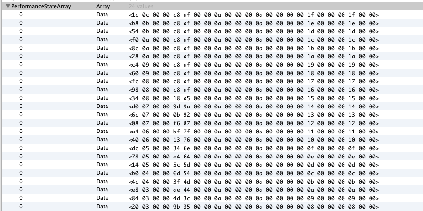

Mohamed Khairy Posted April 25, 2012 Author Share Posted April 25, 2012 hi again i made SSDT.aml for my cpu and you will need to make one for you to generate many pstates that will make your cpu not to jump in use so this will make your cpu less power consumation you refer here to see how to do it i can't do ssdt for every user but every one can share him one http://www.insanelym...c=258611&st=460 and here is my ssdt table generate 22 pstate from 8 to 29 turbo if your cpu is 2.3 and it is turbo 2.9 you can use it directly and if your cpu isn't like that you need to edit it SSDT.aml.zip Link to comment https://www.insanelymac.com/forum/topic/271573-guide-dell-inspiron-n5110/page/15/#findComment-1815983 Share on other sites More sharing options...
Bandee Posted April 25, 2012 Share Posted April 25, 2012 Great! I knew it! But I'm not familiar in dsdt editing. I will try when I'm back to my hack. Need for SSDT drop or not? Link to comment https://www.insanelymac.com/forum/topic/271573-guide-dell-inspiron-n5110/page/15/#findComment-1816017 Share on other sites More sharing options...
Mohamed Khairy Posted April 25, 2012 Author Share Posted April 25, 2012 Great! I knew it! But I'm not familiar in dsdt editing. I will try when I'm back to my hack. Need for SSDT drop or not? it is easy just understand what do you do you need to DropSSDT here is a simple idea of this thing first to calculate your needed pstates my cpu min frequency is 800 and highest turbo 2900 so multi per is 8 --> 29 now calculate it / 29-8 =21 --> +1=22 pstates now my pstates is 22 mean that i need 22 one like this Package (0x06) { 0x0B54, 0x88B8, 0x6E, 0x0A, 0x83, Zero }, but with different value according to freq you will do your edit under this two arry Name (SPSS, Package (0x16) Name (_PSS, Package (0x16) 0x16 means 22 on dec use calculator for this and below every one is 22 Pstate and after you calculate your number now you will apply your cpu setting nearly every intel cpu on notebook begin with 800 hz so it will be easy to use my ssdt and do minimal ssdt edit will give example about core i3 with 2.3 mhz pstates needed 23-8= 15 --> +1 = 16 so what will i do on ssdt will delete 6 pstates and renumbering only will delete first 6 state under every array as i told before so Name (SPSS, Package (0x10) --> 10 means 16 state will begin with Package (0x06) { 0x08FC, --> is 2300 on on dec 0x88B8, 0x6E, 0x0A, 0x0683, --> 06 will be 00 as it will be the first state you will renumber all state from zero to 0f 0x06 --> as above }, and Name (_PSS, Package (0x10) will begin with Package (0x06) { 0x08FC, 0x88B8, 0x0A, 0x0A, 0x1700, --> 17 mean 23 on dec means multi per of freq no need to edit 0x1700 --> as above }, etc if your top freq is 3000 so you will have 23 state you will need to add new state on start of state with 3000 freq sorry iam so sick and can't go more on explanation hope you got the idea Link to comment https://www.insanelymac.com/forum/topic/271573-guide-dell-inspiron-n5110/page/15/#findComment-1816068 Share on other sites More sharing options...
Avell Posted April 25, 2012 Share Posted April 25, 2012 hi again i made SSDT.aml for my cpu and you will need to make one for you to generate many pstates that will make your cpu not to jump in use so this will make your cpu less power consumation you refer here to see how to do it i can't do ssdt for every user but every one can share him one http://www.insanelym...c=258611&st=460 and here is my ssdt table generate 22 pstate from 8 to 29 turbo if your cpu is 2.3 and it is turbo 2.9 you can use it directly and if your cpu isn't like that you need to edit it SSDT.aml.zip Hello. I use your SSDT and TurboBoost works. My config: Mac OS X Lion 10.7.1 Dell R15 N5110 Core: i7 2630QM GPU: Intel HD 3000 + Nvidia GeForce 525M Dell Wireless 1702 Link to comment https://www.insanelymac.com/forum/topic/271573-guide-dell-inspiron-n5110/page/15/#findComment-1816081 Share on other sites More sharing options...
radiking Posted April 25, 2012 Share Posted April 25, 2012 i don t advise you to use his coz turbo ratios are different and also frequencies so u might damage your cpu.i m not sure but possibilities are many http://www.insanelymac.com/forum/index.php?showtopic=273500 just download 10.7.2 Dell XPS 17 L702x Kexts.rar from here and u inside there is a ssdt.aml file u can use that coz his cpu and ours is same Link to comment https://www.insanelymac.com/forum/topic/271573-guide-dell-inspiron-n5110/page/15/#findComment-1816100 Share on other sites More sharing options...
Mohamed Khairy Posted April 25, 2012 Author Share Posted April 25, 2012 i am happy to see it works for you may will make one for 3000 kHz and 3100 kHz i don t advise you to use his coz turbo ratios are different and also frequencies so u might damage your cpu.i m not sure but possibilities are many http://www.insanelym...howtopic=273500 just download 10.7.2 Dell XPS 17 L702x Kexts.rar from here and u inside there is a ssdt.aml file u can use that coz his cpu and ours is same who said that ? on mac os x the pstates grow with 100 kHz for every pstates means 800 , 900 , 1000, 1100 , 1200 ............................. 2700 , 2800 , 2900 and here is the state of macbookpro 8.2 with Intel® Core i7-2675QM CPU @ 2.20GHz the ssdt just tell mac to use from 800 to ...... top of your cpu and top of his cpu is 2.9 so he can use mine one about ssdt on second code 0x88B8, can be rested to 0x0000 --------------------- even the ssdt you linked is for 2670qm that came with top 3100 !!! and your processor to is 2900 !! Link to comment https://www.insanelymac.com/forum/topic/271573-guide-dell-inspiron-n5110/page/15/#findComment-1816101 Share on other sites More sharing options...
