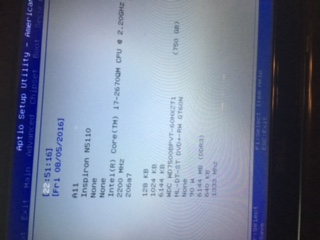

David Eklove Posted August 6, 2016 Share Posted August 6, 2016 Cannot boot from usb on this laptop. Have modified bios and flash drive works perfectly on desktop. Any help appreciated. Laptop is Dell Inspiron N5110 with Intel only graphics. Thanks in advance for any help. Link to comment https://www.insanelymac.com/forum/topic/271573-guide-dell-inspiron-n5110/page/116/#findComment-2262472 Share on other sites More sharing options...
