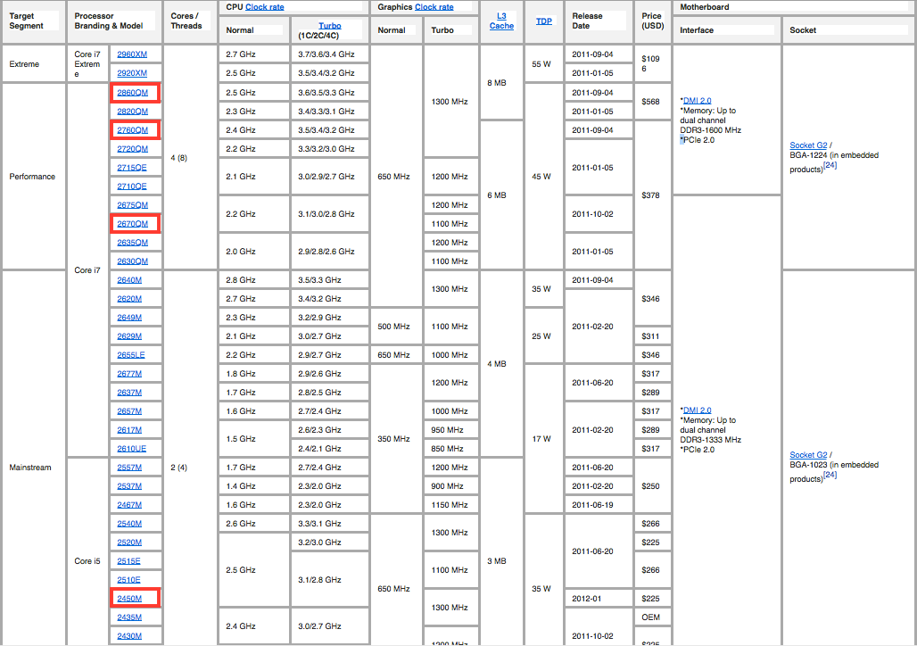

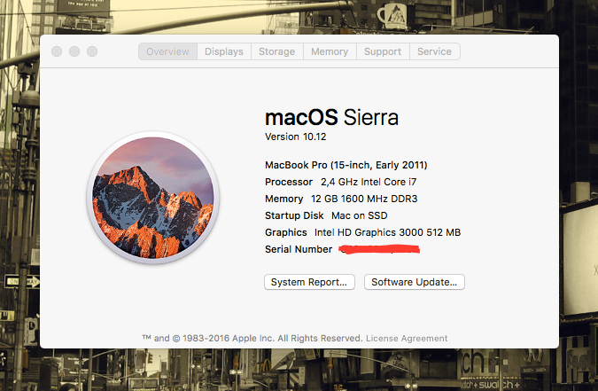

I upgraded my dell Inspiron n5110, replaced all parts by myself.
from i5-2450M to i7-2760QM
from 6gb RAM to 12 GB RAM (8GB 1600mhz + 4GB 1333mhz)
from 500gb hdd to 256gb Samsung 850 PRO SSD + 500 gb hdd.
And its like a new MacBook Pro right now. (without graphics card, who cares though. only the most expensive MacBook Pro model has a graphics card).
the only downside is the laptop now requires 130W dell adaptor as before boot up, bios warning indicates that.
and intel hd 3000 doesn't perform very well.
And if I can keep this laptop little bit more cooler than I think I can see 3.5ghz turbo boosted frequency.
At most I could see 3.37ghz on one core for a second till now. System overall runs around 50-60C and max 75-80C while stress test(I run it for 30mins).
If anyone thinking about upgrading hardware, I can help.

CPU general information for upgrading/replacing
- CPU must be 2nd generation mobile processor.
- Generally i5 processors are using 35W, but i7s are using 45W. Take this into consideration as it consumes more power so drains the battery.
- 130W adapter is dell recommended with i7 CPUs since i7s consume more power. But 90W works well. (90W adapter is the default with i5 n5110s, I don't know about i3s.)
- Motherboard must support the CPU. (Dell Inspiron n5110 supports most of it. I saw people are upgraded to even 2860qm, I don't know xm processor compatibility though, since they use 55w)
- Custom BIOS may be handful for fine tuning.
Here is the list of 2nd gen i5-i7 mobile CPU list
Red rectangled ones are the ones that i heard from people they made it work on dell Inspiron n5110. And also I used i5-2450m and i7-2760qm on my n5110.

I am successful in installing Sierra GM using Clover UEFI method using latest Clover from sourceforge. Thanks to Dr. Hurt for kexts and Thanks again now my laptop's CPU fan is silent..I will share my clover directory later in the day. I have changed config.plist a little.
Is it possible to load kext for BCM4352, if anybody has done that before?
Did you install clover EFI in the EFI partition? share how you do that please :)
