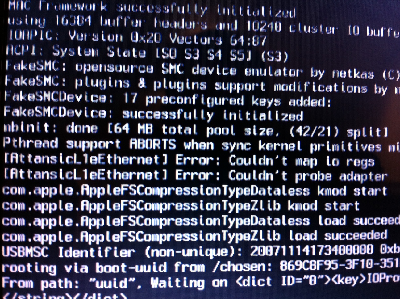

The Windows Tweaker Posted October 25, 2011 Share Posted October 25, 2011 Hello once again! I've successfully updatet to Mac OS X 10.7.2 and the system runs fast and stable. The only problem is the ethernet card. I have atheros network card which isn't supported. Because the system can't find an ethernet card i think this is the reason that the Mac AppStore, iCloud and FaceTime aren't working. Is that correct? Is there a way to work around it? These are the specs of my notebook: Acer 6930G-594G64mn Mac OS X 10.7.2 Core2Duo T5900 2.2GHz nVidia GeForce 9600M GS 512 MB 4GB DDR2 667 MHz 320GB HDD (2x160) 07:00.0 Network controller [0280]: Broadcom Corporation BCM4312 802.11b/g [14e4:4315] (rev 01) 09:00.0 Ethernet controller [0200]: Attansic Technology Corp. L1 Gigabit Ethernet Adapter [1969:1026] (rev b0) i've used a valid serial in SMBIOS.plist. I dont know how to make a DSDT for my notebook, so i haven't tried that. Looking forward for you idea's Link to comment https://www.insanelymac.com/forum/topic/271028-looking-for-fix-for-mac-app-store-icloud-and-facetime/ Share on other sites More sharing options...

The Windows Tweaker Posted October 29, 2011 Author Share Posted October 29, 2011 if it's BCM, we may solve it with EFI string but i had the L1 kext for a while with my BCM and didn't had problems what happen when you try to install this Kext? I get this error: Link to comment https://www.insanelymac.com/forum/topic/271028-looking-for-fix-for-mac-app-store-icloud-and-facetime/#findComment-1765689 Share on other sites More sharing options...
Noam AA Posted October 29, 2011 Share Posted October 29, 2011 have you tried this one? it's saying it support your laptop 6930G http://www.insanelymac.com/forum/index.php?showtopic=140907 but anyway, lets check something, go to /Library/Preferences/SystemConfiguration/NetworkInterfaces.plist locate your WI-Fi card, and find if IOBuiltin=Yes or No Link to comment https://www.insanelymac.com/forum/topic/271028-looking-for-fix-for-mac-app-store-icloud-and-facetime/#findComment-1765703 Share on other sites More sharing options...
