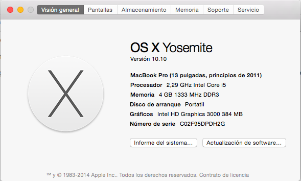

Claudio A. Posted October 23, 2014 Share Posted October 23, 2014 I've managed to installed 10.10 and it seems to be working great. Steps (this is not a detailed guide ): Prepared usb installer (using www.insanelymac.com/forum/topic/280756-guide-the-all-in-one-guide-to-vanilla-os-x-including-chameleon-dsdt-for-beginners-updated-for-yosemite/). It was a little more complicated than usual because extracting the kernel file required a specific version of pacifist). Chameleon Enoch R2403 @alianyn dsdt Patched installer to install on mbr. Removed Nvidia Kexts. Usual kexts for a 10.10 usb installer (NullCPUPowerManagement, etc) Results: Sound: was not working ok:, so I needed to install voodohda. Is not working perfect but is good enough. Battery: Worke with https://github.com/RehabMan/OS-X-ACPI-Battery-Driver. Wifi: Was not working initially, so I needed to add device id in AirPortAtheros40.kext/Contents/Info.plist Power management: used ssdtPRGen to generate SSDT, DropSSDT=yes, GenerateCStates=No, GeneratePStates=No, removed NullCPUPowerManagement.kext.zip. Everything seems to be working ok, but I feel that the cpus are too hot, something like 60C idle... Any hints on how to verify if this is working correctly? Link to comment https://www.insanelymac.com/forum/topic/270686-asus-u36sd-a-few-dsdt-questions/page/6/#findComment-2074593 Share on other sites More sharing options...
