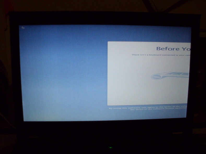

Playgame38 Posted March 7, 2012 Share Posted March 7, 2012 I received this right after installing OSX Lion 10.7.3 and rebooting. I do not have an external keyboard ATM. Any recommendations? Link to comment https://www.insanelymac.com/forum/topic/268280-guide-thinkpad-t420-with-mountain-lion/page/2/#findComment-1804208 Share on other sites More sharing options...
nvrmore100 Posted March 7, 2012 Share Posted March 7, 2012 Boot back into the installer, and follow what I put in my post: # vi /Volumes/<osx install>/System/Library/CoreServices/Setup\ Assistant.app/Contents/Info.plist Delete: <string>DeviceSection</string> <string>KeyboardTypeSection</string> Reboot. HOWEVER you will need to have the PS2 kexts installed on the OSX install as well. I would suggest you put them on your USB you are booting with under /Extra/Extensions. If you have already done that, and you can type/move your mouse, you should be set. Also, it looks like you didn't try the DSDT's posted to the thread either, since you have the screen resolution that’s going off screen. Try the one on the main post, and there is also another one later in another thread (although it didn't work for me). If you get it to display properly, but get slow video when doing large amounts of display changes, then remove the kexts I suggested. 1 Link to comment https://www.insanelymac.com/forum/topic/268280-guide-thinkpad-t420-with-mountain-lion/page/2/#findComment-1804212 Share on other sites More sharing options...
Playgame38 Posted March 8, 2012 Share Posted March 8, 2012 Thanks that worked! A couple things though. Still no sound. I have the VooDoo kext but cannot load it via kextload. Another thing is that when I am on Youtube the video will play, but an image will not appear. Thanks for your help! Link to comment https://www.insanelymac.com/forum/topic/268280-guide-thinkpad-t420-with-mountain-lion/page/2/#findComment-1804226 Share on other sites More sharing options...
