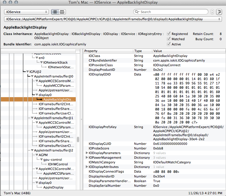

tluck Posted November 26, 2013 Share Posted November 26, 2013 wow. that is one messed up EDID. does not conform??? can you run Utility IOregistryExplorer to grab your display? post this shot... Link to comment https://www.insanelymac.com/forum/topic/268280-guide-thinkpad-t420-with-mountain-lion/page/16/#findComment-1971770 Share on other sites More sharing options...
honeywell Posted November 26, 2013 Share Posted November 26, 2013 Will do - may take a bit since I don't have Xcode installed yet I must download it first. Will report back soon. Link to comment https://www.insanelymac.com/forum/topic/268280-guide-thinkpad-t420-with-mountain-lion/page/16/#findComment-1971778 Share on other sites More sharing options...
tluck Posted November 26, 2013 Share Posted November 26, 2013 thats ok - no need to install it. - just wanted to see what OSX is making out of your display. do you still have an 10.8.x install? it would be good to compare in the mean time, to make display override to get the display to the proper display size - just need the vendor and product ID it thinks your display is... run this: ioreg -l |grep DisplayProduct ioreg -l |grep DisplayVendor Link to comment https://www.insanelymac.com/forum/topic/268280-guide-thinkpad-t420-with-mountain-lion/page/16/#findComment-1971780 Share on other sites More sharing options...

tluck Posted November 27, 2013 Share Posted November 27, 2013 @honeywell - see if this will fix your resolution. cd to /System/Library/Displays/Overrides mv DisplayVendorID-756e6b6e to DisplayVendorID-756e6b6e.orig unzip and drop the new folder in its place. it defines resolutions up to 1600x900. reboot DisplayVendorID-756e6b6e.zip Link to comment https://www.insanelymac.com/forum/topic/268280-guide-thinkpad-t420-with-mountain-lion/page/16/#findComment-1971825 Share on other sites More sharing options...

honeywell Posted November 27, 2013 Share Posted November 27, 2013 Wow, this is tragic! That last one made my screen resolution correct, but I am getting graphics hangs everywhere. So close once again. Here's what switchresX looks like: I am unable to apply a 1600x900 resolution Also, this is what the exported EDID from SRX looks like: EDID report generated by SwitchResX Version 4.3.5 (Intel - 64-bit) for display Lenovo LCD ----------------------------------------------------- ------------------- RAW DATA ------------------------ ----------------------------------------------------- 0 1 2 3 4 5 6 7 8 9 A B C D E F ----------------------------------------------------- 0 | 00 73 64 6E 07 AE 2C AE 70 74 61 6C 28 00 00 00 1 | 17 00 00 00 00 00 00 00 30 65 3A D7 00 00 00 00 2 | A8 86 BF D8 00 00 00 00 70 74 61 6C 48 00 00 00 3 | DE A2 ED A2 5A A3 64 A3 9B A3 E6 A3 F3 A3 05 A4 4 | 15 A4 21 A4 2E A4 3B A4 4A A4 65 A4 6F A4 7C A4 5 | 8F A4 9C A4 B3 A4 C9 A4 D6 A4 ED A4 03 A5 10 A5 6 | 27 A5 3D A5 4A A5 61 A5 70 68 64 30 28 00 00 00 7 | 04 00 00 00 00 00 00 00 98 F4 20 D6 00 00 00 00 ----------------------------------------------------- < 0073646E 07AE2CAE 7074616C 28000000 17000000 00000000 30653AD7 00000000 A886BFD8 00000000 7074616C 48000000 DEA2EDA2 5AA364A3 9BA3E6A3 F3A305A4 15A421A4 2EA43BA4 4AA465A4 6FA47CA4 8FA49CA4 B3A4C9A4 D6A4EDA4 03A510A5 27A53DA5 4AA561A5 70686430 28000000 04000000 00000000 98F420D6 00000000 > ----------------------------------------------------- { 0x00, 0x73, 0x64, 0x6E, 0x07, 0xAE, 0x2C, 0xAE, 0x70, 0x74, 0x61, 0x6C, 0x28, 0x00, 0x00, 0x00, 0x17, 0x00, 0x00, 0x00, 0x00, 0x00, 0x00, 0x00, 0x30, 0x65, 0x3A, 0xD7, 0x00, 0x00, 0x00, 0x00, 0xA8, 0x86, 0xBF, 0xD8, 0x00, 0x00, 0x00, 0x00, 0x70, 0x74, 0x61, 0x6C, 0x48, 0x00, 0x00, 0x00, 0xDE, 0xA2, 0xED, 0xA2, 0x5A, 0xA3, 0x64, 0xA3, 0x9B, 0xA3, 0xE6, 0xA3, 0xF3, 0xA3, 0x05, 0xA4, 0x15, 0xA4, 0x21, 0xA4, 0x2E, 0xA4, 0x3B, 0xA4, 0x4A, 0xA4, 0x65, 0xA4, 0x6F, 0xA4, 0x7C, 0xA4, 0x8F, 0xA4, 0x9C, 0xA4, 0xB3, 0xA4, 0xC9, 0xA4, 0xD6, 0xA4, 0xED, 0xA4, 0x03, 0xA5, 0x10, 0xA5, 0x27, 0xA5, 0x3D, 0xA5, 0x4A, 0xA5, 0x61, 0xA5, 0x70, 0x68, 0x64, 0x30, 0x28, 0x00, 0x00, 0x00, 0x04, 0x00, 0x00, 0x00, 0x00, 0x00, 0x00, 0x00, 0x98, 0xF4, 0x20, 0xD6, 0x00, 0x00, 0x00, 0x00, } ----------------------------------------------------- Invalid EDID block: checksum failed. Last byte should be 0A ----------------------------------------------------- ------------------- MAIN EDID BLOCK ----------------- ----------------------------------------------------- EDID Version........0.0 Manufacturer........\CT Product Code........24940 (616C) (6C61) Serial Number.......00000028 Manufactured........Week 23 of year 1990 Gamma...............1.00 Display Supported Features: --------------------------- Power Management: Active off Display type: ------------- Non RGB color display Display is non continuous frequency Default color space is not sRGB standard Input signal & sync: -------------------- Analog input with: 0.700V / 0.300V Color info: ----------- Red x = 0.841 Green x = 0.001 Blue x = 0.000 White x = 0.525 Red y = 0.002 Green y = 0.001 Blue y = 0.659 White y = 0.748 Established Timings: -------------------- 720 x 400 @ 70Hz 720 x 400 @ 88Hz 640 x 480 @ 67Hz 640 x 480 @ 72Hz Manufacturer Reserved Timings: ------------------------------ Standard Timing Identification: ------------------------------- #1: 1144 x 858 @ 112Hz (7074) #2: 1024 x 768 @ 104Hz (616C) #3: 824 x 515 @ 60Hz (4800) #5: 2024 x 1619 @ 94Hz (DEA2) #6: 2144 x 1715 @ 94Hz (EDA2) #7: 968 x 774 @ 95Hz (5AA3) Monitor Description blocks: --------------------------- Descriptor #0 - Timing definition: Mode = 3739 x 2723 @ 20.599Hz Pixel Clock............. 418.28 MHz Interlaced Horizontal Vertical Active.................. 3739 pixels 2723 lines Front Porch............. 517 pixels 17 lines Sync Width.............. 676 pixels 5 lines Back Porch.............. 506 pixels 989 lines Blanking................ 1699 pixels 1011 lines Total................... 5438 pixels 3734 lines Scan Rate............... 76.918 kHz 20.599 Hz Image Size.............. 545 mm 3748 mm Border.................. 164 pixels 59 lines Seq Stereo (Rt. Sync = 1) Sync: Analog composite with Sync on green serrate Descriptor #1 - Timing definition: Mode = 1637 x 2724 @ 19.256Hz Pixel Clock............. 420.58 MHz Interlaced Horizontal Vertical Active.................. 1637 pixels 2724 lines Front Porch............. 655 pixels 25 lines Sync Width.............. 676 pixels 12 lines Back Porch.............. 2673 pixels 1111 lines Blanking................ 4004 pixels 1148 lines Total................... 5641 pixels 3872 lines Scan Rate............... 74.558 kHz 19.256 Hz Image Size.............. 3251 mm 2468 mm Border.................. 164 pixels 214 lines Seq Stereo (Rt. Sync = 1) Sync: Analog composite with Sync on green serrate Descriptor #2 - Timing definition: Mode = 259 x 2725 @ 246.236Hz Pixel Clock............. 422.21 MHz Non-Interlaced Horizontal Vertical Active.................. 259 pixels 2725 lines Front Porch............. 573 pixels 20 lines Sync Width.............. 677 pixels 26 lines Back Porch.............. -1085 pixels 1273 lines Blanking................ 165 pixels 1319 lines Total................... 424 pixels 4044 lines Scan Rate............... 995.778 kHz 246.236 Hz Image Size.............. 1889 mm 165 mm Border.................. 104 pixels 100 lines Seq Stereo (Rt. Sync = 1) Sync: Digital composite with Negative polarity Descriptor #3 - Timing definition: Mode = 0 x 0 @ infHz Pixel Clock............. 0.40 MHz Non-Interlaced Horizontal Vertical Active.................. 0 pixels 0 lines Front Porch............. 0 pixels 0 lines Sync Width.............. 0 pixels 0 lines Back Porch.............. 1024 pixels 0 lines Blanking................ 1024 pixels 0 lines Total................... 1024 pixels 0 lines Scan Rate............... 0.391 kHz inf Hz Image Size.............. 664 mm 244 mm Border.................. 214 pixels 0 lines Sync: Analog composite with Sync on green Perhaps this is the manufacturers fault? Link to comment https://www.insanelymac.com/forum/topic/268280-guide-thinkpad-t420-with-mountain-lion/page/16/#findComment-1971870 Share on other sites More sharing options...
honeywell Posted November 27, 2013 Share Posted November 27, 2013 I did create a profile with 1600x900 but it doesn't show up in Sys Preferences -> Display -> Scaled, and it doesn't seem to apply when I reboot after adding it to ResX. It disappears from Custom Resolutions when I reboot after adding it. Link to comment https://www.insanelymac.com/forum/topic/268280-guide-thinkpad-t420-with-mountain-lion/page/16/#findComment-1971878 Share on other sites More sharing options...
honeywell Posted November 27, 2013 Share Posted November 27, 2013 Wow tluck, I don't believe it - that last EDID worked. Graphics hangs appear to be gone and the resolution is correct. What did you change? And thanks once again for everything! Link to comment https://www.insanelymac.com/forum/topic/268280-guide-thinkpad-t420-with-mountain-lion/page/16/#findComment-1971881 Share on other sites More sharing options...
