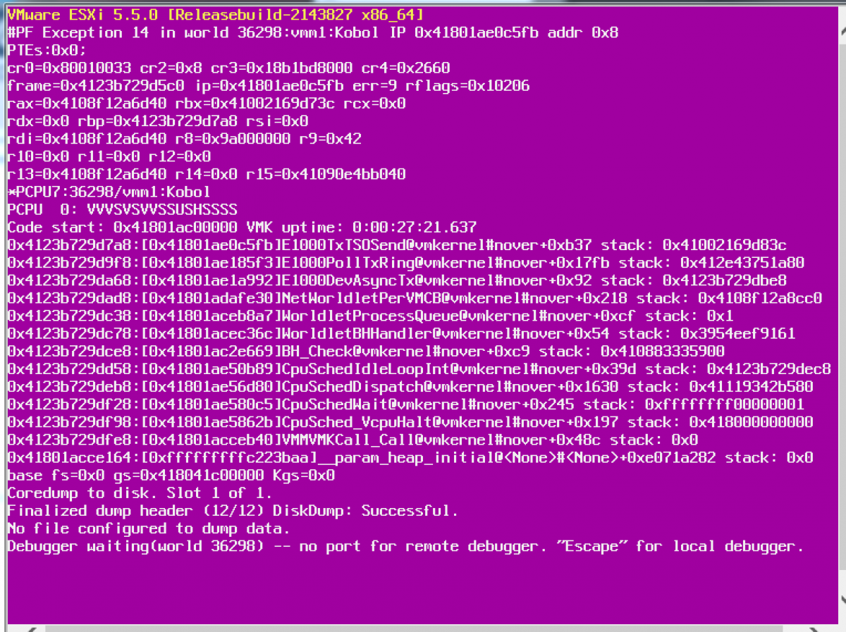

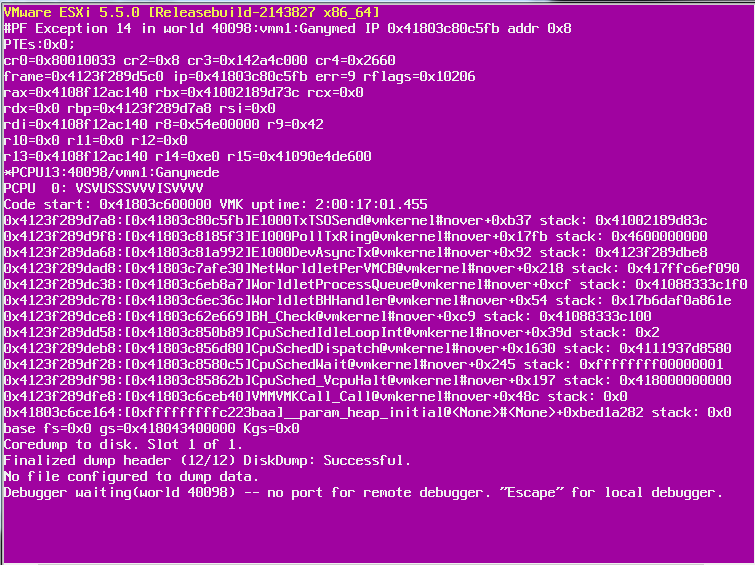

Dentyne Posted October 30, 2014 Share Posted October 30, 2014 Working (somewhat) for me on Yosemite. I was running 10.10 under ESXi 5.5u2, but getting some PSODs. I upgraded to latest patch (ESXi550-201410001), but the crashes seemed to get works (see attachments). The crashes area all in E1000TX and seem to only occur when the OSX vm is running (although the crash happens when the OSX vm is not running). I've moved to E1000E nics and have been running stably overnight. Thanks for your efforts - any plans for a vCenter patch to enable management of patched ESXi hosts? Dent Link to comment https://www.insanelymac.com/forum/topic/267296-esxi-5-mac-os-x-unlocker/page/32/#findComment-2078624 Share on other sites More sharing options...
