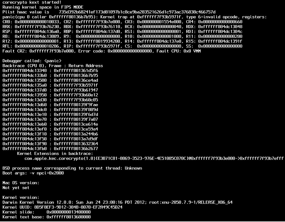

Jeff Risdon Posted February 28, 2013 Share Posted February 28, 2013 Hi Donk... I cold power cycled my 2950 II and the same thing happened. I did exactly what I did on the Dell XPS 420 which worked, on the 2950 and it had the same results Perhaps a different cpu? Or maybe the Dell 2950 II hardware just isnt compatible...dunno. I did run this though: I got back a 3 which tells me that VT is enabled in the bios and can be used.... Thanks for all your work Donk!! Run this command: # esxcfg-info|grep "HV Support" The output of the HV Support command indicates the type of Hyper-visor support available. These are the descriptions for the possible values: 0 - VT/AMD-V indicates that support is not available for this hardware. 1 - VT/AMD-V indicates that VT or AMD-V might be available but it is not supported for this hardware. 2 - VT/AMD-V indicates that VT or AMD-V is available but is currently not enabled in the BIOS.3 - VT/AMD-V indicates that VT or AMD-V is enabled in the BIOS and can be used. been looking around the net for answers...does EPT need to be available for this to work? Thanks! Link to comment https://www.insanelymac.com/forum/topic/267296-esxi-5-mac-os-x-unlocker/page/18/#findComment-1893004 Share on other sites More sharing options...
Donk Posted February 28, 2013 Author Share Posted February 28, 2013 does EPT need to be available for this to work? Thanks! Nope should just need VT-x. I am wondering if xnu kernal doesn't like the CPU. Try masking it using this: cpuid.1.eax = "0000:0000:0000:0001:0000:0110:1010:0101" Needs to be VMX file, or through the advanced Guest options dialog. http://www.insanelymac.com/forum/topic/232183-snow-leopard-on-vmware-and-disabled-cpu-error/ Link to comment https://www.insanelymac.com/forum/topic/267296-esxi-5-mac-os-x-unlocker/page/18/#findComment-1893029 Share on other sites More sharing options...

Jeff Risdon Posted March 1, 2013 Share Posted March 1, 2013 (edited) Hi Donk, Yeah tried putting cpuid.1.eax = "0000:0000:0000:0001:0000:0110:1010:0101" in the VMX file and boot using -v npci=0x2000 and now get the following. Im begining to think its the CPU Edited March 1, 2013 by Jeff Risdon Link to comment https://www.insanelymac.com/forum/topic/267296-esxi-5-mac-os-x-unlocker/page/18/#findComment-1893117 Share on other sites More sharing options...
Donk Posted March 1, 2013 Author Share Posted March 1, 2013 Hi Donk, Yeah tried putting cpuid.1.eax = "0000:0000:0000:0001:0000:0110:1010:0101" in the VMX file and boot using -v npci=0x2000 and now get the following. Im begining to think its the CPU You are right, it looks like the CPU is too old or something is missing, as the trap is for invalid opcode. Link to comment https://www.insanelymac.com/forum/topic/267296-esxi-5-mac-os-x-unlocker/page/18/#findComment-1893162 Share on other sites More sharing options...
Jeff Risdon Posted March 1, 2013 Share Posted March 1, 2013 Hi Donk, Yeah been doing some research on this and Im gonna get a couple of x5355 quad cores which will work fine on my 2950. There cheap out there if you look around. The x5355 also was used in some of Apple's MAC towers. Ill report back once I get them and let ya know Thanks for all your help! Link to comment https://www.insanelymac.com/forum/topic/267296-esxi-5-mac-os-x-unlocker/page/18/#findComment-1893289 Share on other sites More sharing options...

Jeff Risdon Posted March 9, 2013 Share Posted March 9, 2013 Hi All... Just got my X5355 quad core cpu's and put them into my Dell 2950 II and BAM! It all works fine with no problems at all....OSX booted right up and the install was a breeze So it was the Xeon 5050 CPU's that were the culprit. Thanks Donk for all your hard work and support! Link to comment https://www.insanelymac.com/forum/topic/267296-esxi-5-mac-os-x-unlocker/page/18/#findComment-1895417 Share on other sites More sharing options...
