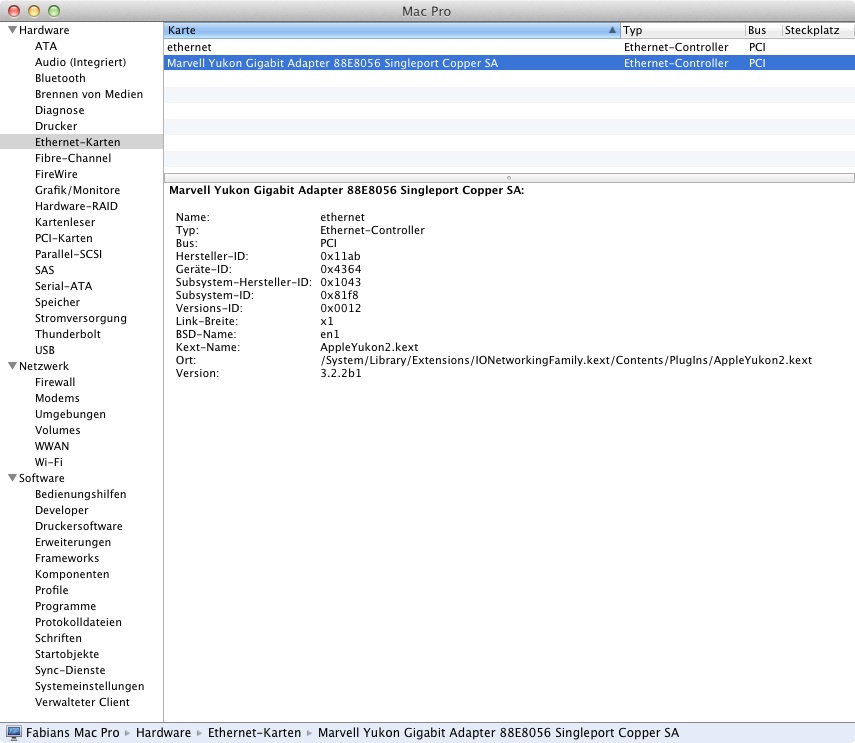

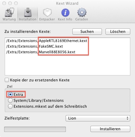

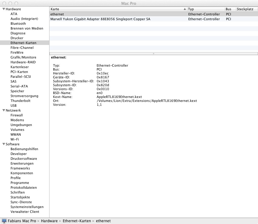

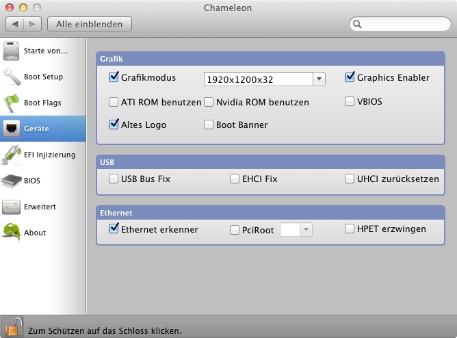

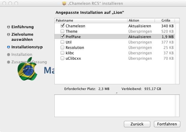

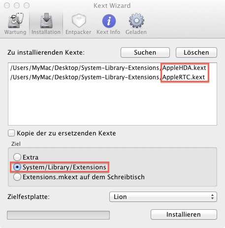

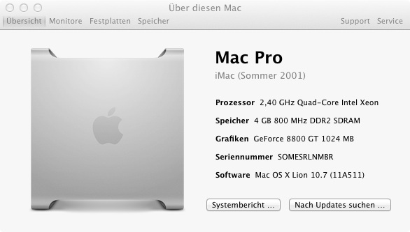

YouDoMeIDoYou Posted July 29, 2011 Share Posted July 29, 2011 Hi to everyone, Here a short breakdown how I installed Lion on my Hardware: I'm running Lion in 64Bit Working: Restart, Sleep, Shutdown, QE / QI, Speedstep, Dual DVI Monitoring Not tested: WiFi onboard I'm not using any smbios.plist - don't really know what its for due to the fact chameleon is recognizing everything quite well. Any proposals are welcome! Don't know why its telling me "iMac (summer 2001)"... Board: P5K Premium Black Pearl Edition - Bios Rev. 1101 CPU: Q6600 @ 2,4 GHz Memory: 2 x 2GB Corsair DDR2 SDRAM, 800 MHz, CM2X2048-6400C5DHX Graphics: GeForce 8800GT, 1024 MB, ID: 0x0611 Sound: AD1988B / SoundBlaster Live 5.1 PCI Ethernet: Marvell88E8056 / RealtekRTL8110SC Bootloader: Chameleon-2.0-RC5-r1083 I only want to share my files used in E/E - S/L/E Folder. There are very good instructions for Lion Setup e.g. here. General hints: Use Chameleon_2.0_RC5_r1083.pkg.zip and install PrefPane in order to easily get access to com.apple.Boot plist in E/E folder: Check "Graphics Enabler" for Graphics injection durin boot: For P-State and C-State support check both: For DSDT Editing use DSDTEditor.zip For extracting DSDT use DSDT autopatcher. Files used in E/E: dsdt.aml.zip Following patches included: AHCI DTGP ALIAS HDEF UHCI HID/CID LPC IRQs RENAMED DEVICES SMBUS SHUTDOWN REMOVED DEVICES FIX WARNINGS RTC (no results with Lion) AD1988B (no results with Lion) SpeedStep Q6600, CPU 0-3 SpeedStep Q6600, CPU 1-4 AppleRTL8169Ethernet.kext.zip for onboard RealtekRTL8110SC Ethernet - extracted from 10.6.6 Snow Leopard but working with Lion Marvell88E8056.kext.zip for onboard Marvell88E8056 Ethernet FakeSMC.kext.zip Attention: ACPIMonitor.kext, IntelCPUMonitor.kext, IntelThermal.kext, NVClockX.kext, SuperIOFamily.kext for sensor reading already included (right click on FakeSMC.kext -> Contents, Plugins to add/delete some kexts). You might get Kernel Panics when using different hardware, e.g. Radeon Graphics!) Look here for further information You will need iStatMenus for getting system information: Use Kext_Wizard.zip for making Extensions.mkext, installing kexts and repairing permissions. Files used in S/L/E: AppleHDA.kext.zip for onboard AD1988B-chip AppleRTC.kext.zip for preventing BIOS-reset. Patched in DSDT but not working... For my SBLIVE 5.1 Soundcard with SB0100 chip use kXAudioDriver_1.11b0.dmg.zip from kxproject. Link to comment https://www.insanelymac.com/forum/topic/263965-osx-107-lion-on-p5k-premium-wifi-black-pearl-edition/ Share on other sites More sharing options...

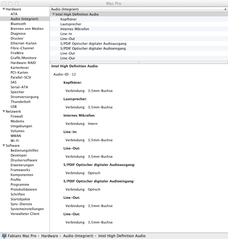

snoopndh Posted July 30, 2011 Share Posted July 30, 2011 hi YouDoMeIDoYou i am german, but i write in english as good i can my mainboard is an asus p5b deluxe wifi ap, but the soundchip is the same as your mainboard. the soundchip is the adi1988b. i installed lion but no sound. then i installed your applehda.kext from your post and restart my lion. No Sound. have you an idea for me what i can do ??? lion is original installed, only fakesmc.kext, dsdt.aml with autopatcher, smbios.plist, skge.kext and applertc.kext. thank you for your answer. greets snoopndh Link to comment https://www.insanelymac.com/forum/topic/263965-osx-107-lion-on-p5k-premium-wifi-black-pearl-edition/#findComment-1726063 Share on other sites More sharing options...

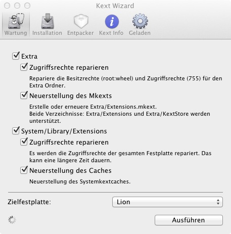

YouDoMeIDoYou Posted July 31, 2011 Author Share Posted July 31, 2011 Did you install your AD1988b.kext to System/Library/Extensions ? If it is so - repair your permissions and your kextcache with kext wizard (You can find this app in my post). I hope it helps... Link to comment https://www.insanelymac.com/forum/topic/263965-osx-107-lion-on-p5k-premium-wifi-black-pearl-edition/#findComment-1726532 Share on other sites More sharing options...
snoopndh Posted August 1, 2011 Share Posted August 1, 2011 Hi YouDoMeIDoYou Thanks.... Should i copy ad1988b.kext in S/L/E with your AppleHDA.kext? And should i have a DSDT.aml-Patch for the AD1988b ??? greets snoopndh can you upload your E/E-Folder and the kexts you have in S/L/E??? Link to comment https://www.insanelymac.com/forum/topic/263965-osx-107-lion-on-p5k-premium-wifi-black-pearl-edition/#findComment-1727230 Share on other sites More sharing options...
YouDoMeIDoYou Posted August 3, 2011 Author Share Posted August 3, 2011 I'm so sorry... I mixed up my Snow Leopard install with my Lion install! There is no ad1988b.kext used at all with Lion - it doesn't work with 10.7. Only use my mentioned kexts at the topic of my post and everything will work just fine. But to be sure here my used Kexts: Extra_Extensions.zip System_Library_Extensions.zip Use Kext Wizard (link above) for installing kexts. You have to choose between Extra and S/L/E folder. Use the correct kexts for each destination: Be also sure to use Kext Wizard for permissions and cache rebuild: Another useful link for setting up you smbios.plist! Please make sure you have the same hardware - otherwise all your time spent is useless... Link to comment https://www.insanelymac.com/forum/topic/263965-osx-107-lion-on-p5k-premium-wifi-black-pearl-edition/#findComment-1728970 Share on other sites More sharing options...

bci24sg22 Posted August 31, 2011 Share Posted August 31, 2011 Thank you YouDoMeIDoYou for your AppleHDA.kext and AppleRTC.kext. Now my sound its working. I have a P5E3 - Premium Wifi and everything it's working perfect. Cheers! Link to comment https://www.insanelymac.com/forum/topic/263965-osx-107-lion-on-p5k-premium-wifi-black-pearl-edition/#findComment-1742322 Share on other sites More sharing options...

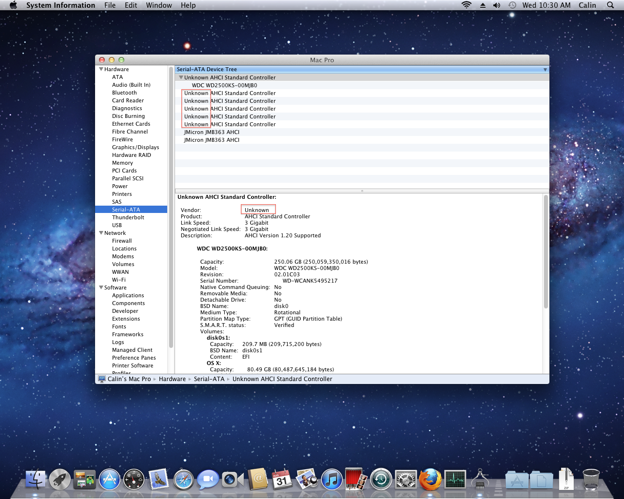

bci24sg22 Posted August 31, 2011 Share Posted August 31, 2011 YouDoMeIDoYou i forgot to say, in your system preferences --> Serial-Ata your AHCI Controller is recognized? My it isn't. I attached my print screen. If i boot with [url="http://www.insanelymac.com/forum/topic/279450-why-insanelymac-does-not-support-tonymacx86/"]#####[/url] it is recognized (Intel). Thank you! Link to comment https://www.insanelymac.com/forum/topic/263965-osx-107-lion-on-p5k-premium-wifi-black-pearl-edition/#findComment-1742338 Share on other sites More sharing options...

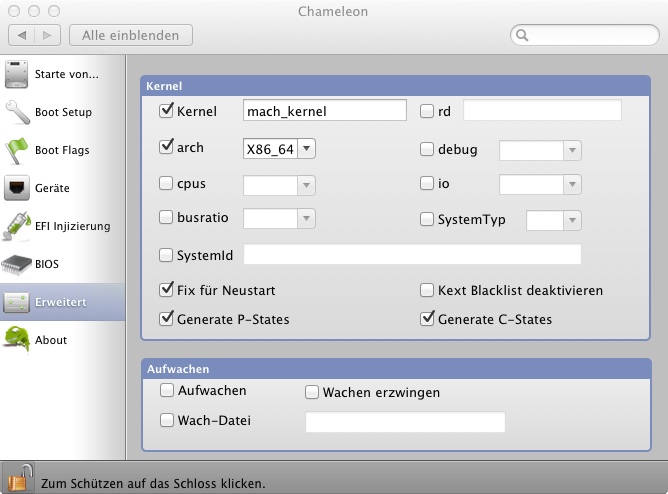

YouDoMeIDoYou Posted September 22, 2011 Author Share Posted September 22, 2011 Sleep is only sleeping the LCD and harddrive(s) but not the fans. When you put your rig to sleep does it go in deep sleep? Yes, it does go into deep sleep. Did you enable C-States in chameleon? I have almost the same system. I'm running 8800GTS 640MB. Lion is up and running. Everything works except wireless. However, i get plug-in failure in Safari on Adobe Flash. Also, Flash crashes in Firefox whenever I'm running an youtube video. I didn't try to get wireless working. Maybe an USB wireless adapter may be a solution for you? Thank you YouDoMeIDoYou for your AppleHDA.kext and AppleRTC.kext. Now my sound its working. I have a P5E3 - Premium Wifi and everything it's working perfect. Cheers! Nice to hear Good luck further on! YouDoMeIDoYou i forgot to say, in your system preferences --> Serial-Ata your AHCI Controller is recognized? My it isn't. I attached my print screen. If i boot with [url="http://www.insanelymac.com/forum/topic/279450-why-insanelymac-does-not-support-tonymacx86/"]#####[/url] it is recognized (Intel). Thank you! Yes it is correctly recognized. I am using chameleon - no trouble with that in any version. Is AHCI activated in BIOS? I remember running SATA drives with IDE enabled gave that "unknown"... good luck Link to comment https://www.insanelymac.com/forum/topic/263965-osx-107-lion-on-p5k-premium-wifi-black-pearl-edition/#findComment-1751818 Share on other sites More sharing options...
bci24sg22 Posted September 26, 2011 Share Posted September 26, 2011 Is AHCI activated in BIOS? Yes. I have enabled the AHCI in BIOS. Could be because i am using Chimera? Link to comment https://www.insanelymac.com/forum/topic/263965-osx-107-lion-on-p5k-premium-wifi-black-pearl-edition/#findComment-1753037 Share on other sites More sharing options...
YouDoMeIDoYou Posted September 29, 2011 Author Share Posted September 29, 2011 I don't think it's because of Chimera. Check out this link - maybe that helps: Unknown AHCI Controller Link to comment https://www.insanelymac.com/forum/topic/263965-osx-107-lion-on-p5k-premium-wifi-black-pearl-edition/#findComment-1754402 Share on other sites More sharing options...
