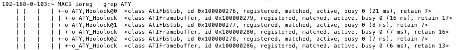

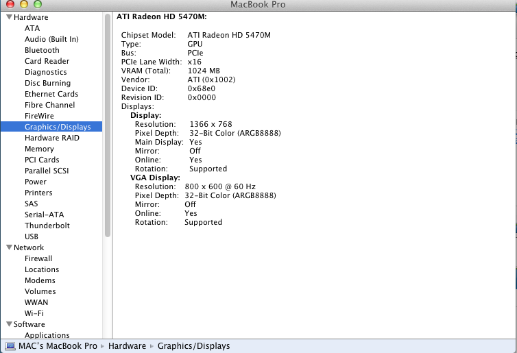

chirionutz Posted December 17, 2011 Share Posted December 17, 2011 Would you be kind to help me escape of my ghost monitor for Ati Radeon 5470m (in a laptop Dell 13R). I use AtiConfig=Hoolock and GraphicsEnabler=Yes to be able to get native resolution, but I have a ghost VGA display. I use 10.7.2 version of Lion. @Christopher or @tallest can you help me, please? Link to comment https://www.insanelymac.com/forum/topic/262223-fixed-ghost-display-on-msi-r5770-hawk-in-lion/page/2/#findComment-1779348 Share on other sites More sharing options...
tallest Posted December 18, 2011 Author Share Posted December 18, 2011 Can you post the output from System Information under Graphics/Displays? You need to figure out what connector needs to be deleted from the profile. Link to comment https://www.insanelymac.com/forum/topic/262223-fixed-ghost-display-on-msi-r5770-hawk-in-lion/page/2/#findComment-1779504 Share on other sites More sharing options...
chirionutz Posted December 18, 2011 Share Posted December 18, 2011 UPDATE! I have managed to force edid using this tutorial: http://olarila.com/forum/viewtopic.php?f=18&t=736 No more ghost screen! No more aticonfig=Hoolock needed. Yes! Here you are: I am a noob, I do not know how to delete the connector from the profile. I would appreciate it very much if you could do it for me and send me the file already modified. I have tried Eulemur with an external monitor (VGA). I was able to reach the vga monitor only. The laptop display was black with backlight. No ghost screen, but no laptop display. I also have an HDMI connection, but didn't try that. I won't use it soon anyway. I have tried SwitchRes X to disable the VGA (ghost) display, but I couldn't do that. It seams that ghost display is indispensable for Hoolock and can not be disabled for real. Link to comment https://www.insanelymac.com/forum/topic/262223-fixed-ghost-display-on-msi-r5770-hawk-in-lion/page/2/#findComment-1779536 Share on other sites More sharing options...
