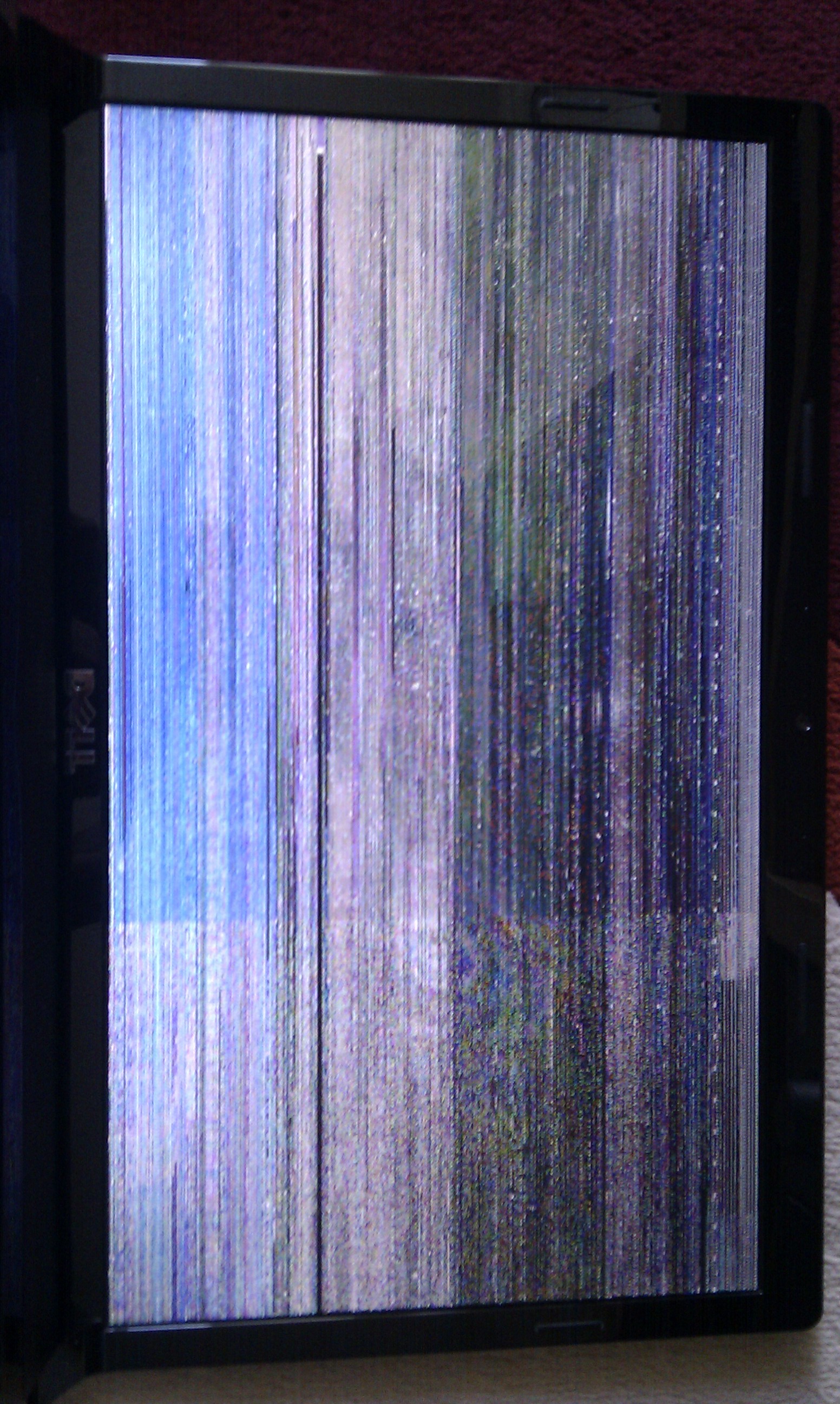

jamieostrich Posted July 25, 2011 Share Posted July 25, 2011 @Lifelike Yeah I really didnt take that into consideration... But if you could point me at an installation guide or something that you used to get your quad boot working, thatd be GREAT! UHOH. I just saw this: Dell Studio 15 1557 & 1558 plagued with failures - CNET Laptop buying advice Forums Has anyone experienced overheating issues with the 1558? This could be a major issue for me.. well it does get warm and the fans cut in, but it works fine! mac and windows, although when installing lion for the first time make sure has plenty of air! Then it all cools down a little. Not the quietest laptop, but a quick good one! Link to comment https://www.insanelymac.com/forum/topic/259702-guide-dell-studio-1558-ati-5470-core-i7-what-ive-got-working-so-far/page/4/#findComment-1722405 Share on other sites More sharing options...
lifelike27 Posted July 26, 2011 Author Share Posted July 26, 2011 @Lifelike Yeah I really didn't take that into consideration... But if you could point me at an installation guide or something that you used to get your quad boot working, thatd be GREAT! UHOH. I just saw this: Dell Studio 15 1557 & 1558 plagued with failures - CNET Laptop buying advice Forums Has anyone experienced overheating issues with the 1558? This could be a major issue for me.. I did have a heating problem. My laptop used to go from 70 to 100 degs in a second and eventually switch off from overheating. I sent it back to Dell and they told me it was just a dust build up. Since then, I haven't had a problem at all. 50 degs is my norm now. Worst case scenario, if you're warranty runs out and you want to check for dust, use the service manual to figure out how to carefully take it apart. I've done it so far. http://support.dell.com/support/edocs/syst...en/SM/index.htm Remember to use an aerosol can to clean out any dust. Do you plan on triple booting Ubuntu as well as Windows (triple boot)? If yes, follow this tutorial: http://francisbyrne.net/?p=16 When the author of the post talks about using an application called gptsync, DO NOT USE IT, it's outdated and can cause problems. I have a thread on the ubuntuforums.org where I've explained this problem and found help for it. Please read it as well. Basically, instead of using gptsync, you use gdisk to create a hybrid MBR for Windows to work. http://ubuntuforums.org/showthread.php?t=1758411 Also, to get all OSes boot from the unified linux bootloader GRUB, you can use this tutorial to chainload chameleon to GRUB so that you just have to use one menu for booting Windows, Ubuntu and OS X. http://jeffhoogland.blogspot.com/2011/04/h...-chameleon.html If you have any problems with it, just ask. Link to comment https://www.insanelymac.com/forum/topic/259702-guide-dell-studio-1558-ati-5470-core-i7-what-ive-got-working-so-far/page/4/#findComment-1722790 Share on other sites More sharing options...
