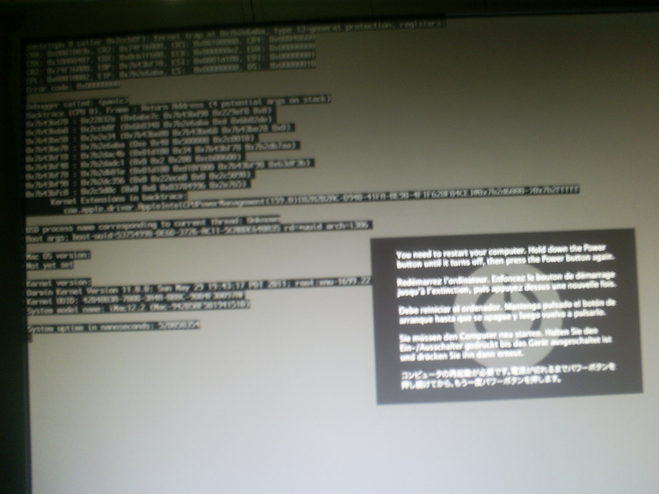

turco_ninja Posted June 16, 2011 Share Posted June 16, 2011 SpeedStepper v1.2 for Lion DP4 (beta) Only works with AICPUPM v159.0.0 (64bit) Also see MSRDumper for debugging P-States! I tried the DP4 speedstepper script. Looks runs perfectly in terminal, finding and changing some values that i don´t understand. In boot, with -v, i get the error in screen file below. with -v -x, the machine restart. I´m using chameleon 1011 whith SSDT-1.aml and DDST.aml in /Extra folder. Thanks for the tool again. dsdt_ssdt.zip Link to comment https://www.insanelymac.com/forum/topic/258611-speedstepper-now-supports-mountain-lion-1083/page/2/#findComment-1698484 Share on other sites More sharing options...
flAked Posted June 16, 2011 Author Share Posted June 16, 2011 The photo isn't very crisp, is ECX = 0xE2? You have External (\_PR_.CPU0, DeviceObj) in your SSDT, but no definition for it in the DSDT. You also might want to look up some basic DSDT editing to change device names and do some basic fixes. And keep in mind that this only works for 64bit for DP4, the 32bit kext isn't patched at all. Link to comment https://www.insanelymac.com/forum/topic/258611-speedstepper-now-supports-mountain-lion-1083/page/2/#findComment-1698574 Share on other sites More sharing options...
