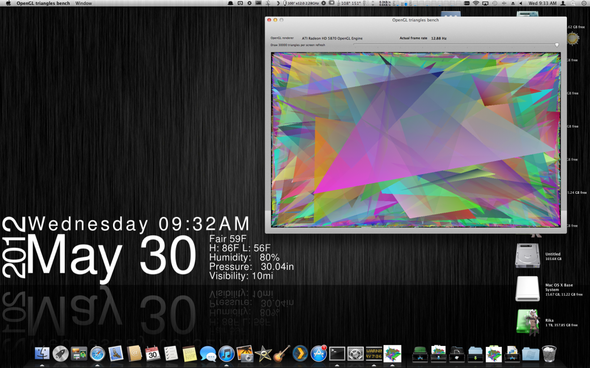

eep357 Posted May 30, 2012 Share Posted May 30, 2012 I beat the game? Anyway, here's some ATI for comparison, 10.8 DP3 upd2. After ML DP3 upd1, all benches went through the roof, now with upd2, they went back down to below Lion scores,, but it was fun while it lasted. 1 Link to comment https://www.insanelymac.com/forum/topic/256652-gpu-load-agpm-check-tool-opengl-triangles/page/2/#findComment-1823790 Share on other sites More sharing options...

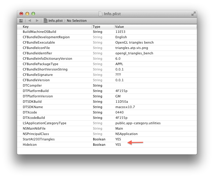

Gringo Vermelho Posted May 31, 2012 Share Posted May 31, 2012 mitch Do you take requests? Could you add a fixed "200 triangles" setting for the Fermi Freeze impeded? At 60Hz, 200 triangles is enough to completely prevent the freeze on my 460 GTX. I have no idea how much work it would be so please don't get mad if it's a lot to ask, I really have no idea. It doesn't even have to be in the GUI. I'd like to be able to do two things specifically, set from info.plist: Hide Icon Draw 200 triangles on app start (default is 0) like this: Or it could be TrianglesToDrawOnStart and you could specify any number? This way I could leave it as hidden login item and forget all about it. Link to comment https://www.insanelymac.com/forum/topic/256652-gpu-load-agpm-check-tool-opengl-triangles/page/2/#findComment-1823871 Share on other sites More sharing options...
mitch_de Posted May 31, 2012 Author Share Posted May 31, 2012 i will try to make such an 200 tria app. I think the fermi gets problems when it goes into the most idle gpu pstate. Any chance to edit AGPM to avoid the lowest PSTATE (by edit this threshouds) ? Link to comment https://www.insanelymac.com/forum/topic/256652-gpu-load-agpm-check-tool-opengl-triangles/page/2/#findComment-1823910 Share on other sites More sharing options...
Gringo Vermelho Posted May 31, 2012 Share Posted May 31, 2012 It doesn't work, I tried everything, even several custom BIOS with altered power states provided by Rominator, both flashed to the card and loaded with Chameleon. I use MacPro3,1 so no AGPM, but I've tried with modified AGPM as well. The only thing that works consistently is keeping the GPU busy with something. Thanks for anything you can do! Link to comment https://www.insanelymac.com/forum/topic/256652-gpu-load-agpm-check-tool-opengl-triangles/page/2/#findComment-1824017 Share on other sites More sharing options...
