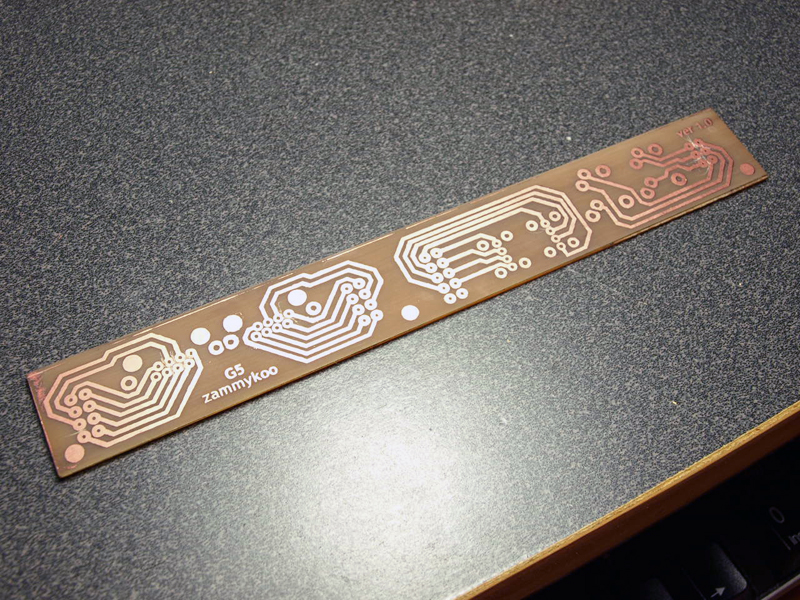

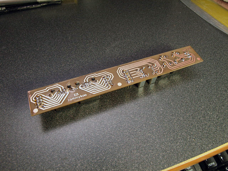

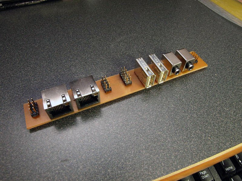

zammykoo Posted May 9, 2011 Author Share Posted May 9, 2011 Check this out Guess I couldn't stay away from this project too long. I wanted to go ahead and finish a prototype for testing purposes. I will still be holding off on the production models till I figure out a quicker/easier way for me to print boards & drill holes. Everything went smoothly and turned out better than I imagined. I'll try to post a demo video shortly. Link to comment https://www.insanelymac.com/forum/topic/255055-pre-made-custom-g5-rear-io-ports-cables/page/2/#findComment-1681049 Share on other sites More sharing options...
