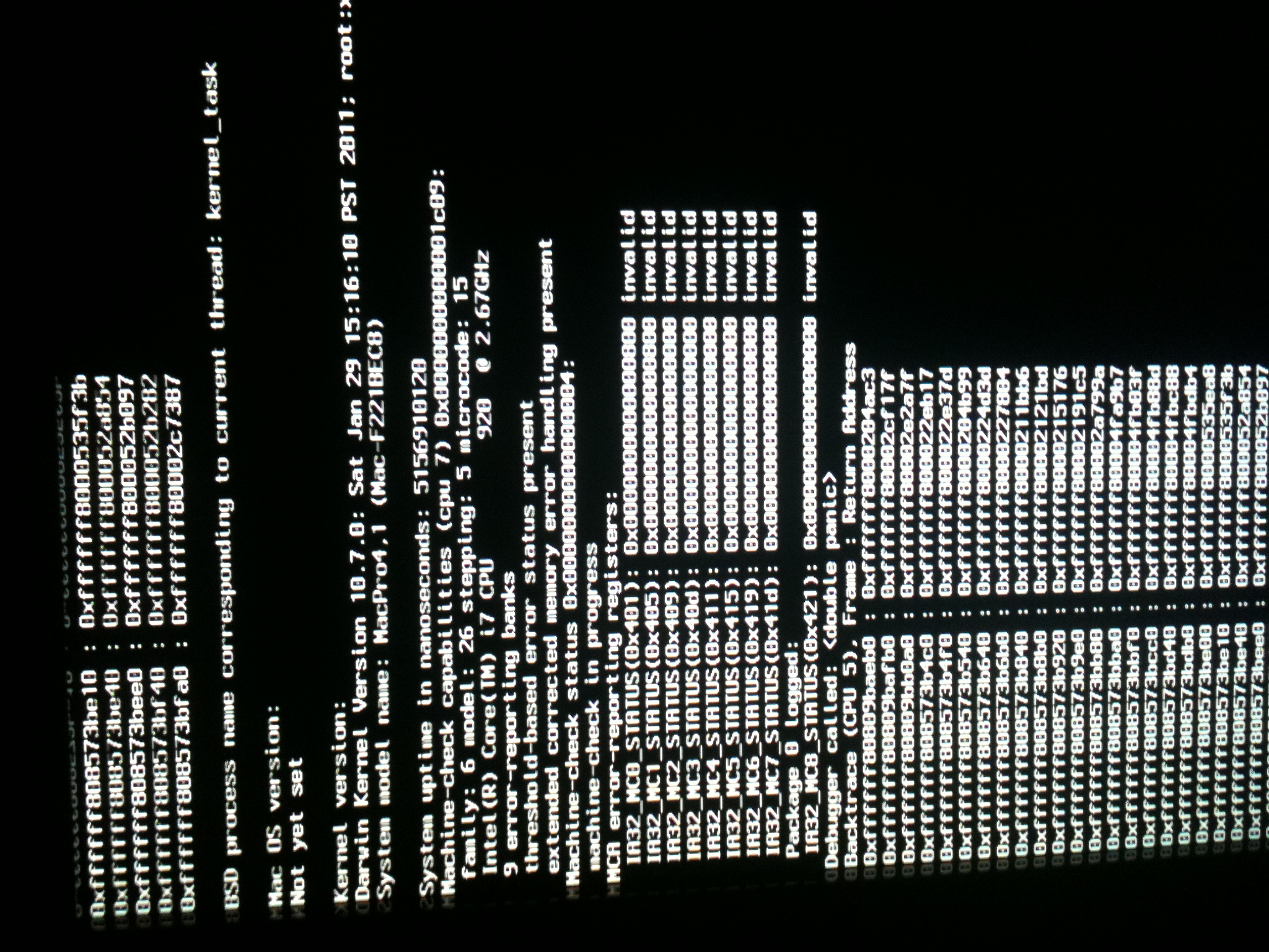

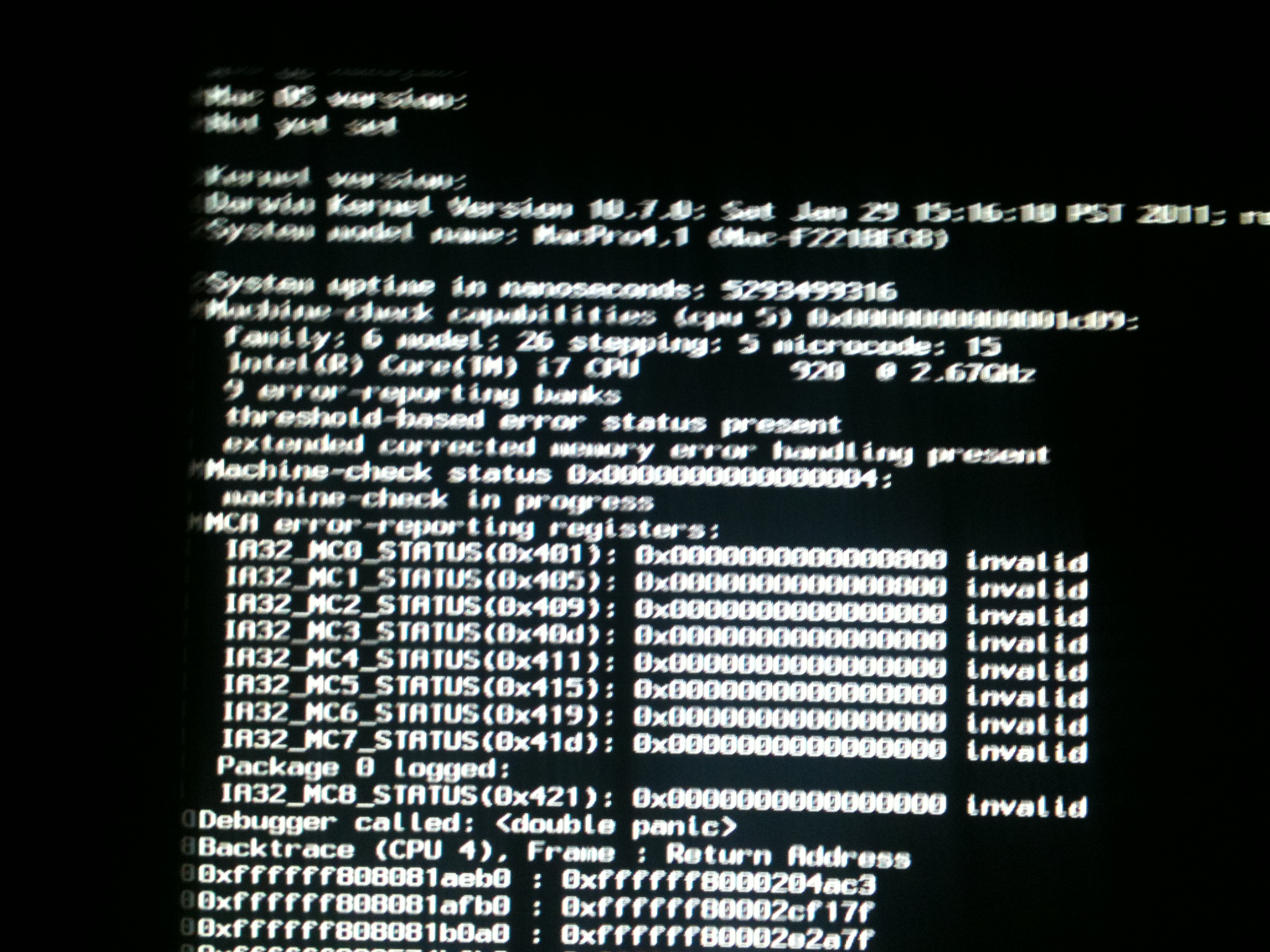

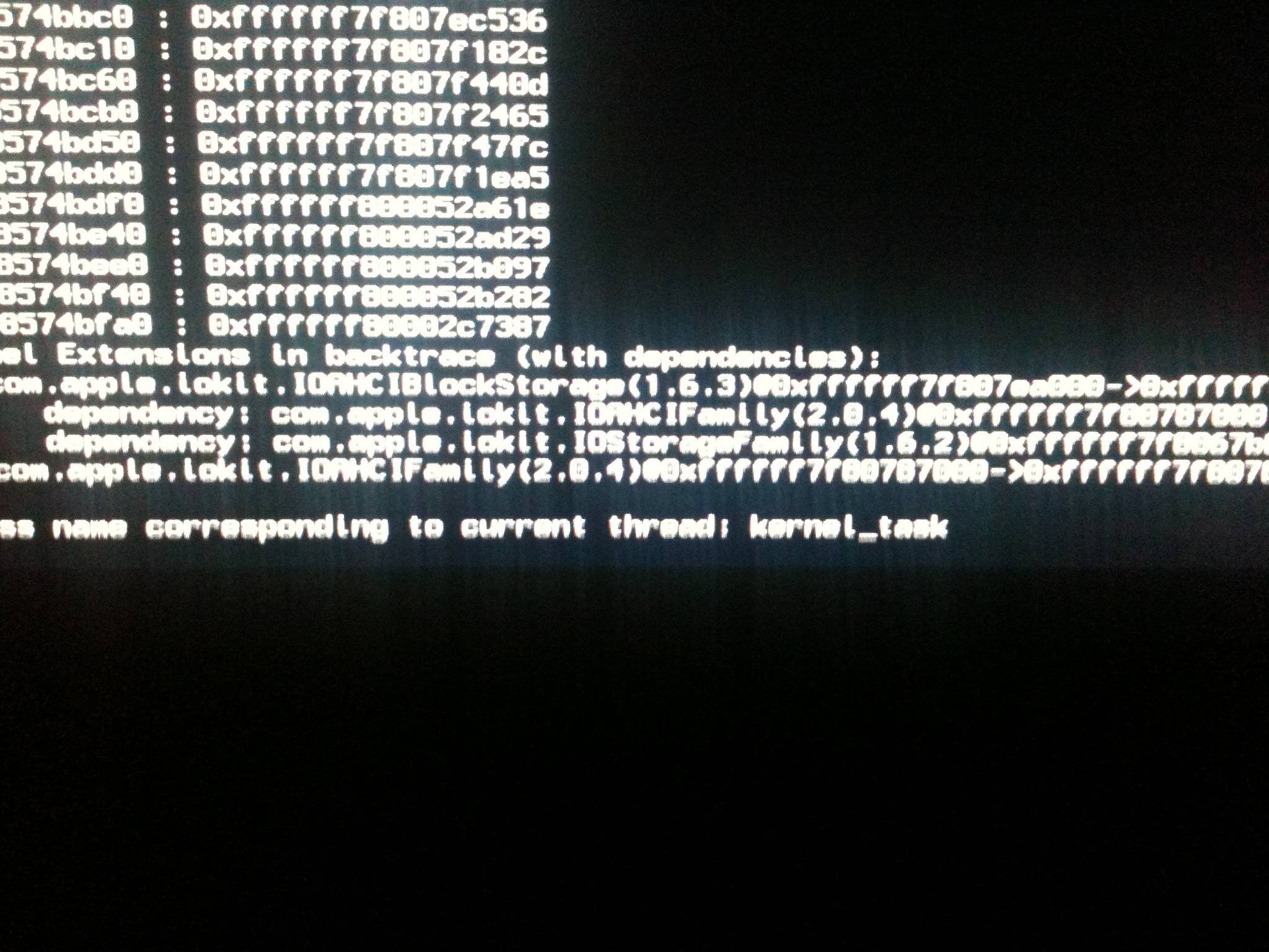

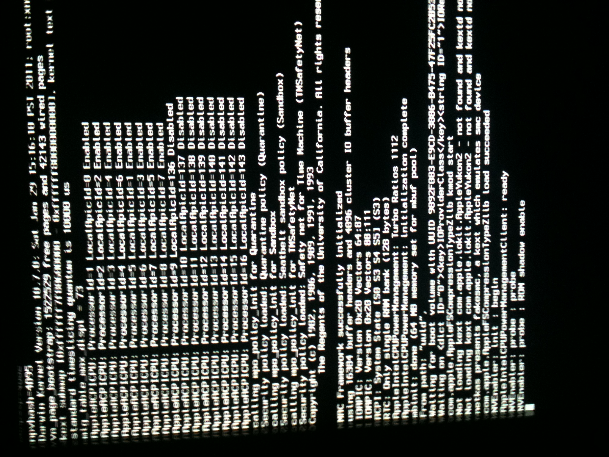

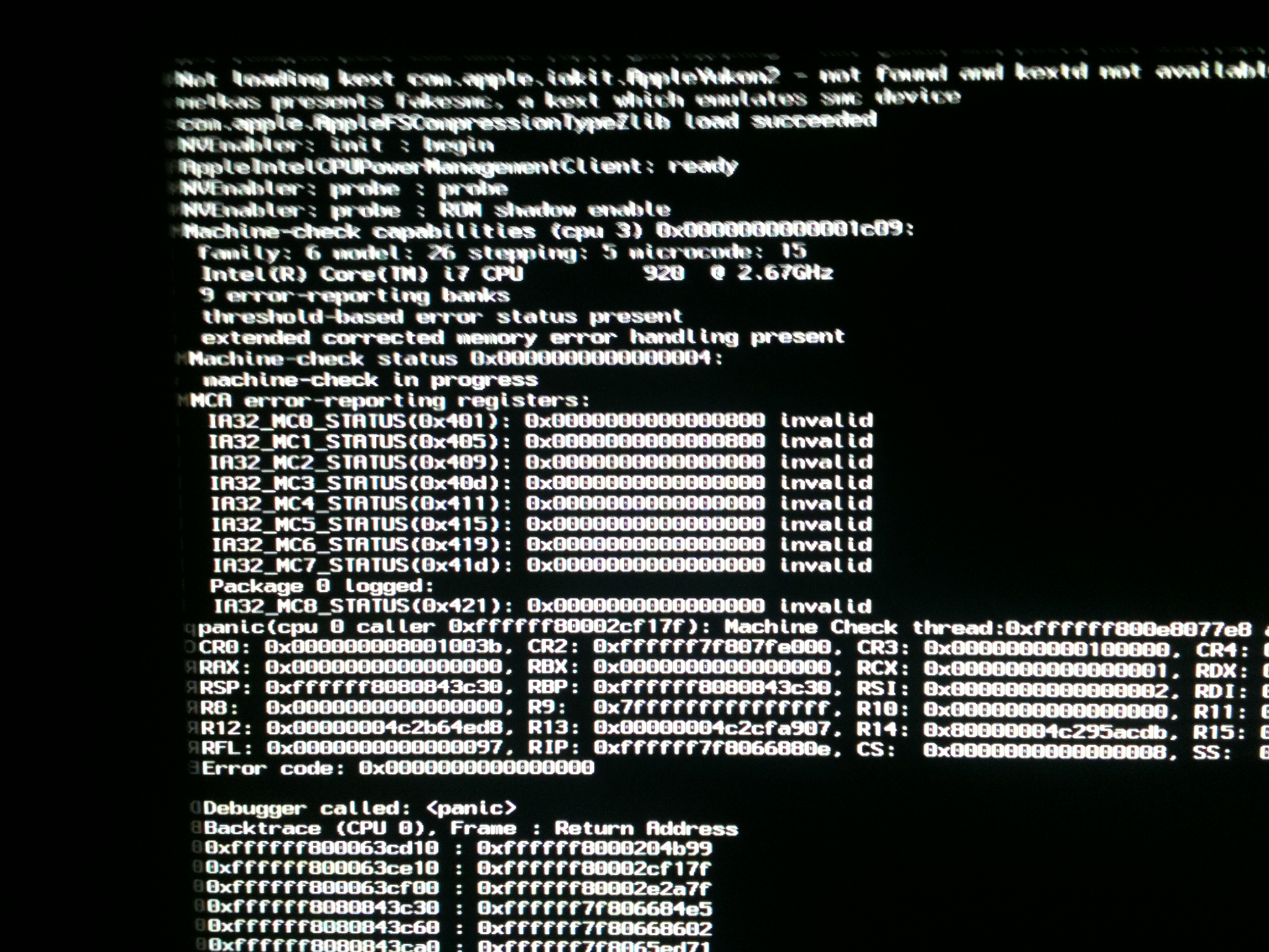

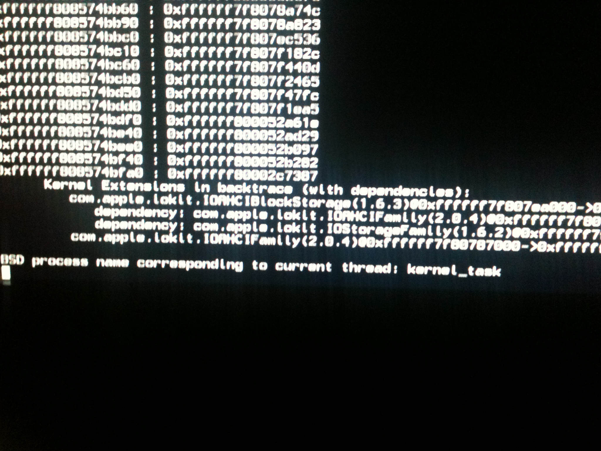

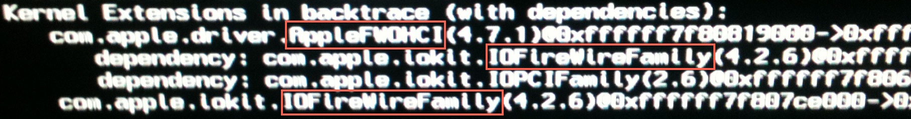

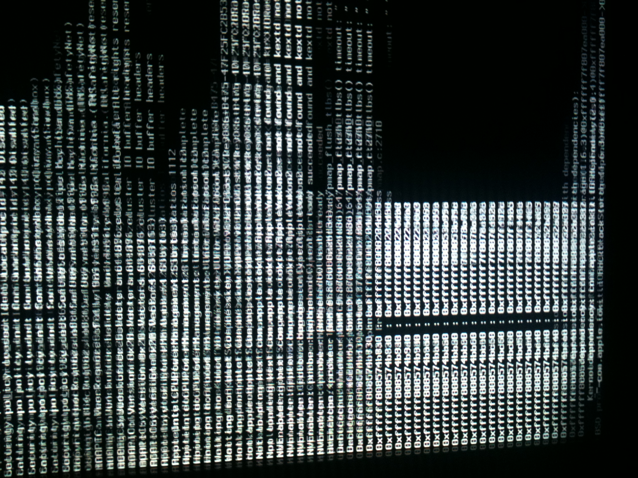

gamer98765 Posted June 3, 2011 Share Posted June 3, 2011 So i disabled Firewire but get a kernel panic again:( http://img843.imageshack.us/img843/5343/img0120yr.jpg http://img838.imageshack.us/img838/5812/img0121mv.jpg http://img607.imageshack.us/img607/1252/img0122nu.jpg Link to comment https://www.insanelymac.com/forum/topic/254930-testers-wanted-zotac-gtx-460-black-screen-issue/page/3/#findComment-1692464 Share on other sites More sharing options...
Gringo Vermelho Posted June 3, 2011 Share Posted June 3, 2011 Slowly going off topic here.. your current issues have nothing to do with your video card, working or not. Your photo is terrible but it looks like IOAHCISerialATAPI and IOAHCIFamily, unplug your DVD drive and see if it goes away. I think your OS X installation or your hardware has more serious issues than just graphics not working. Link to comment https://www.insanelymac.com/forum/topic/254930-testers-wanted-zotac-gtx-460-black-screen-issue/page/3/#findComment-1692467 Share on other sites More sharing options...
gamer98765 Posted June 3, 2011 Share Posted June 3, 2011 I take few new photos. And i never have Problems bevor i buy the zotac 460 and change it with my old one:( If this here is to much away from topic just delete my posts and i will stop asking... greetz Link to comment https://www.insanelymac.com/forum/topic/254930-testers-wanted-zotac-gtx-460-black-screen-issue/page/3/#findComment-1692482 Share on other sites More sharing options...

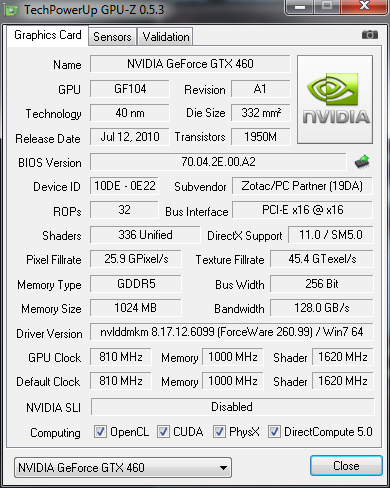

gamer98765 Posted June 4, 2011 Share Posted June 4, 2011 Hello Krazubu I have tzhe zotac 460 amp Edition. i attached my rom and gpu z output. Are there any differences to the zotac 460? GF104.zip Link to comment https://www.insanelymac.com/forum/topic/254930-testers-wanted-zotac-gtx-460-black-screen-issue/page/3/#findComment-1692673 Share on other sites More sharing options...
Krazubu Posted June 4, 2011 Share Posted June 4, 2011 Maybe get a bootable system before thinking about tweaking the graphic card ? 1 Link to comment https://www.insanelymac.com/forum/topic/254930-testers-wanted-zotac-gtx-460-black-screen-issue/page/3/#findComment-1692801 Share on other sites More sharing options...
