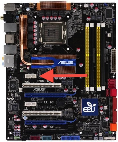

Gringo Vermelho Posted February 22, 2013 Share Posted February 22, 2013 Since installing a USB 2.0 expansion card in the PCI-E x1 slot above the video card, I don't need the npci flag anymore. After adding the USB card and replacing my GTX 460 with a GTX 660 I had to re-extract and repatch my DSDT due to changed memory locations (OperationRegion, SystemMemory). I've also changed this... Device (PCI0) { Name (_HID, EisaId ("PNP0A08")) // _HID: Hardware ID Name (_ADR, Zero) // _ADR: Address Method (^BN00, 0, NotSerialized) { Return (Zero) } Method (_BBN, 0, NotSerialized) // _BBN: BIOS Bus Number { Return (BN00 ()) } Name (_UID, Zero) // _UID: Unique ID Method (_PRT, 0, NotSerialized) // _PRT: PCI Routing Table { If (PICM) { Return (AR00) } Return (PR00) } Method (_S3D, 0, NotSerialized) // _S3D: S3 Device State { If (LOr (LEqual (OSFL (), One), LEqual (OSFL (), 0x02))) { Return (0x02) } Else { Return (0x03) } } Name (_CID, EisaId ("PNP0A03")) // _CID: Compatible ID ...to this: Device (PCI0) { Name (_HID, EisaId ("PNP0A08")) // _HID: Hardware ID Name (_CID, EisaId ("PNP0A03")) // _CID: Compatible ID Name (_ADR, Zero) // _ADR: Address Name (_UID, Zero) // _UID: Unique ID Name (_BBN, Zero) // _BBN: BIOS Bus Number Method (_PRT, 0, NotSerialized) // _PRT: PCI Routing Table { If (PICM) { Return (AR00) } Return (PR00) } Method (_S3D, 0, NotSerialized) // _S3D: S3 Device State { If (LOr (LEqual (OSFL (), One), LEqual (OSFL (), 0x02))) { Return (0x02) } Else { Return (0x03) } } Much cleaner! System.log excerpt: Feb 22 00:29:15 localhost kernel[0]: [ PCI configuration begin ] Feb 22 00:29:15 localhost kernel[0]: console relocated to 0xf89000000 Feb 22 00:29:15 localhost kernel[0]: PCI configuration changed (bridge=1 device=1 cardbus=0) Feb 22 00:29:15 localhost kernel[0]: [ PCI configuration end, bridges 7 devices 20 ] I'm pretty sure the fact that it works now is somehow related to the card having its own PCI bridge: 03:00.0 PCI bridge [0604]: Pericom Semiconductor Device [12d8:e111] (rev 02) 04:00.0 USB controller [0c03]: NEC Corporation OHCI USB Controller [1033:0035] (rev 43) 04:00.1 USB controller [0c03]: NEC Corporation OHCI USB Controller [1033:0035] (rev 43) 04:00.2 USB controller [0c03]: NEC Corporation uPD72010x USB 2.0 Controller [1033:00e0] (rev 04) ASUS P5Q-E, 10.8.2 Links of interest: http://en.wikipedia....ki/Root_complex http://www.acpi.info/acpi_faq.htm (do a page search for "root bus") http://opensource.ap...onfigurator.cpp http://www.projectosx.com/forum/index.php?s=&showtopic=1647&view=findpost&p=15259 Also google _BBN root bus Link to comment https://www.insanelymac.com/forum/topic/254468-pci-configuration-begin/page/4/#findComment-1891101 Share on other sites More sharing options...
