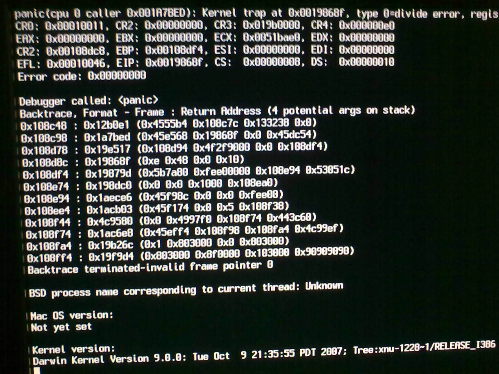

markrodgers11 Posted January 30, 2011 Share Posted January 30, 2011 System Specs: CPU: AMD Athlon II X4 3.0GHz Quad-Core GPU: ATI Radeon HD 5750 1GB 128-bit GDDR5 Motherboard: ASUS M4A88TD-V EVO/USB3 Memory: 4G G.SKILL Ripjaws DDR3 1600 PSU: Cooler Master GX Series 750w HDD: Samsung HD502HJ ATA DVD-Drive 1: TSSTcorp CD/DVDW TS-H652D ATA DVD-Drive 2: HL-DT-ST CD-ROM GCR-8483B ATA Okay...i've been trying to install Mac OS X on my desktop which i built myself. The system specs are above. I've tried lots of things... - iDeneb v1.3 (OS X v10.5.5)... "Still waiting for root device". I solved this by changing IDE to AHCI in the bios. Then i rebooted and got this huge error. " Debugger called: (panic) " then tons of lines of random letters and number, i will type them out if u need the exact full error. Then underneath that is huge paragraph it says: " BSD process name corresponding to current thread: kernal_task Mac OS version: Not yet set " - iDeneb v1.4 (OS X v1.5.6) SAME PROBLEM AS iDeneb v1.3... - iATKOS v7 SAME PROBLEM AS iDeneb v1.3 and iDeneb v1.4 I also used borrowed my friends legit Snow Leopard DVD and burned [url="http://www.insanelymac.com/forum/topic/279450-why-insanelymac-does-not-support-tonymacx86/"]#####[/url] on a DVD. Booted it. Chose "Mac OS X Install DVD" ([url="http://www.insanelymac.com/forum/topic/279450-why-insanelymac-does-not-support-tonymacx86/"]#####[/url] this doesnt give me a choice to boot in verbose mode) It shows the white backgound with the Apple and never makes it to the install menu. Please help I REALLY want Mac OS X (Leopard or Snow Leopard, preferably Snow Leopard) on my computer and have no idea what I can do to get it working. I attached a picture of the error im having with all distros, PLEASE HELP! D: I really hate Windows and I can get Linux Ubuntu 10.10 to install either!!! D: Thanks in advanced. Quote Link to comment Share on other sites More sharing options...

termitn Posted January 31, 2011 Share Posted January 31, 2011 I had same problems but for me it helped to boot with the followed flags -f (reload all kernels) and -v (verbose mode). Cant you type before choosing boot Mac OS install -f -v ? To write symbol "-" type ß. Quote Link to comment Share on other sites More sharing options...
Foxic Posted January 31, 2011 Share Posted January 31, 2011 I had the same problem, [url="http://www.insanelymac.com/forum/topic/279450-why-insanelymac-does-not-support-tonymacx86/"]#####[/url] supported will not boot the retail disk, I had to use nawcom (successor to empire efi) to boot and install, once installed and MB kexts installed [url="http://www.insanelymac.com/forum/topic/279450-why-insanelymac-does-not-support-tonymacx86/"]#####[/url] supported would allow me to boot. FWI: type: -x for safe mode -v for verbose -f for force fo when you see the apple logo in chameleon type -v and hit enter. Hope this helps. Quote Link to comment Share on other sites More sharing options...
Tomica Posted January 31, 2011 Share Posted January 31, 2011 Hello! Try messing around with when you get to Chameleon, try typing -v busratio=18 (or 20) maxmem=2048 cpus=1 Worked for me, give it a go! Quote Link to comment Share on other sites More sharing options...
Gringo Vermelho Posted January 31, 2011 Share Posted January 31, 2011 try typing -v busratio=18 (or 20) Don't guess, use your actual bus ratio: http://www.insanelymac.com/forum/index.php?showtopic=240542 Quote Link to comment Share on other sites More sharing options...
