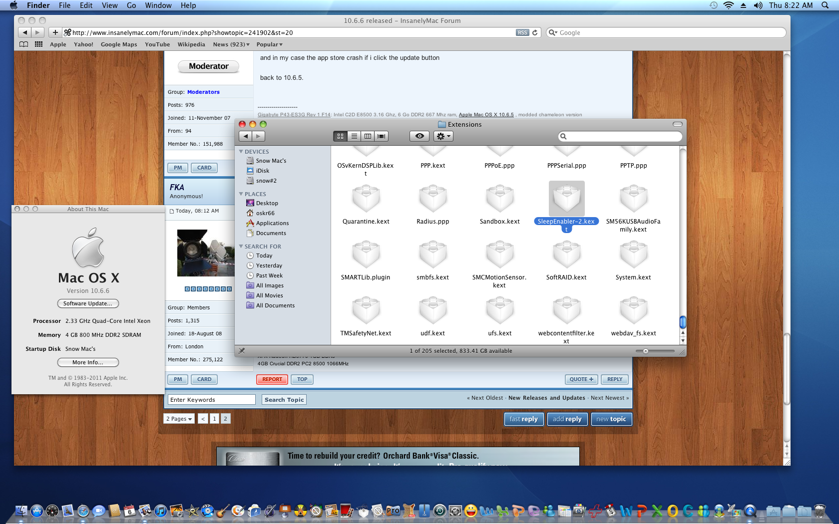

oskr66 Posted January 6, 2011 Share Posted January 6, 2011 just did the update , no problems , even my sleep enabler works ! take a look ... Link to comment https://www.insanelymac.com/forum/topic/241924-1066-is-out/#findComment-1616180 Share on other sites More sharing options...

Bucky Ducksauce Posted January 6, 2011 Share Posted January 6, 2011 "Sleep enabler kexts are version specific. Remove before installing the update." I had a similar KP when trying to re-use my Sleepenabler.kext from 10.6.5. Take yours out and reboot. See what KP you get then (if any). Unfortunately, the upgrade from 10.6.5 has bricked my desktop. I'm getting kernal panics which are unresolvable with the -x -v -f arch=i386 graphicsenabler=n flags. The panic that's displaying on my screen right now is as follows: npvhash=4095 PAE enabled 64 bit mode enabled Darwin Kernal Version 10.6.0: Wed Nov 10 18:13:17 PSI 2010; root:xnu-1504.9.26.-3/RELEASE_I386 vm_page_bootstrap: 830931 free pages and 1266221 wired pages standard timeslicing quantum is 10000 us mig_table_max_displ = 73 SAFE BOOT DEFECTED - only valid OSBundleRequired kexts will be loaded. Kext __kernal__ is not loadable during safe boot; omitting its personalities [sleepEnabler] Registering PowerManagement dispatch table... [sleepEnabler] in the event of a kernal panic, please use pmVersion... panic (cpu 0 caller 0x2ab790): "Version mis-match between Kernal and CPU PM"@/SourceCache/xnu/xnu-1054.9.26/osfmk/i386/pmCPU.c:707 Debugger called: <panic> Backtrace (CPU 0), Frame: Return Address (4 potential args on stack) 0x75483bb8: 0x21b50c (0x5d4438 0x75483bec 0x223974 0x0) 0x75483c08: 0x2ab790 (0x59645c 0x1 0xe 0x75483c34) this hexadecimal stuff goes on for quite a while (15 lines or so), I'll post a photo later at the end of the list it says Kernal Extensions in backtrace (with dependencies): sk.triaxis.kext.SleepEnabler(1.0.0)@0x7f0bd000 -> 0x6f0befff BSD process name corresponding to current thread: Unknown Mac OS version: Not yet set Kernal version: Darwin Kernal Version 10.6.0: Wed Nov 10 18:13:18 PSI 2010; root:xnu-1504.9.26~3/RELEASE_I386 System model name: MacPro 3,1 System uptime in nanoseconds: 231853554 and hangs. My install is a myHack driven install on a GA-p35-ds3l motherboard. 8 gigs of RAM, a 2.83 ghz Quad Core intel chip, Galaxy G210 Geforce video card, and all SATA IO devices. The install was from a retail 10.6.3 dvd, the upgrade to 10.6.5 flawless. However the machine has always given me a kernal panic if I tried to boot without arch=i386 (even before the 10.6.6. update) and if I tried mach_kernal as a boot flag it would tell me the mach_kernal was not found. Apparently it's found now, and it's not liking what it has found. For now, 10.6.6 is hidden as an update on my similarly set up Thinkpad T60 Link to comment https://www.insanelymac.com/forum/topic/241924-1066-is-out/#findComment-1616444 Share on other sites More sharing options...

UnaClocker Posted January 6, 2011 Author Share Posted January 6, 2011 I tried the pmVersion trick.. Didn't do anything for my kernel panic problem. I booted off the Snow Leopard disk (thumb drive, actually), loaded up terminal, went to my Extra directory, delected the kext cache, and the SleepEnabler.kext, rebooted and it's all good now. Strangely enough, sleep still works, wakes up just fine. Guess I'm all set. As for the AppStore, it works just fine for me, bought a free app, it downloaded and and installed and runs, no complaints. Link to comment https://www.insanelymac.com/forum/topic/241924-1066-is-out/#findComment-1616578 Share on other sites More sharing options...

hayduke Posted January 7, 2011 Share Posted January 7, 2011 i got a kernel panic after upgrading to 10.6.6, and removing the old sleepenabler fixed it. i hear sleepenabler kexts are version-specific -- anyone know if there's one available or in the works for 10.6.6? Link to comment https://www.insanelymac.com/forum/topic/241924-1066-is-out/#findComment-1616793 Share on other sites More sharing options...
