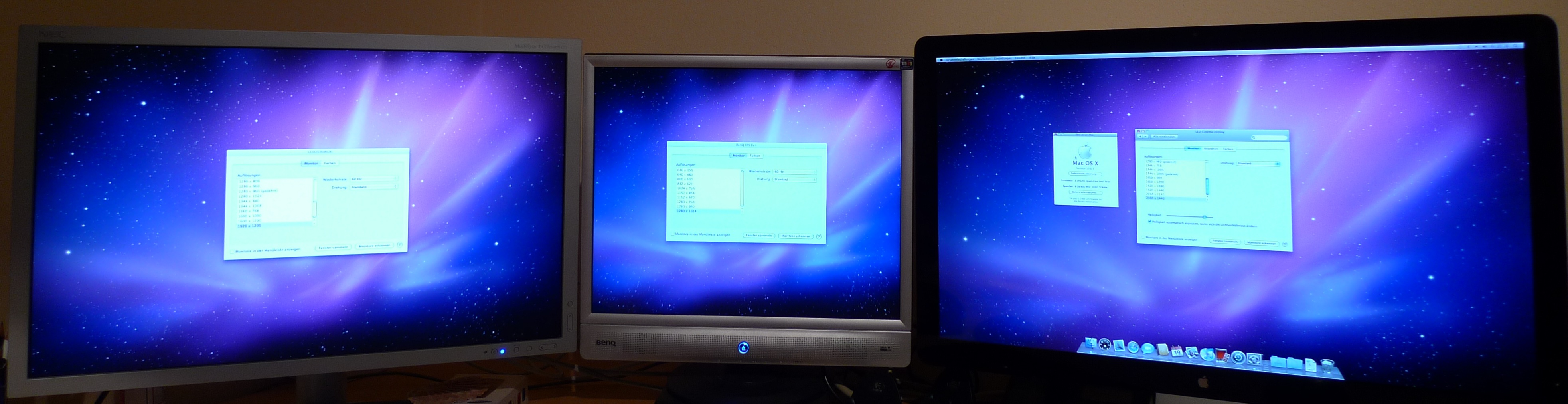

It works - triple display involving a 27" cinema display on a Hackintosh:

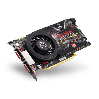

6) Insert your new XFX Radeon HD 5770 single slot into your Hackintosh and connect your 27" cinema display to the mdp
proof: post-260400-1290199702_thumb.jpg
source used: http://www.insanelymac.com/forum/index.php?showtopic=236926

I have been reading on here a lot I want to do 2 27" acd on my hackintosh setup. Anyways I would really appreciate If you could supply a link to that specific video card. I think when you mean singe it onl takes up ! slot space correct?
