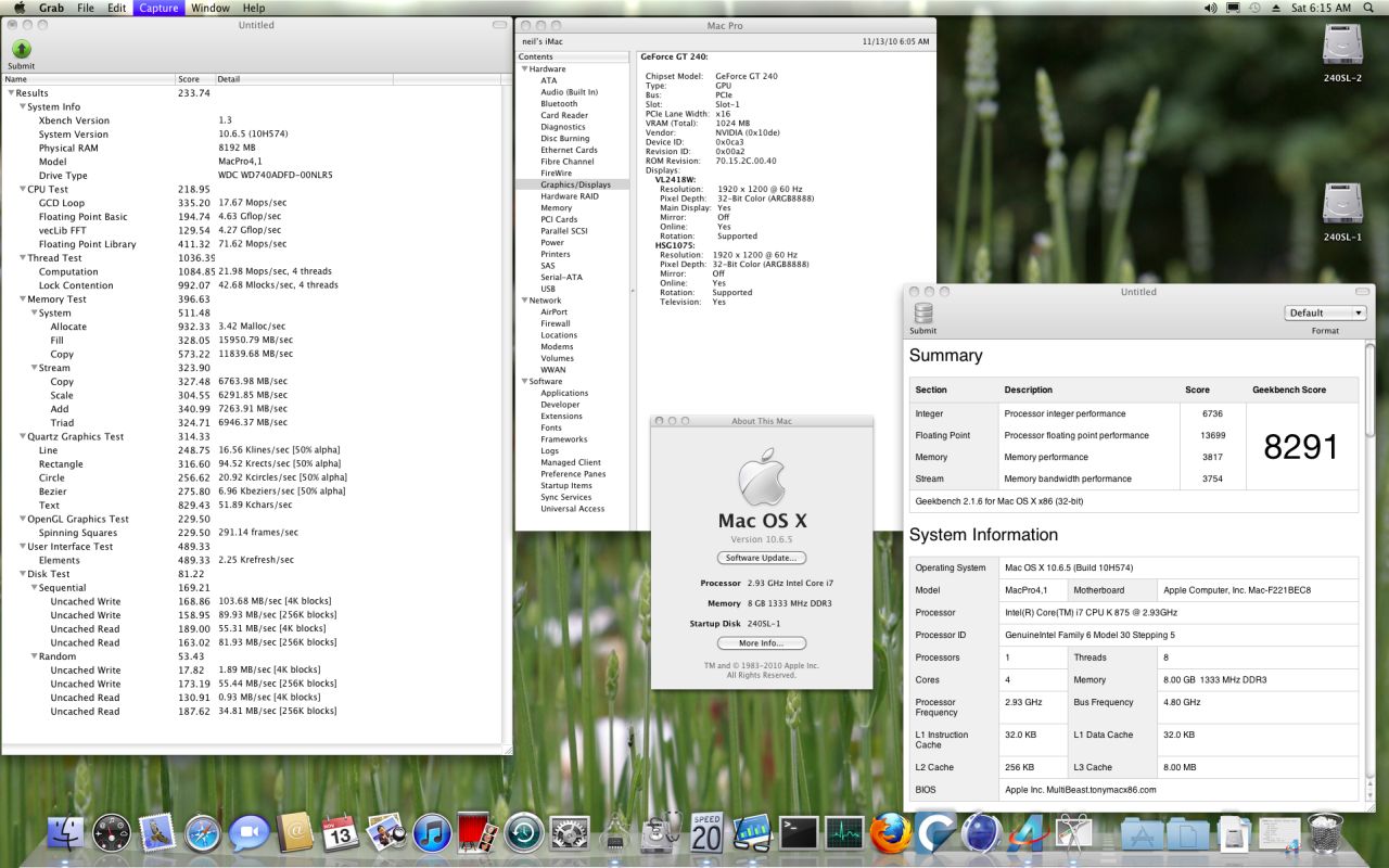

neil43 Posted November 13, 2010 Share Posted November 13, 2010 Significant GL Performance Issue I own two GeForce GT 240 video cards by differnent manufacuters (XFX and EVGA) and with different memory (DDR3 vs DDR5). Running Cinebench v11.5, the XFX tests at 26+ FPS while the EVGA tests at 12+ FPS. Why is there this difference in performance? And is there any thing that can be done to get the EVGA to perform as well as the XFX card? Details: Test Bed GigaByte P55M-UD2, CPU i7-875, not OC'd, 8GB memory, 80GB HDD, OS X 10.6.5, Chameleon V2.0-RC5 r594, EnableGraphics-Yes. Have tried various combinations of EnalbelGrpahics=Yes/No with and without NVenabler_64. Cards: EVGA GeForce GT240 1GB DDR5 PN: 01G-P3-1246-LR XFX GeForce GT 240 1GB DDR3 PN: GT-240X-ZNFC neil Link to comment Share on other sites More sharing options...

Gringo Vermelho Posted November 15, 2010 Share Posted November 15, 2010 The ROM revision is different. Try looking for BIOS updates/downgrades at mvktech.net and make the ROM versions match. You can also try dumping the ROM from the faster card and have the bootloader inject it when booting with the slower card. You need Chameleon 2.0 RC5. I posted here how to load a video ROM: http://www.insanelymac.com/forum/index.php...t&p=1583696 I suppose the cards are identically clocked? Are you aware that the speed difference is very very small and that there will not be any noticeable performance difference between the two cards anywhere? Link to comment Share on other sites More sharing options...
neil43 Posted November 15, 2010 Author Share Posted November 15, 2010 Are you aware that the speed difference is very very small and that there will not be any noticeable performance difference between the two cards anywhere? I will spend some more time on this in the next few days following your pointers. I do not understand your last statement. My observation is based upon Cinebench v11.5 where the two cards preformance is 26 vs 12 FPS. neil Link to comment Share on other sites More sharing options...
Gringo Vermelho Posted November 16, 2010 Share Posted November 16, 2010 Oh, snap.. I was just looking at the pretty pics. Still, I think a ~14 FPS difference in Cinebench is not much. The faster card has the faster RAM, right? It's not 100% clear from your first post. If so, maybe that's why. What about the clocks? Link to comment Share on other sites More sharing options...
