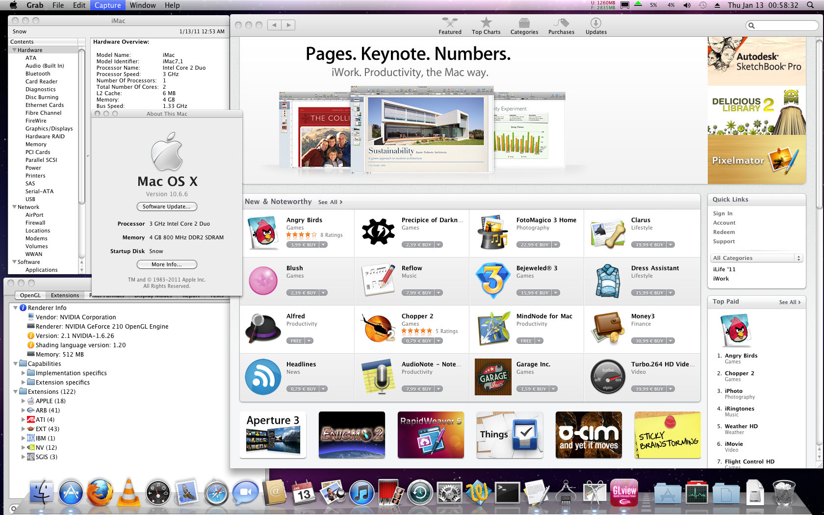

nei-k Posted January 12, 2011 Author Share Posted January 12, 2011 I replaced the HIS ATI 4350, which I did not make it work, with a Palit Geforce 210, at the same price, that works out of the box, including QE/CI. Link to comment Share on other sites More sharing options...
