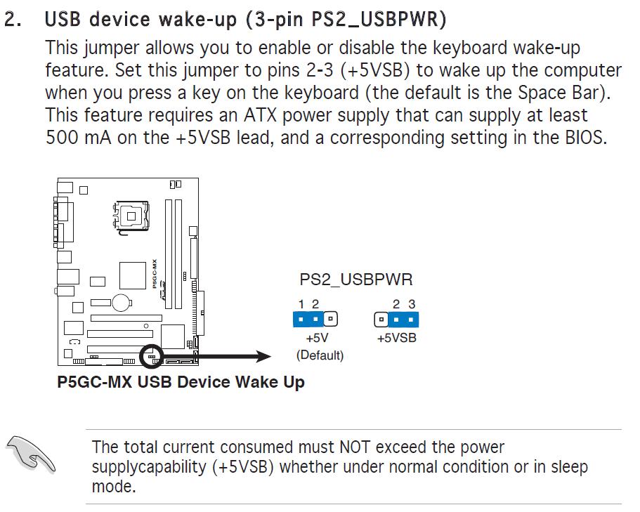

MaLd0n Posted July 25, 2011 Author Share Posted July 25, 2011 Also, I didn't tell you, but I can use my Power Button, Keyboard, and Mouse to Wake From Sleep.. But there is no Display showing.. sorry for the misconception.. in many cases the problem is video in other cases -> jump USB on the motherboard Link to comment https://www.insanelymac.com/forum/topic/235523-dsdt-auto-patcher/page/188/#findComment-1721895 Share on other sites More sharing options...
LifeOnRice Posted July 25, 2011 Share Posted July 25, 2011 in many cases the problem is videoin other cases -> jump USB on the motherboard Yup, any solutions? everything else works, just the sleep mode, though i've been using hibernation, i got tired of it and wanted to fix regular sleeping Link to comment https://www.insanelymac.com/forum/topic/235523-dsdt-auto-patcher/page/188/#findComment-1721896 Share on other sites More sharing options...
MaLd0n Posted July 25, 2011 Author Share Posted July 25, 2011 Yeaaahhh,I have no error of HPETs.I have had manually patch the DSDT.aml generate whith DSDT Editor. Now I can charge the system without NULCPUPowerManagement and I have it working with P and C States. I have no internal sound and I get errors with AppleHDA, but I do not care because I have a Logitech headset I have installed and they sound. Thanks for all your attention MaLd0n. My new DSDT.aml DSDT.aml.tora.zip the same patch look at the HPET device --> PNP0103 the old DSDT is ok too Yup, any solutions? everything else works, just the sleep mode, though i've been using hibernation, i got tired of it and wanted to fix regular sleeping Hibernation ok? menu apple? the problem is Auto Sleep? in same Asus mobos(for example) Link to comment https://www.insanelymac.com/forum/topic/235523-dsdt-auto-patcher/page/188/#findComment-1721897 Share on other sites More sharing options...
LifeOnRice Posted July 25, 2011 Share Posted July 25, 2011 the same patchlook at the HPET device --> PNP0103 the old DSDT is ok too Hibernation ok? menu apple? the problem is Auto Sleep? in same Asus mobos(for example) OOOO interesting.... but how does wake from USB revelant to display not responding (black screen on my monitor)? when i press anything on my keyboard, it wakes up but the video is not showing up. but ill try that solution Link to comment https://www.insanelymac.com/forum/topic/235523-dsdt-auto-patcher/page/188/#findComment-1721921 Share on other sites More sharing options...
MaLd0n Posted July 25, 2011 Author Share Posted July 25, 2011 OOOO interesting.... but how does wake from USB revelant to display not responding (black screen on my monitor)?when i press anything on my keyboard, it wakes up but the video is not showing up. but ill try that solution was an example your problem may be the video Link to comment https://www.insanelymac.com/forum/topic/235523-dsdt-auto-patcher/page/188/#findComment-1721925 Share on other sites More sharing options...
