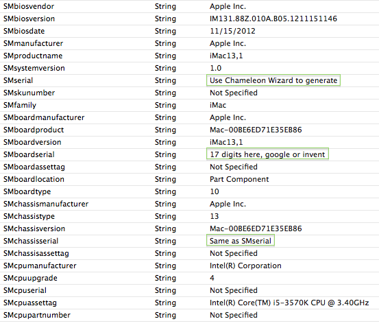

Gringo Vermelho Posted December 28, 2013 Share Posted December 28, 2013 Ok, now that this has made it into Trunk, it's time to collect some info. Here's a heads up for anyone who's as curious as I am; you can see all the new SMBIOS keys that can be injected here: http://forge.voodooprojects.org/p/chameleon/source/tree/2285//trunk/i386/libsaio/smbios.c Note that some have been renamed: SMcputype > SMoemcputype SMbusspeed > SMoemcpubusspeed I know the following links have been posted before in this thread but questions about where to get this info will pop up again eventually.. Extremely useful topic w/ various dumps from real Macs, including smbios/DMI data is here: http://www.projectosx.com/forum/index.php?showtopic=359 More over at Tea's blog, including an iMac13,1 smbios dump which I'll be examining very closely over the next hour or so: http://tdev.me/2010/12/apple-hardware-dumps/ Here I come mofos. Hmmm.. new smbios.plist done...and no luck. I thought this was a Chameleon issue but apparently the same thing happens when trying to update iLife '11 on Macs. I guess I passed the compatibility test. You know you're good when your Hackintosh has the same stupid bugs as the real thing. Notes: Download smbios reference specifications here: http://dmtf.org/standards/smbios As usual, be careful with spelling - it's assettag, not ass-e-tag, this is not "Pin the tail on the Donkey". (sorry about that, shoot me) SMchassistype values (you can check your work with dmidecode v2.11b): 1 = "Other" 2 = "Unknown" 3 = "Desktop" 4 = "Low Profile Desktop" 5 = "Pizza Box" lol how old skool is that? 6 = "Minitower" 7 = "Tower" 8 = "Portable" 9 = "Laptop" 10 = "Notebook" 11 = "Hand Held" 12 = "Docking Station" 13 = "All In One" (this is used on the iMac13,1) SMcpuupgrade set to 4 injects "ZIF Socket" - this matches iMac13,1 Bugs? I can't get Chameleon to set "Not Specified" for SMcpuserial and SMcpupartnumber (to match iMac13,1) my DMI dump and bdmesg still show "To Be Filled By O.E.M." I thought that might be because a numbers-only value is expected so I tried setting both to 0 but that didn't change anything. Neither does leaving the string blank. "Not Specified" works fine for SMboardassettag, SMskunumber and SMchassisassettag. The SMcpumanufacturer and SMcpuassettag overrides that I've set both work. Either way, all the time I've spent on this today was in vain because the App Store still won't let me update iPhoto and iMovie. FaceTime and Messages were already working. Two observations - Chamelon 2.2 svn r-2286: bdmesg needs to be updated to also show "** PRIVATE **" on the chassis serial number, because it's the same as the system serial number. There's something wrong with the memory detection... look at this funny "slot 7" (scroll down, it's at the end): SPD[0] (size): 255 @0x50 SPD[0] (size): 146 @0x51 Slot: 1 Type 24 4096MB (DDR3 SDRAM) 1867MHz Vendor=G Skill Intl PartNo=F3-2400C10-4GTX SerialNo=00000000 SPD[0] (size): 255 @0x52 SPD[0] (size): 146 @0x53 Slot: 3 Type 24 4096MB (DDR3 SDRAM) 1867MHz Vendor=G Skill Intl PartNo=F3-2400C10-4GTX SerialNo=00000000 SPD[0] (size): 255 @0x54 SPD[0] (size): 255 @0x55 SPD[0] (size): 255 @0x56 SPD[0] (size): 80 @0x57 Slot: 7 Type 2 0MB (RAM) 800MHz Vendor=NoName PartNo=P8Z77-V-PRO SerialNo=00000000 My entire motherboard gets injected as a stick of 0MB RAM into a slot that it doesn't even have. "Yo dawg, we put a motherboard in your motherboard so you can motherboard while you..." Maybe that's why my PC locks up at the Chameleon boot GUI when selecting Memory Info. Also.....a blast from the past 6 Link to comment https://www.insanelymac.com/forum/topic/231075-chameleon-24svn-official-pkg-installer/page/76/#findComment-1979712 Share on other sites More sharing options...

ErmaC Posted December 28, 2013 Author Share Posted December 28, 2013 Just a heads up for anyone who's as curious as I am; you can see all the new SMBIOS strings that can be injected here: http://forge.voodooprojects.org/p/chameleon/source/tree/2285//trunk/i386/libsaio/smbios.c Note that some have been renamed: SMcputype > SMoemcputype SMbusspeed > SMoemcpubusspeed Extremely useful topic w/ various dumps from real Macs, including smbios/DMI data is here: http://www.projectosx.com/forum/index.php?showtopic=359 More over at Tea's blog, including an iMac13,1 smbios dump which I'll be examining very closely over the next hour or so: http://tdev.me/2010/12/apple-hardware-dumps/ Thx GV I update it y-day and really no time for provide documentation about the "news".. ErmaC Link to comment https://www.insanelymac.com/forum/topic/231075-chameleon-24svn-official-pkg-installer/page/76/#findComment-1979717 Share on other sites More sharing options...

Bungo Posted December 30, 2013 Share Posted December 30, 2013 I can't get Chameleon to set "Not Specified" for SMcpuserial and SMcpupartnumber (to match iMac13,1) my DMI dump and bdmesg still show "To Be Filled By O.E.M." I thought that might be because a numbers-only value is expected so I tried setting both to 0 but that didn't change anything. Neither does leaving the string blank. Try this one. For me it sets baseboard version and chassis asset tag to Not Specified. CPU serial and part nr are Not Specified by default, so can't test. <key>SMboardversion</key> <string></string> <key>SMchassisassettag</key> <string></string> 1 Link to comment https://www.insanelymac.com/forum/topic/231075-chameleon-24svn-official-pkg-installer/page/76/#findComment-1980198 Share on other sites More sharing options...
