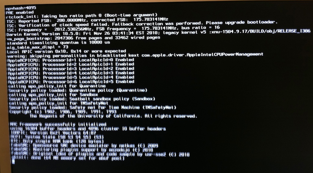

tekm Posted December 12, 2010 Share Posted December 12, 2010 I'm attempting to install 10.6.3 on my Phenom II X6 1055t computer but I'm getting the error: "Verification of clock speed failed. Fallback correction was performed. Please upgrade bootloader." I used the bootcd 1.5 along with a retail mac os 10.6.3 disc mirrored onto a flash drive. I also tried setting busratio = 14 but I still get the same error except the FSB frequency is now reported near 200 MHz instead of 175 MHz. Any suggestions? Link to comment https://www.insanelymac.com/forum/topic/227592-amd-and-retail-snow-leopard-1065-1068-finalguide/page/34/#findComment-1601190 Share on other sites More sharing options...

tekm Posted December 12, 2010 Share Posted December 12, 2010 just move mouse or remove all usb devices then connect them after pass Okay, I tried this and I'm still stuck at the screen. First I removed all usb devices, including the keyboard and mouse but left in the usb flash drive with the os x installation files. This didn't work. I then removed all usb devices including the flash drive. This also didn't do anything. I replugged everything back in at the screen moved the mouse and still nothing. Any other suggestions? Edit: So now I disabled the USB 2.0 controller, (everything is running at 1.0 speeds!), but now I think I got past the error. Thanks for pointing out that my problem is usb related. Anyway now I have a new problem where it now loads further but then the computer suddenly reboots. Ill try to look into this more. The last two messages I get before the computer automatically reboots is: "ACPI_SMC_PlatformPlugin::start - waitForService(resourceMatching(AppleIntelCPUPowerManagement) timed out" and "DSMOS has arrived" Could my new error now be due to my graphics card? I'm using a Geforce GTX 470. Edit 2: Yep it was my graphics card. I'm now using my built in motherboard ATI graphics and the OS is finally installing. Installing at USB 1.0 speeds is so slow...I really hope I can manage to get USB 2.0 working again. Link to comment https://www.insanelymac.com/forum/topic/227592-amd-and-retail-snow-leopard-1065-1068-finalguide/page/34/#findComment-1601206 Share on other sites More sharing options...

Mohamed Khairy Posted December 13, 2010 Author Share Posted December 13, 2010 @ kalmdave i uploaded to you boot file containing id of your card so replace boot file on root with this and add graphicsenabler to boot.plist Okay, I tried this and I'm still stuck at the screen. First I removed all usb devices, including the keyboard and mouse but left in the usb flash drive with the os x installation files. This didn't work. I then removed all usb devices including the flash drive. This also didn't do anything. I replugged everything back in at the screen moved the mouse and still nothing. Any other suggestions? Edit: So now I disabled the USB 2.0 controller, (everything is running at 1.0 speeds!), but now I think I got past the error. Thanks for pointing out that my problem is usb related. Anyway now I have a new problem where it now loads further but then the computer suddenly reboots. Ill try to look into this more. The last two messages I get before the computer automatically reboots is: "ACPI_SMC_PlatformPlugin::start - waitForService(resourceMatching(AppleIntelCPUPowerManagement) timed out" and "DSMOS has arrived" Could my new error now be due to my graphics card? I'm using a Geforce GTX 470. Edit 2: Yep it was my graphics card. I'm now using my built in motherboard ATI graphics and the OS is finally installing. Installing at USB 1.0 speeds is so slow...I really hope I can manage to get USB 2.0 working again. for usb try andy kext on latest update of topic hope it works for you I'm a newb at this, but I love trying out random stuff. I even made a high powered laser pointer. This is way..... way above that know how. K here goes. I partitioned 80GB of my 500GB sata drive to see if I would be capable of putting snow leopard on my AMD desktop. I have been successful at installing the software on a external USB maxtor drive then booting up from there using the BootCD1.5 from the start of this thread. I moved the image to my 80GB partition and can boot to that also using the same method. Using the disk I can now boot into either windows or snow leopard. From this point I'm a bit lost, I am unable to get it to boot to either without the disk. I tried the second link to the bootloader but it doesn't go to the AnVAL5.0.5 it went to Chameleon 2 RC5 rev. 656 I still tried to follow the instructions but it gives me a fail. I doubled clicked on it and I just installed it, but I can't tell what it done from that point either. Any tips would be great as I'm not computer savvy, I just want to be able to say I was able to do something like this and it would help build my knowledge of OS's and how they work. My system is M2N32 Mother 2 GB of Ram installed (8GB max supported) AMD Athlon 64 X2 Dual core Processor 6000+ Nividia Geforce 8800 GTS 500 GB Sata Drive 250 GB IDE Drive Mad dog DVD burner Liteon DVD Burner ATI Video input Not really worry about having everything work at once as I want to tinker with this. I plan on getting a Mac Pro or iMac after the taxes are done, and this one will set on one side of my desk. if your complain from boot from HDD you can use manual install of boot loader it is on guide ! 8400gs.zip Link to comment https://www.insanelymac.com/forum/topic/227592-amd-and-retail-snow-leopard-1065-1068-finalguide/page/34/#findComment-1601541 Share on other sites More sharing options...
