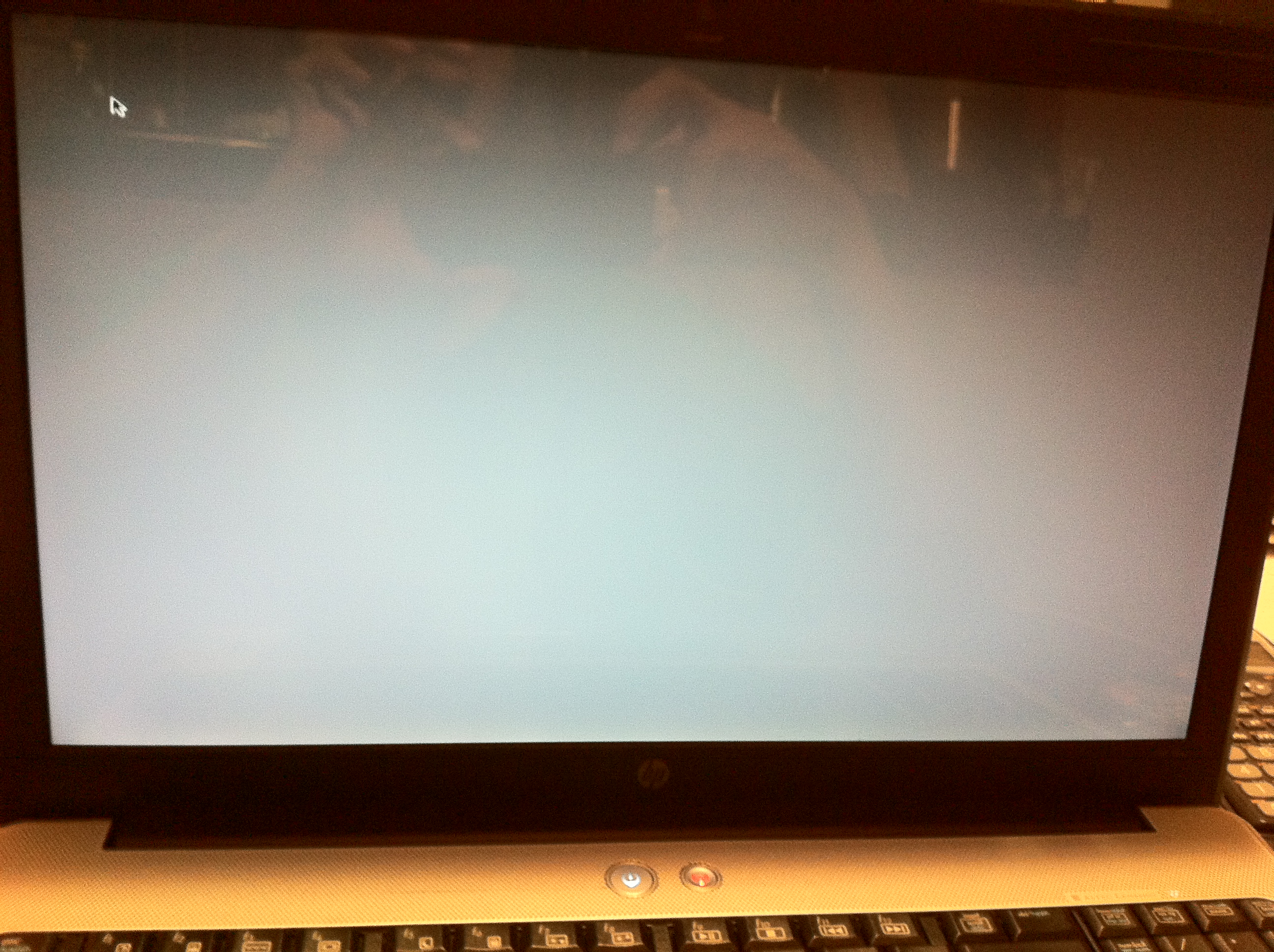

Headspin Posted November 23, 2010 Share Posted November 23, 2010 Just so u guys know... Im AMD... laptop is an HP G61... This tutorial failed me NOTHING worked. Had to do the following to get past either still waiting on root device or to get past this stupid grey screen!!! The screen was the worst... No apple logo, just plain grey. On top of that the mouse didnt work! my life... Anyway this is what I had to do to get it to boot... its not done installing still HardKnox KEXTS I downloaded all the attachments, followed the tutorial on the first page of this post, Formatted usb MBR, made a partition on my windows machine formated as MBR extended journal installed chameleon rc4 to the usb drive, restored snow leopard retail.dmg to the usb. Im dualbooting so i did the MBR thing... That didnt work so I had to download that Hardknox thing and take the osinstall.mpkg from there and also downloaded the osinstall from the link in the first post. put them in their respective folders as this guide suggests... when I boot, I get that stupid grey screen below. So i had to put the usb back in a mac, copy the kexts from hardknox kexts/snowkexts folder... into /extra/extensions... booted, got past still waiting on root device, got past the grey screen but guess what? NO MOUSE! Put the usb back in the mac, installed that ps2 fix both keyboard and mouse attached below... the mouse works but guess what? Failed to install? wtf?! Ignored it as the guys suggest... tried to continue... so I booted the usb again, select partition, it wont even let me setup now, plain black screen, no mouse, no nothing!... wtf? Right before that.. I saw something bout no dsdt or somethin :S So now what? I guess I gotta try the hd(0,3)/mach_kernel where partition 3 is my snow partition with the failed installation. Update: The hd(0,3)/mach_kernel has gotten me to grey screen with apple logo, have now gotten past that apple logo screen, only to see a screen saying "There isn't a keyboard connected to your computer. Connect your keyboard now." OMG!! Mouse wont even move either :censored2: :censored2: :censored2: :censored2: :censored2: :censored2: :censored2: :censored2: :censored2: :censored2: PS2_Fix.rar Link to comment https://www.insanelymac.com/forum/topic/227592-amd-and-retail-snow-leopard-1065-1068-finalguide/page/30/#findComment-1589708 Share on other sites More sharing options...

Headspin Posted November 25, 2010 Share Posted November 25, 2010 Well thanks for the responses and help guys got absolutely none but I shall say this: For those like myself without a stinkin USB Mouse or Keyboard: when making your retail dvd, add install ps2 fix to it and add voodookext and apcips2nubkext to extra (Found in my previous post)... when u boot, u will get a bunch of errors about voodoo being unable to load but because of that, appleps2controller will be forcefully loaded. Now u can use your mouse and trackpad to install; when rebooting (right after installing), boot the usb and open terminal type: [color="#00ff00"]cp -r /Volumes/USB/S/L/E/ApplePs2controller.kext /Volumes/HDD/S/L/E[/color] then fix permissions doing: [color="#0000ff"]chmod 755 /Volumes/HDD/S/L/E/ApplePS2controller.kext [color="#ffa500"]chown -r root:wheel /Volumes/HDD/S/L/E/ApplePs2controller.kext[/color][/color][color="#ffa500"]. [/color] Reboot. When booting up use flags [color="#9932cc"]hd(0,1)/mach_kernel -v -f [/color] Use [color="#ff0000"]-x[/color] if first boot unsuccessful. again u will get errors about the stupid voodookext but again it will forcefully cause appleps2controller to load. and u can continue installation to desktop. And then do whatever u want.. follow the tutorial from there. Explanation: USB does not copy the PS2 Kexts to the HDD(MBR Install) so you had to copy it via terminal command above. Dont know why: If I use appleps2controller alone without the voodoo and apcips2nub or whatever its called, The mouse only works for the first part of the setup, after restart, it will say please plugin keyboard and mouse/trackpad wont be working. If I use voodoo only, NOTHING works, not even the first part of the setup! When Using both, Everything works, voodoo does not get loaded but for whatever reason the ApplePs2 forcefully loads and works great! Started doing my hackintosh 2 days ago hoping that would give someone enough time to respond to help me. Guess not but I'll help future ppl who read my post hopefully. Link to comment https://www.insanelymac.com/forum/topic/227592-amd-and-retail-snow-leopard-1065-1068-finalguide/page/30/#findComment-1590928 Share on other sites More sharing options...

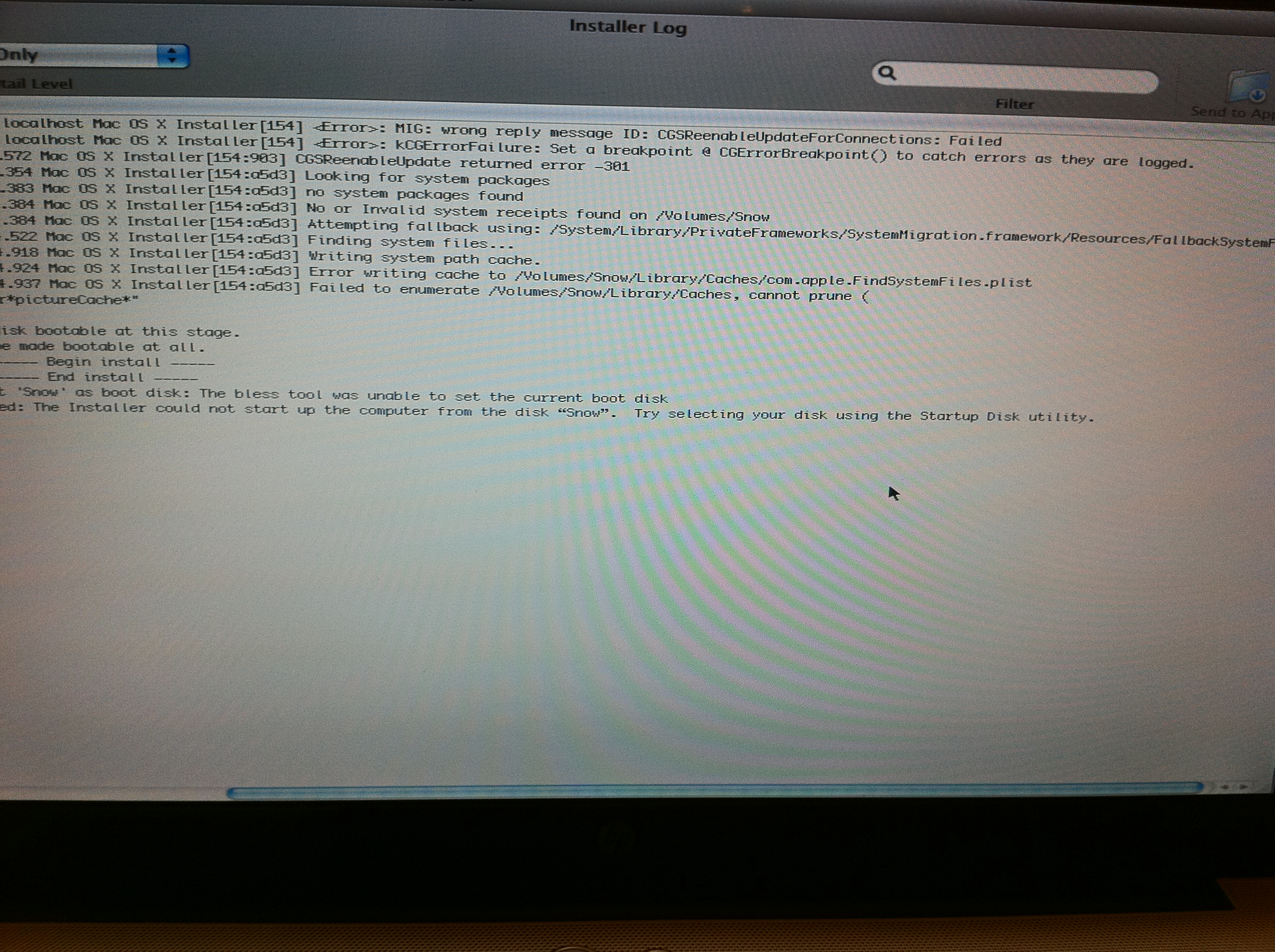

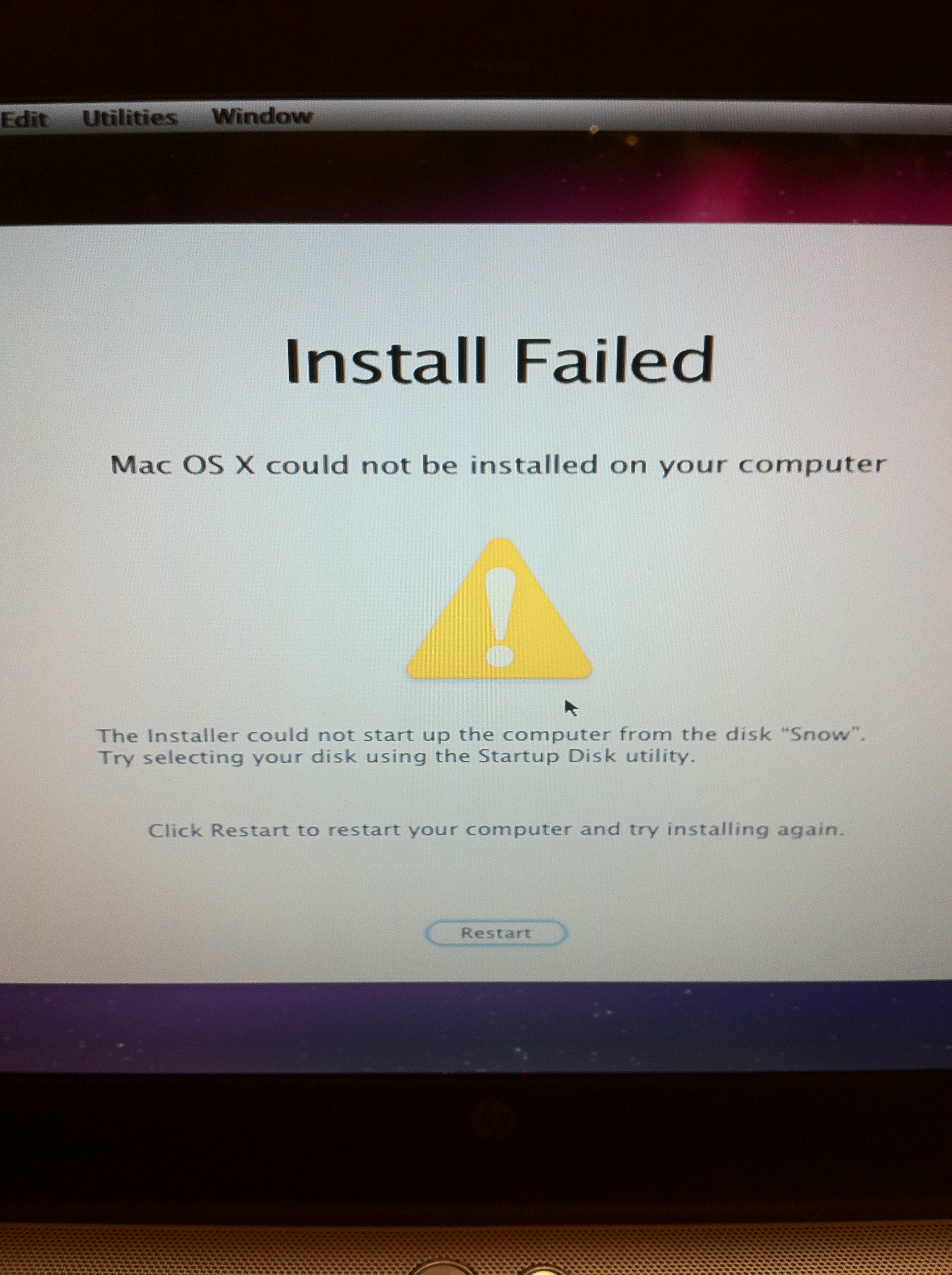

sk8md Posted November 25, 2010 Share Posted November 25, 2010 Followed directions for second method (USB stick). Had pinwheel/gray screen problem. Updated FakeSMC from newest bootcd which fixed the problem. Now the installer fails about 25% into installation. Are there supposed to be kext options in the "customize" section of the installer... cuz I don't have any Any ideas? Thanks in advance Link to comment https://www.insanelymac.com/forum/topic/227592-amd-and-retail-snow-leopard-1065-1068-finalguide/page/30/#findComment-1590946 Share on other sites More sharing options...

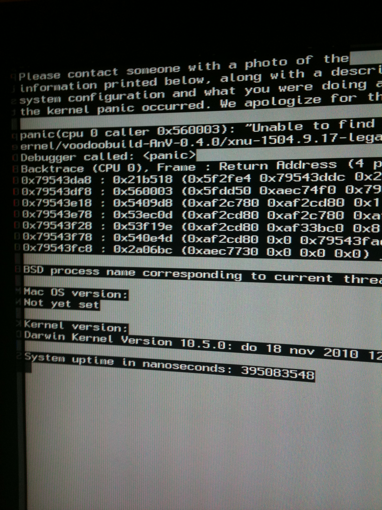

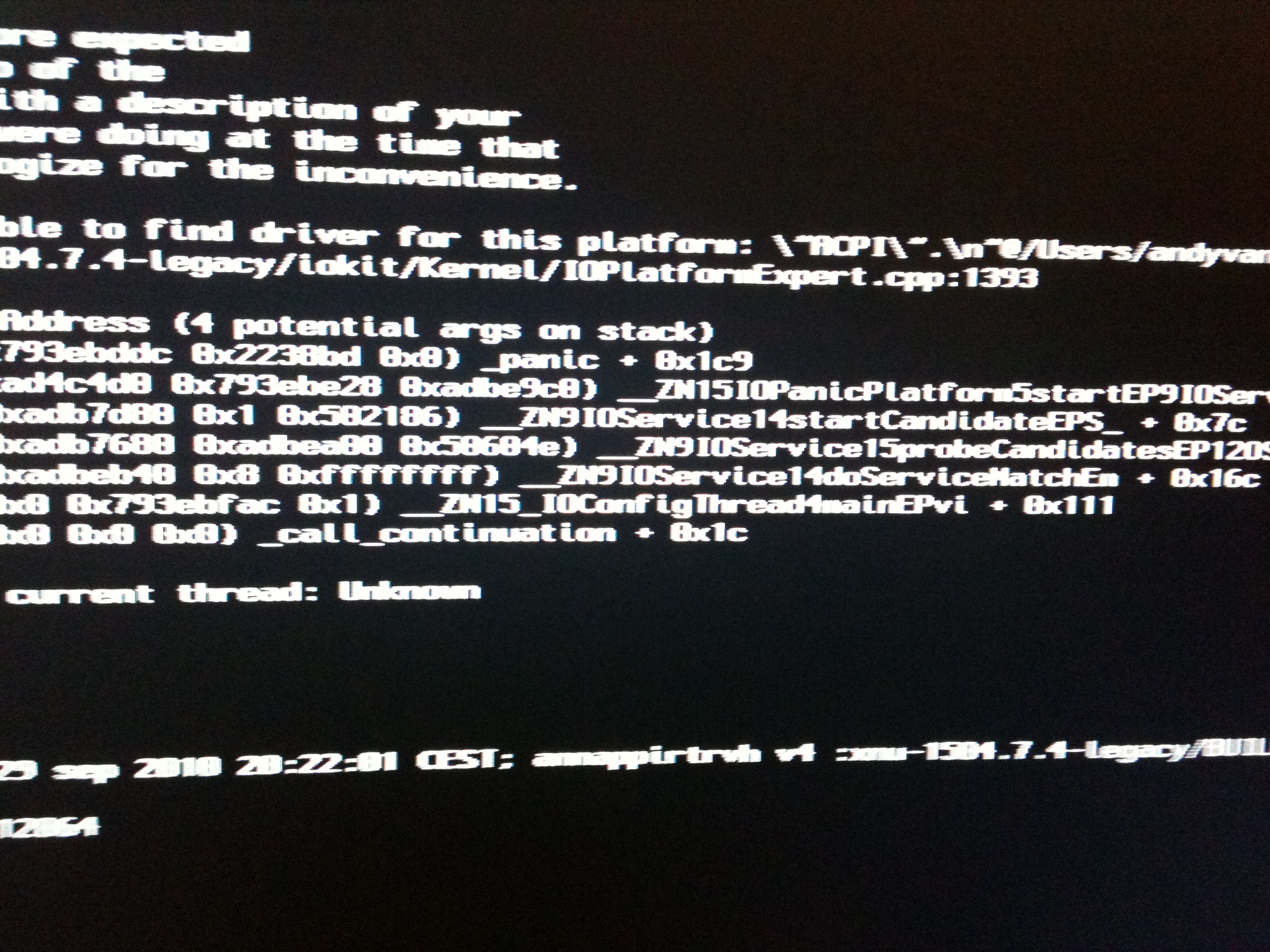

nonconformistconformist Posted November 26, 2010 Share Posted November 26, 2010 I think I can get 10.6.3 on my machine but I get a KP all the time. Here are screen shots. System Specs: AMD 9950 BE Quad Core 2.8GHZ Gigabyte GA-750X-UD4P Corsair DDR2 800 8 Gigs 9800GTX 512 PCIE video Sata DVD Sata HD's In AHCI...DVD wont boot. Link to comment https://www.insanelymac.com/forum/topic/227592-amd-and-retail-snow-leopard-1065-1068-finalguide/page/30/#findComment-1591493 Share on other sites More sharing options...

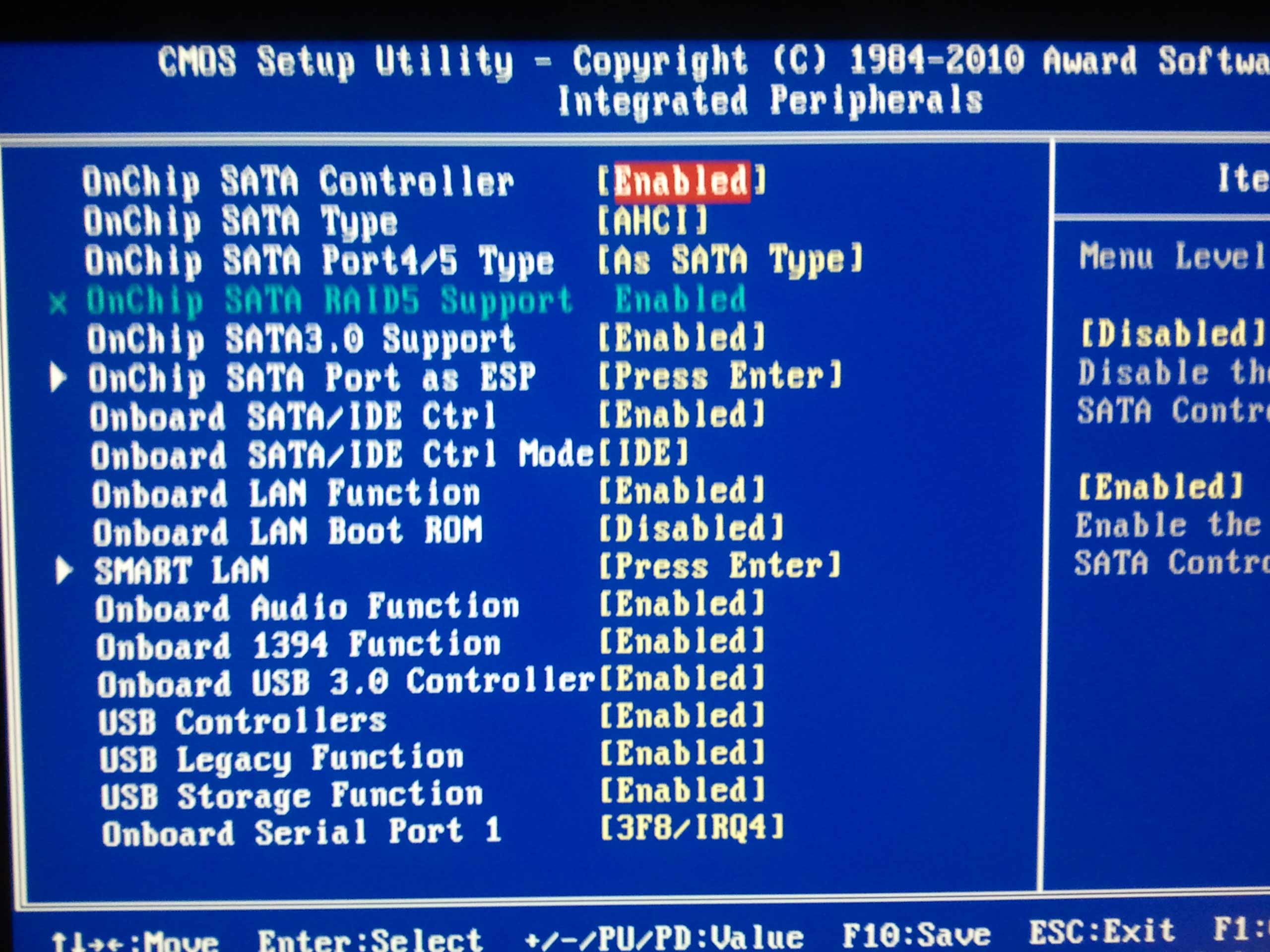

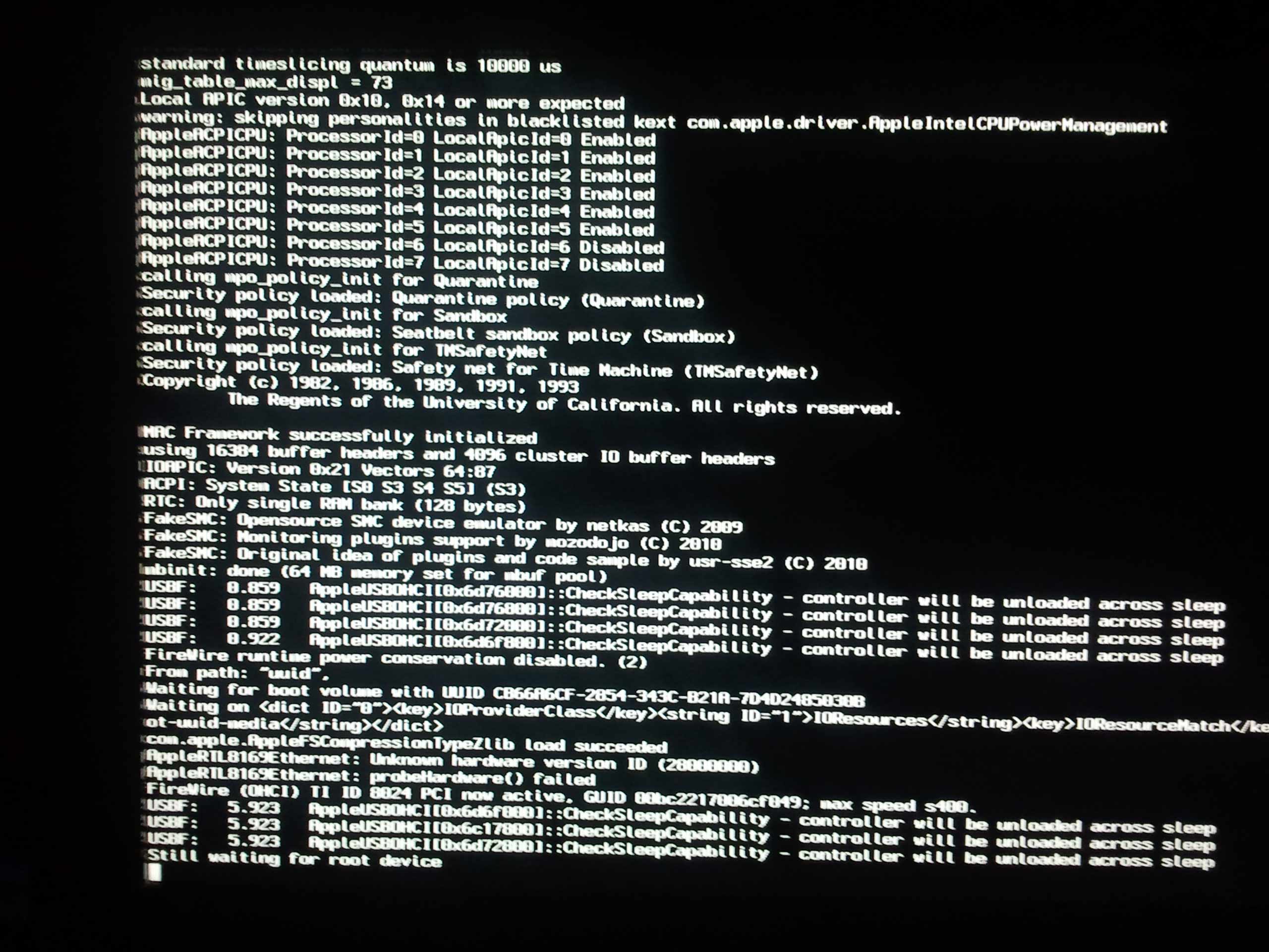

swifty112 Posted November 27, 2010 Share Posted November 27, 2010 Hi, my Setup: Amd X6 1055 gigabyte ud3-H 880 4gb 1tb hd I followed your Instruction but it didn`t load the setup. 1. I boot from the boot cd and to the cameleon . 2. I put the Snow Leopard Dvd in 3. Many Letters came 4. Nothing happens Do I need to partition the hd in Win ? What can I do ?? Link to comment https://www.insanelymac.com/forum/topic/227592-amd-and-retail-snow-leopard-1065-1068-finalguide/page/30/#findComment-1592338 Share on other sites More sharing options...
Mohamed Khairy Posted November 27, 2010 Author Share Posted November 27, 2010 Hi, my Setup: Amd X6 1055 gigabyte ud3-H 880 4gb 1tb hd I followed your Instruction but it didn`t load the setup. 1. I boot from the boot cd and to the cameleon . 2. I put the Snow Leopard Dvd in 3. Many Letters came 4. Nothing happens Do I need to partition the hd in Win ? What can I do ?? picture it when it stop setup latest bootloader Chameleon_2.0_RC5_INSTALLER_r643 no boot MB:M2N-E CPU Athlon 7750 BE VGA Nvidia 8500 GT thank you on topic there are how to setup it manual !!!!!!!!!!!!!!!!!!!!!!! Link to comment https://www.insanelymac.com/forum/topic/227592-amd-and-retail-snow-leopard-1065-1068-finalguide/page/30/#findComment-1592348 Share on other sites More sharing options...
swifty112 Posted November 27, 2010 Share Posted November 27, 2010 Here are the pictures. Link to comment https://www.insanelymac.com/forum/topic/227592-amd-and-retail-snow-leopard-1065-1068-finalguide/page/30/#findComment-1592368 Share on other sites More sharing options...
Mohamed Khairy Posted November 27, 2010 Author Share Posted November 27, 2010 Here are the pictures. use ide mode Link to comment https://www.insanelymac.com/forum/topic/227592-amd-and-retail-snow-leopard-1065-1068-finalguide/page/30/#findComment-1592374 Share on other sites More sharing options...
swifty112 Posted November 27, 2010 Share Posted November 27, 2010 The Sata Type ? Link to comment https://www.insanelymac.com/forum/topic/227592-amd-and-retail-snow-leopard-1065-1068-finalguide/page/30/#findComment-1592375 Share on other sites More sharing options...
Mohamed Khairy Posted November 27, 2010 Author Share Posted November 27, 2010 The Sata Type ? sure Link to comment https://www.insanelymac.com/forum/topic/227592-amd-and-retail-snow-leopard-1065-1068-finalguide/page/30/#findComment-1592378 Share on other sites More sharing options...
swifty112 Posted November 27, 2010 Share Posted November 27, 2010 Hm, it doesnt work. It still comes Waiting for Root Device Link to comment https://www.insanelymac.com/forum/topic/227592-amd-and-retail-snow-leopard-1065-1068-finalguide/page/30/#findComment-1592400 Share on other sites More sharing options...
