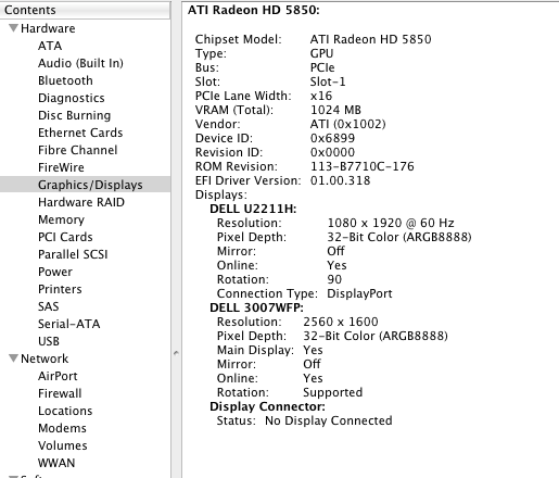

BobSmith Posted September 23, 2010 Share Posted September 23, 2010 I've got a 5850 and it works well with the DVI and DisplayPort connectors, but I can't get the HDMI connector to work. I have tried both an HDMI to DisplayPort adapter and an HDMI to DVI adapter, as well as just a straight HDMI connection. It always mirrors the DVI port, and I can't seem to do anything to fix it. I made the changes mentioned in the ATY_Init.kext, but that didn't seem to help. System Profiler shows 3 display connectors, but one always says "No Display Connected". Any ideas would be appreciated, thanks. Link to comment https://www.insanelymac.com/forum/topic/227308-triple-monitors-with-ati-radion-5000-5xxx/page/2/#findComment-1553362 Share on other sites More sharing options...
