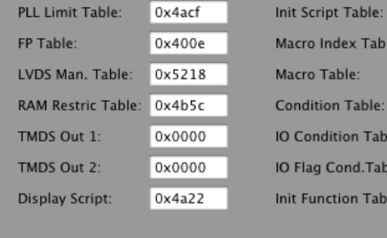

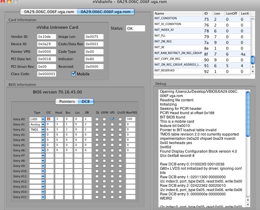

But I didn't get it to find the DCB table until now. Can somebody help me and show me my misakes here? At offset 0x36 there is a 0x0D value and afterwards text starts. Bios attached below. I will dump it again with nvidiainfo.
0A29.006C.006F.vga.rom.tar.gz
Edit: Results displayed by nvidiainfo:
Edit: From the manual posted above I get these display_cfg and nvcap values:
uint8_t display_cfg_0[]= {0x03, 0x00, 0x0F, 0x00};
uint8_t display_cfg_1[]= {0xff, 0xff, 0x06, 0x01};
static uint8_t default_NVCAP[]= {
0x04, 0x00, 0x00, 0x00, 0x00, 0x00, 0x01, 0x00,
0x06, 0x00, 0x00, 0x00, 0x00, 0x00, 0x00, 0x07,
Does it look correct to you? Do I have to byteswap word areas in NVCAP? Maybe our problem is that the bios has LVDS as first entry, but the macbook analog as first entry...?
Yes, it does look correct on NVCAP part. I'm not sure for display-cfg though but it looks correct based on the guide. I don't have enough hardware to test the display-cfg properties. On my Acer Aspire 9420, I don't need to set the display-cfg. It will automatically detected "ff ff 02 00" for primary display/connector & "ff ff 00 01" for secondary display/connector (on older Snow Leopard or Leopard, I got "ff ff ff ff" & "ff ff 00 00" if I'm not mistaken). If I set display-cfg according to VBIOS, I only get blank screen. However, I have read a lot of post mentioning the important of display-cfg where if it didn't specified, the display won't work correctly. Maybe mine is special case. Lack of hardware prevent me from testing any further.
I don't think the different on the arrangement of the LVDS, Analog, TMDS, etc is the cause of the problem since we can control the display output with NVCAP. At my post #19, you can see where you set primary display (output 1), secondary display (output 2) & TV (S-VIDEO I think) (output 3). My Acer Aspire 9420 also have LVDS at first entry & it works.
