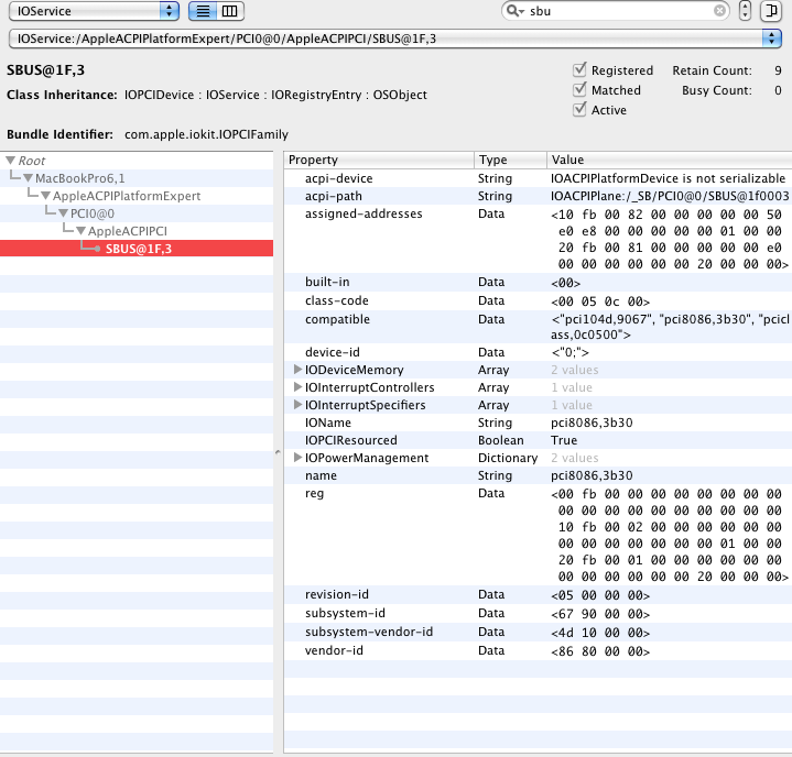

Well, I'm not sure but I2C is related to SMBUS controller. Can you check whether SMBUS kexts is loaded or not on your Sony? They should be three kexts loaded.
Is it possible to disable nvhal50.kext only for the internal display by making a disabler-kext? Then you could use the internal screen without and the external with maybe...
Someone can give me infos how to build a disabler kext for display-A?
Coming to CPU POwermanagement: I am using Chameleon rc5 recent build, enabled P-States by adding "UsePStates=yes" and removed NullCPUPowerManagement.
Now the Vaio always runs in turbo mode. Is there a DSDT patch or information available how to set better speed steppings?
IOSMBusFamily is the only kext that is loaded...
I know it is a long shot but can you patch your SMBUS in DSDT? Replace the SBUS entry in DSDT with this. This is taken from my notebook DSDT:-

                   Name (_CID, "diagsvault")
                       Store (Package (0x03)
                           "address",
                           0x57,
                           Buffer (One)
                               Zero
                       }, Local0)
                       Return (Local0)
       // end - SBUS

Try it. It should load 3 SMBUS kexts now.
It is unclear whether SMBUS (SBUS) is related to VAIO display issue or not but at least this fix kinda necessary since OSX did use SMBUS on real MacBook. If you googled there are several website discuss the SMBUS/i2c relationship with LCD display. This is one example I found: SMBus/I2C Controlled WLED Driver for Medium Sized LCD Backlight. However, I might misunderstood it since the document I found is a bit too technical for me. Even if it doesn't help with the display problem but at least we already applied the fix.
LOL, I forgot to inject device-id for the SBUS device. Fixed. Check previous post. :rolleyes:

With your DSDT.aml inside Extra folder there are now 3 kexts related to this loaded: AppleSMBusController, AppleSMBusPCI and IOSMBusFamiliy. Here is a shot of ioreg, don't know if it can help you.
Could you explain to me in short what the smbus is good for? In the imac71.dsl there is specific activation of the sbus device if the os (var osys) matches "Darwin"...
Edit: I see you already implemented that. Maybe Darwin should better behave like "Linux"?
On non-apple notebook, at least:-
(source)
The System Management Bus (abbreviated to SMBus or SMB) is a single-ended simple two-wire bus for the purpose of lightweight communication. Most commonly it is found in computer motherboards for communication with the power source for ON/OFF instructions. It is derived from I²C for communication with low-bandwidth devices on a motherboard, especially power related chips such as a laptop's rechargeable battery subsystem (see Smart Battery Data). Other devices might include temperature, fan or voltage sensors, lid switches and clock chips. PCI add-in cards may connect to a SMBus segment.
On MacBook, SMBUS is use for Mikey device & smart battery. Non-apple notebook use control method battery which is completely different than smart battery.
